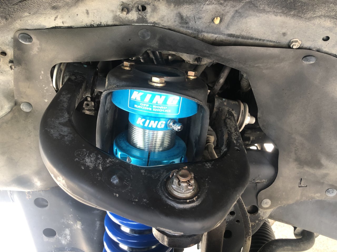

    I just installed the 2.5 oem performance King coilovers on my 97 yesterday afternoon and like 2 hours after, I noticed grease all over the place on the passenger side. And after cleaning up a bit I saw the spot where the cv axle boot ripped. My question is, are the angles on my cv axle that bad that it caused that or are the boots just so old and weathered. Anyways what I’m trying to figure out is should I go to my nearby oreillys, Napa, AAP and get a replacement there or are the angles bad enough that I should go with the CVJ axles?
    And here’s one of my driver side
    To me the angles don’t look too bad but idk, and I would think they would’ve ripped at a different spot if it was the angle.

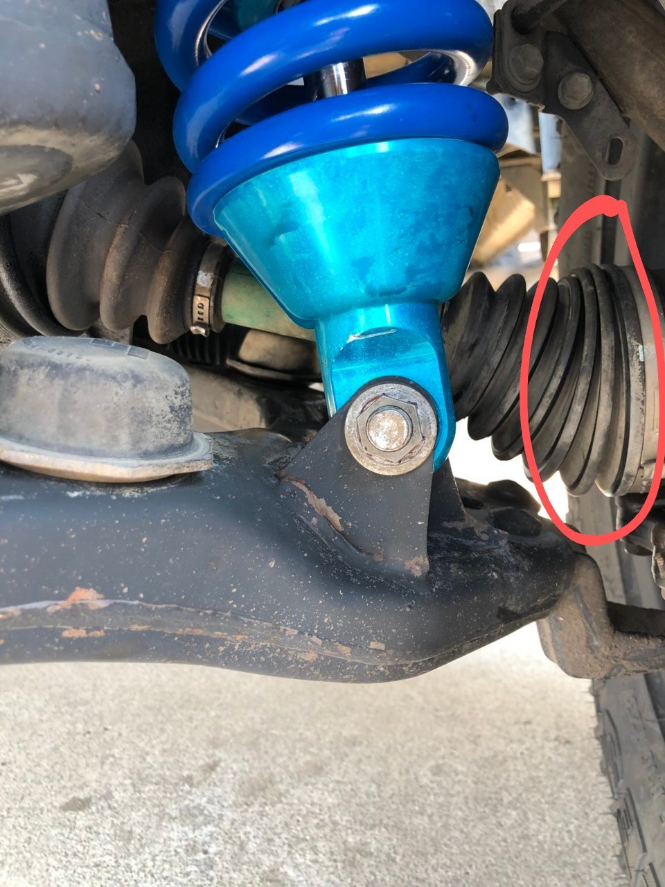

    Those outer boot fins are rubbing, angles are too severe. I have the same Kings and initially had mine at 2.5" of lift but kept blowing boots as well. Diff drop did nothing and was a waste of money. Best thing you can do is lower the lift bit by bit until the boots don't rub anymore.
    You should be able to slide a piece of paper between each of the boot fins, if you can't then they are touching and will rub apart in no time.
  9. Aug 23, 2020 at 2:26 PM
    eon_blue
    Mar 4, 2016
    #180213
    69,400
    Azusa, CA
    These are pushed against each other and will rub apart, guaranteed

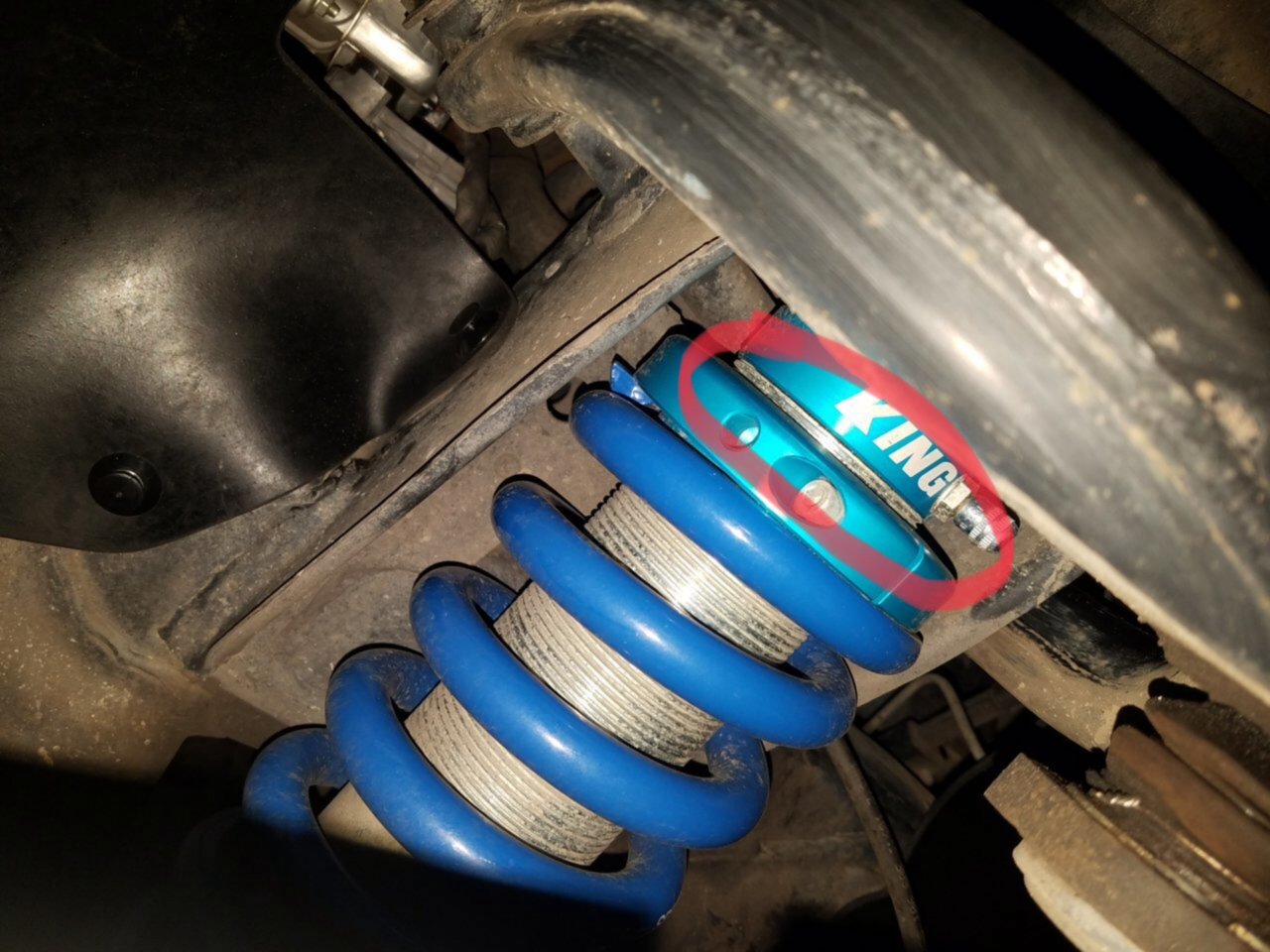

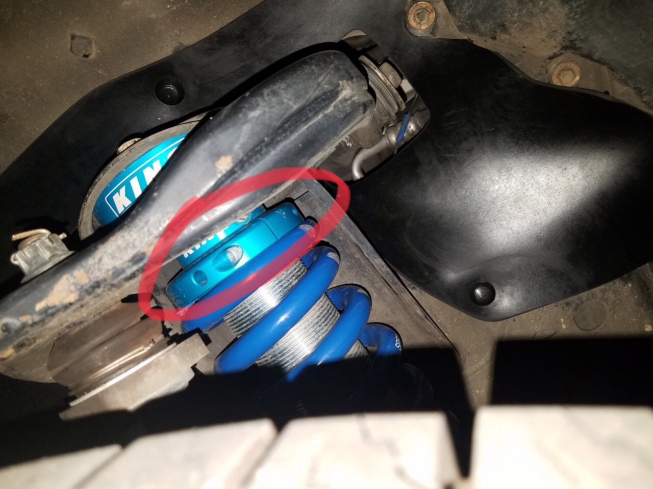

    My truck did not come with a lift, but the Kings creates a lift of 2” for me,
    My boots have a small angle as shown and do hit at the top worn spot on the spring.

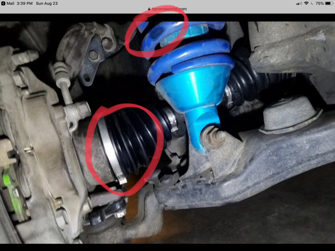

    Here’s mine at 2.5. I don’t think they are too bad but not great any more angle and ide probably lower or install my diff drop. Yours are definitely going to wear out

    Probably created lift anyway cause of the 600# springs, but the boots rub the spring itself? That's odd I don't think I had that issue. I do have the somewhat common issue where the banjo bolt on the caliper grazes the lower part of the coilover. Only at full lock then stuffed, but one time it actually loosened the banjo bolt and I lost some brake fluid.
