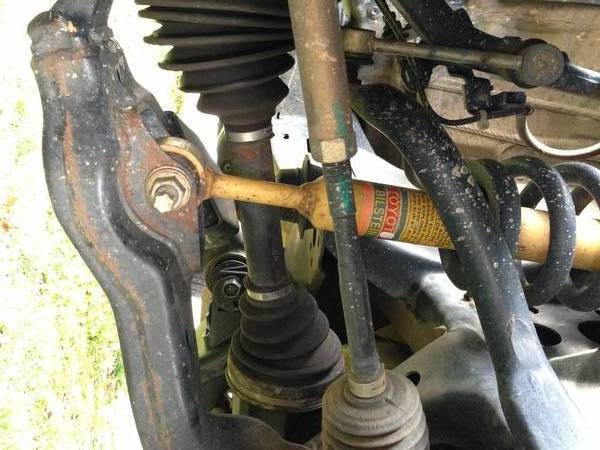

    thats sounds stupid...do the fins touch at ride height?

    Cv axle goes into front differential FYI. Check if fins touch. Take it to a different mechanic

    Well here is how it sits ride height

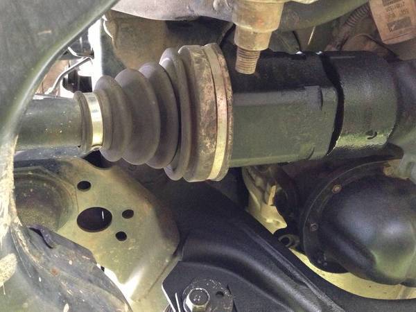

    Here is the drip, it doesn't drip enough to leave a puddle but it has this drip every day, every time I look at it. Also when I reverse and turn at the same time it binds up, makes a god awful noise. That only started after this last time he looked at it and decided that I need a longer axle :confused:

    WELL IT LOOKS AS IF ITS NOT YOUR BOOT THATS LEAKING SEAMS TO BE THE SEAL ON YOUR DIFF THATS LEAKING
    YOUR MECHANIC NEEDS A SLAP
    TAKE IT SOMEWHERE ELSE
    AND GET A TOYO CV OR A CVJ CV

    The first 3 axles were the ones that the boots ripped on not this one. The leak began during the third axle and has continued. The mechanics explanation is that the seal must have broke from being changed so many times. The only reason I have gone back is one he has been doing it all for free after the first one went bad. He thinks he has a fix for it and he is an old guy, family friend, it's a small town I'm gonna try and let him get his satisfaction. However this will be the last time I visit him. The stealership wants right under 500 bucks to put a new axle assembly in which is why I have stuck with my mechanic. I've watched him do it enough times I could do it myself just don't know where to buy the exact part I need at the best price, no way an axle assembly should cost more then a couple hundred bucks!? :confused:

    About the binding noise when I turn sharp while backing up I'm assuming that's because of the lack of gear oil in the font dif because of the leak?
