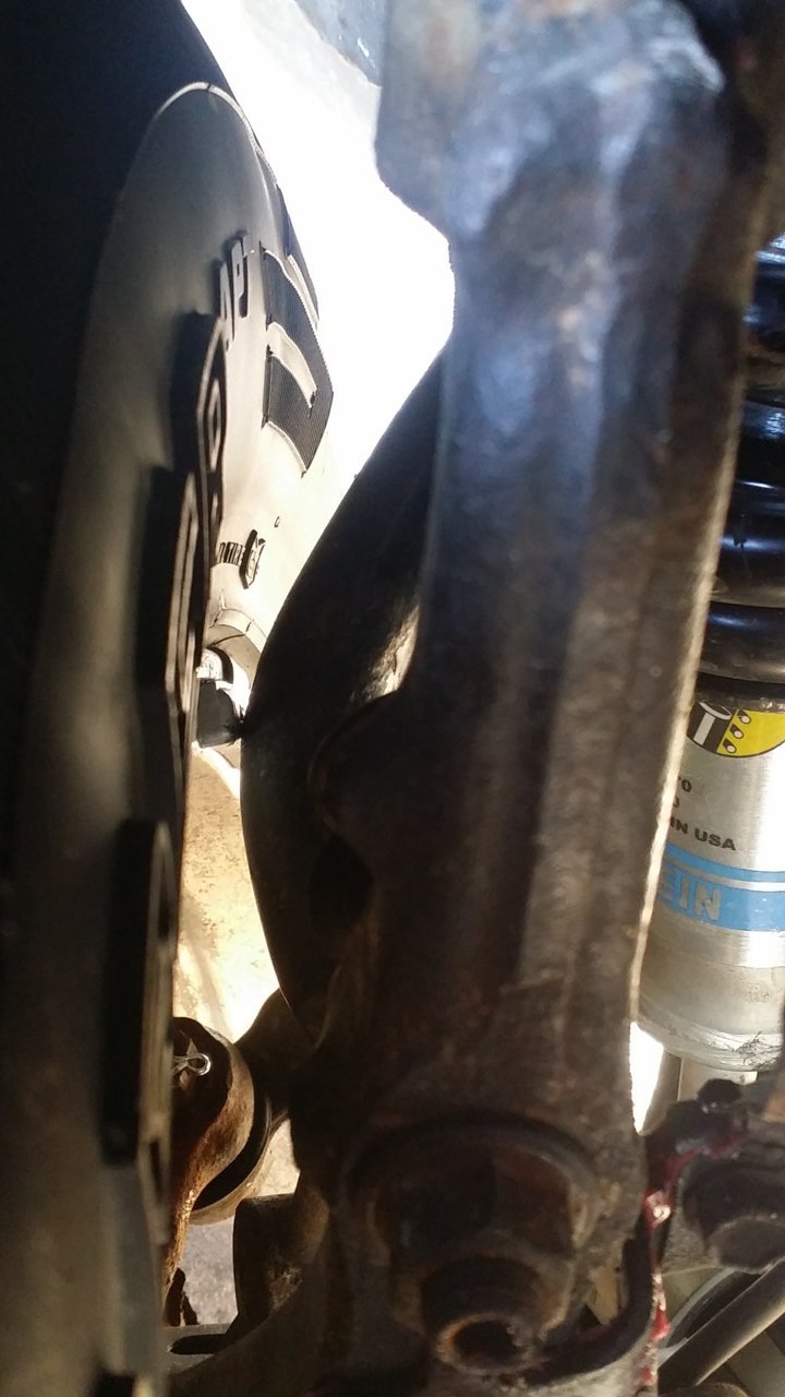

    So it ended up being the wheel weights hitting the sway bar at full lock. Which is strange, because I have a sway bar relocation kit installed. I removed the sway bar and took it for a ride. Not a fan, way too much body roll for my liking. I drive a lot on the highway with my kids. I guess I'll reinstall it and put stick on weights on the wheels or get a set of wheels with an offset.

    Good job tracking this down.
