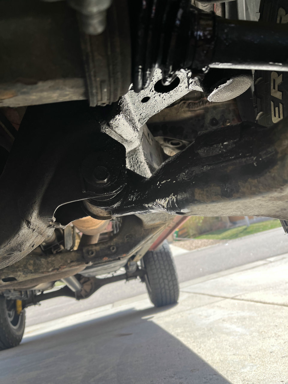

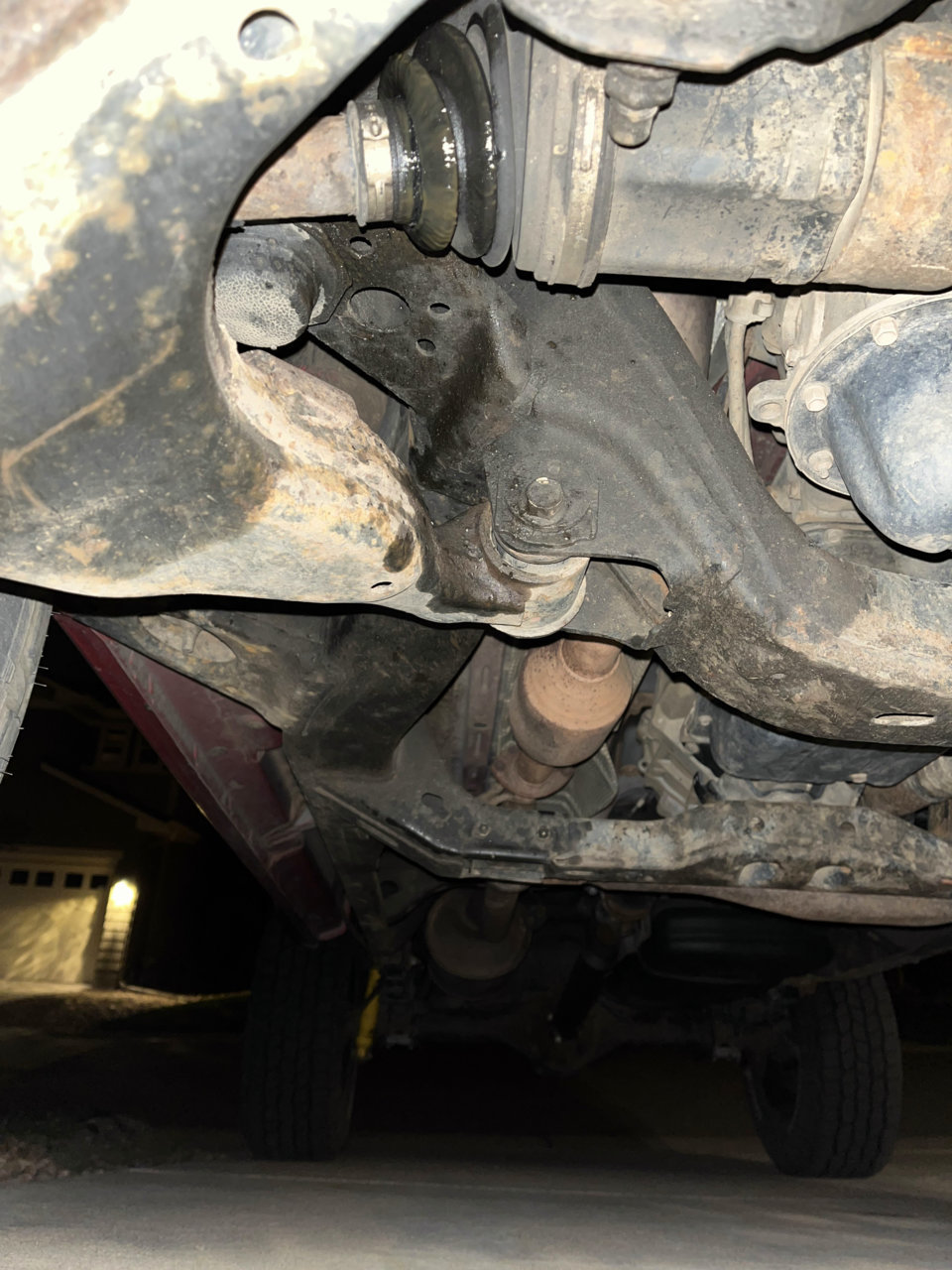

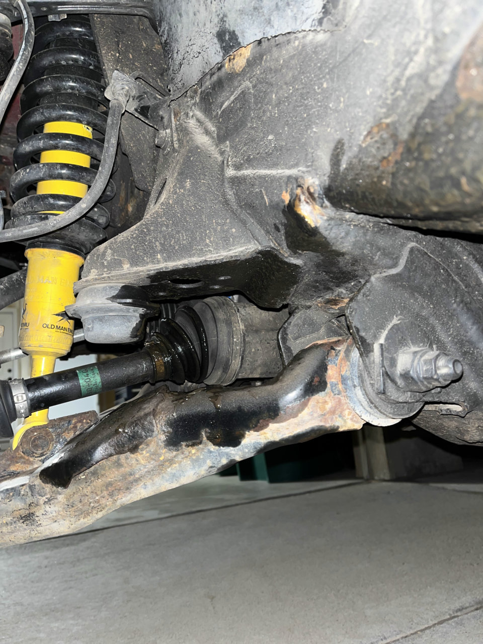

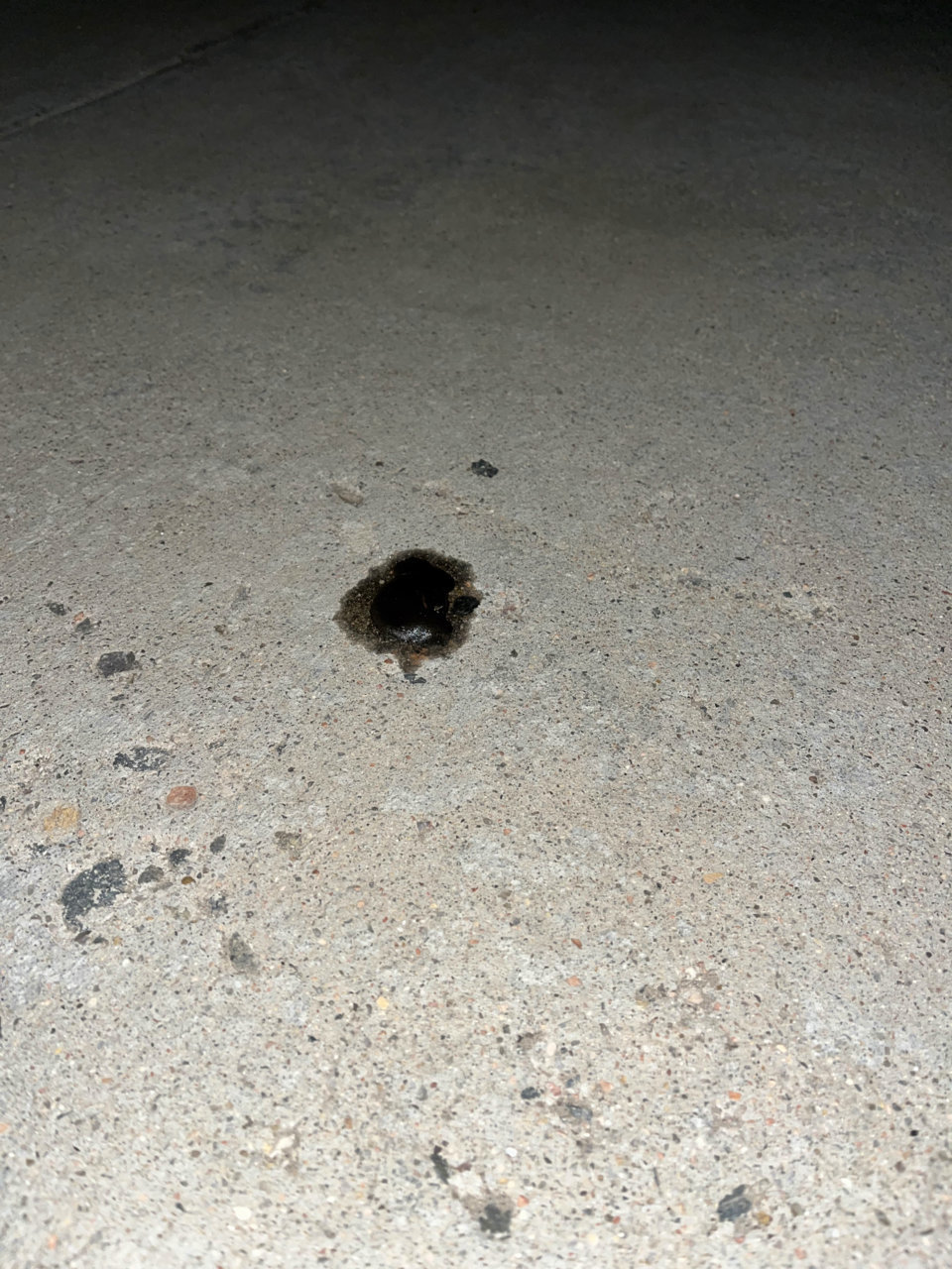

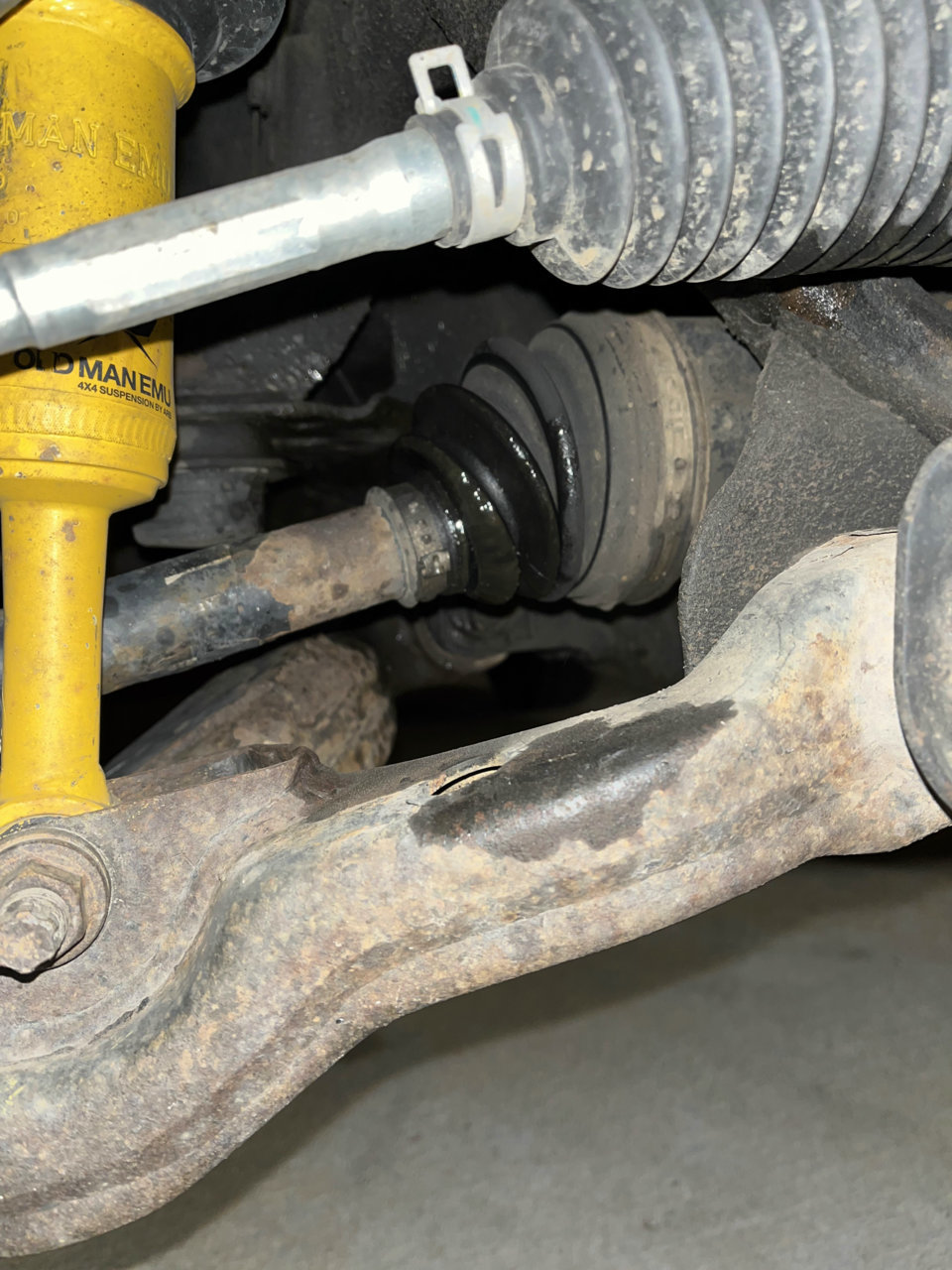

    I unexpectedly noticed a spot of something underneath my truck today. Upon further inspection, I noticed the boots on my CV Axel were very leaking. It looks like I need to change my CV Axels - just wanted to confirm this on here first before I ordered parts. This was on both sides of the truck. Let me know what you think - all opinions are greatly appreciated.

    Curious…what exactly would be leaking from the boot that would be so runny?
    If it was just a torn/damaged boot wouldn’t the worse case be thick grease leaking out? I’m wondering if it’s more likely the axle seals.

    Wouldn't it smell like diff fluid then? It looks like the grease in the first couple pics, maybe he attempted to wipe it up or something.

    The OP doesn’t say anything about how anything smells…
    If it was grease I don’t think the entire boot and surrounding area would be wet.

    Boot rips water gets in and the grease is a runny mess.

    Let me give it another sniff but it didn't really have the nasty diff fluid smell. It kinda looks more like grease. I did hit my upper control arms with a good bit of moly grease but there is no sign of leakage.

    The fluid has to be coming from the boot in my opinion I'm not sure where else it could come from to land exactly and perfectly on my axel boot.
