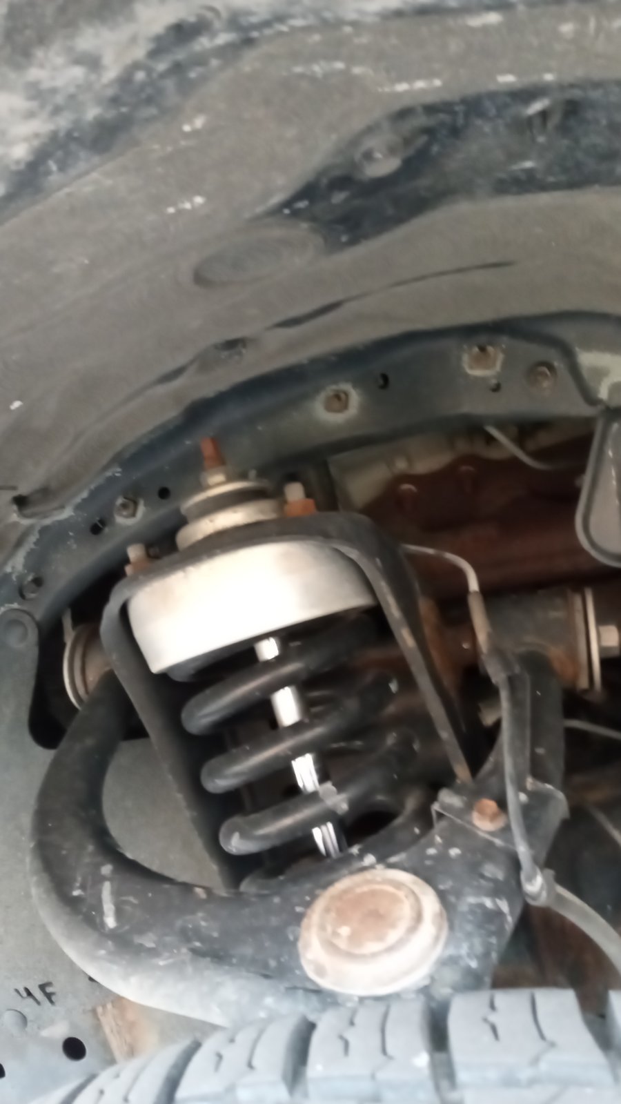

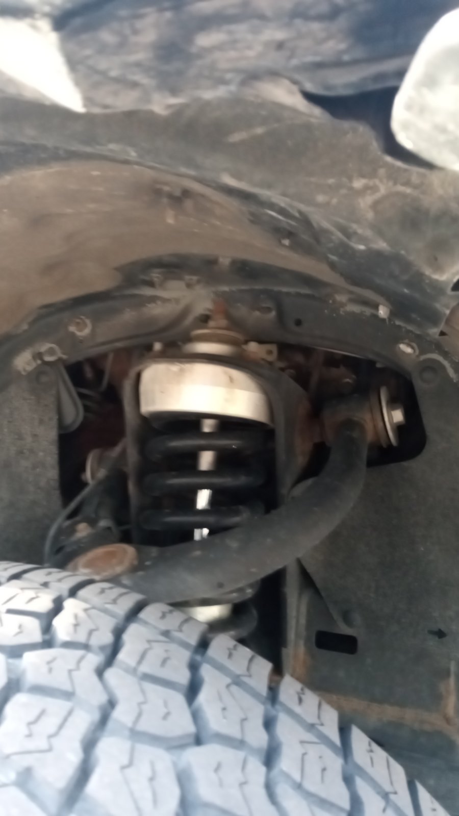

    17087274112692256508894398432559.jpg 17087274112692256508894398432559.jpg I don't know if these pictures help or not.

    A more zoomed out one showing the coilover and what’s on top of it, if anything. I don’t see a drop bracket so you may just have way too much lift, which is why your boots are tearing so often.

    You’re good man, we all start somewhere. You don’t have a drop bracket lift, you just have too much “normal” lift. Your CV’s, control arms, tie rods, etc are at too steep of an angle and that’s why you’re blowing through boots. Basically, you need to lower your front lift a little bit.

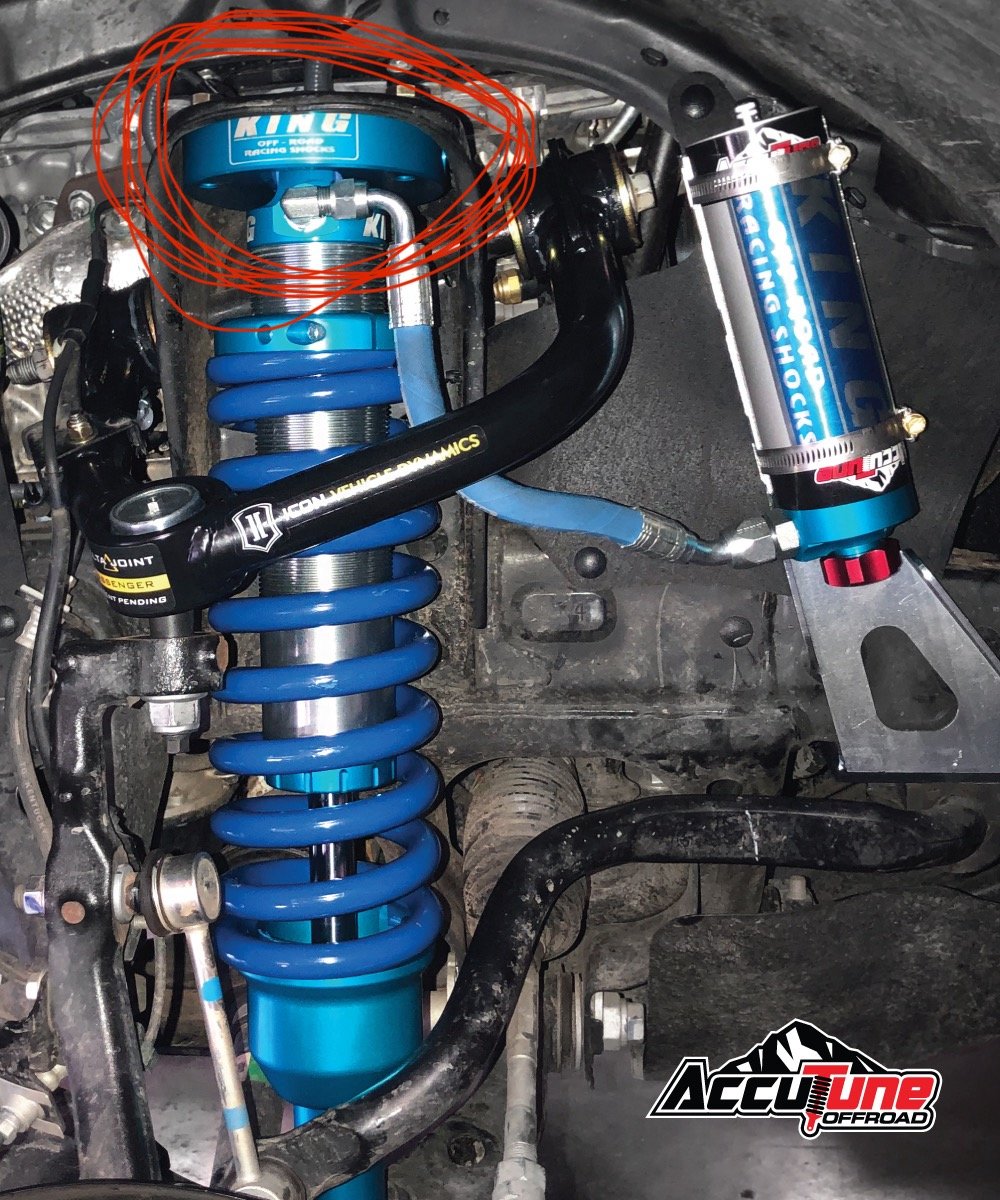

    I want to see a picture of the top of the coilover to see if you have a spacer. If so, it will be easy to just remove it which would lower your lift a little. Or, your coilovers are adjustable. You need to disassemble the coil from the shock and lower the bottom perch mount, but it is doable.
    All of this is kind of a pain in the ass but it’s the root of your problem.

    Those are Bilsteins 5100s or 6112s. Get rid of any top strut spacer in there and adjust only the spring seat on the shock for height. You'll be good.

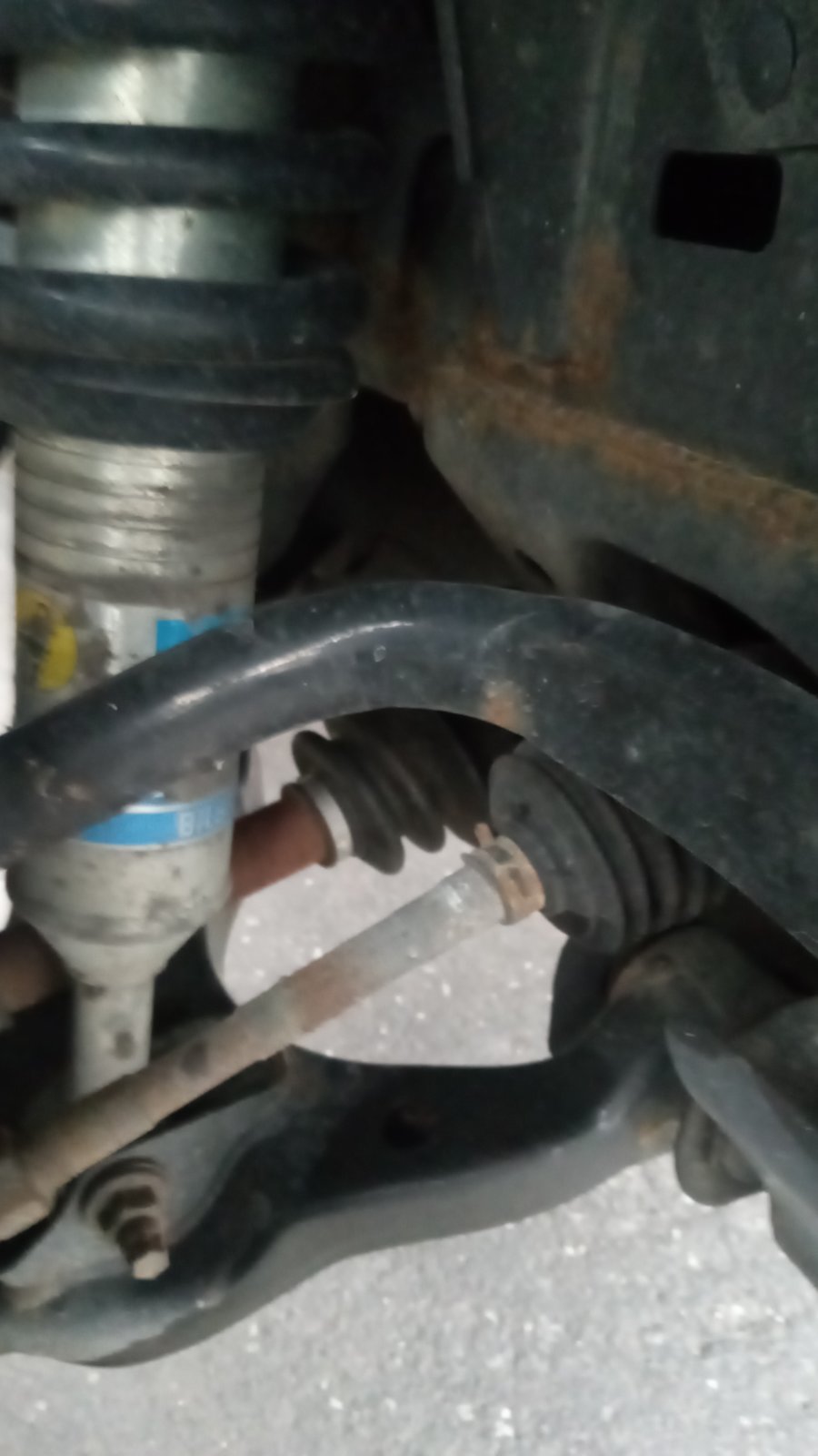

    I don't see a spacer but I don't directly know what I'm looking for either.17089009619053222017971600001353.jpg

    Also, perhaps too long a spring was installed. In any case, both need to come out as soon as possible and drop it to 3" lift at maximum.
