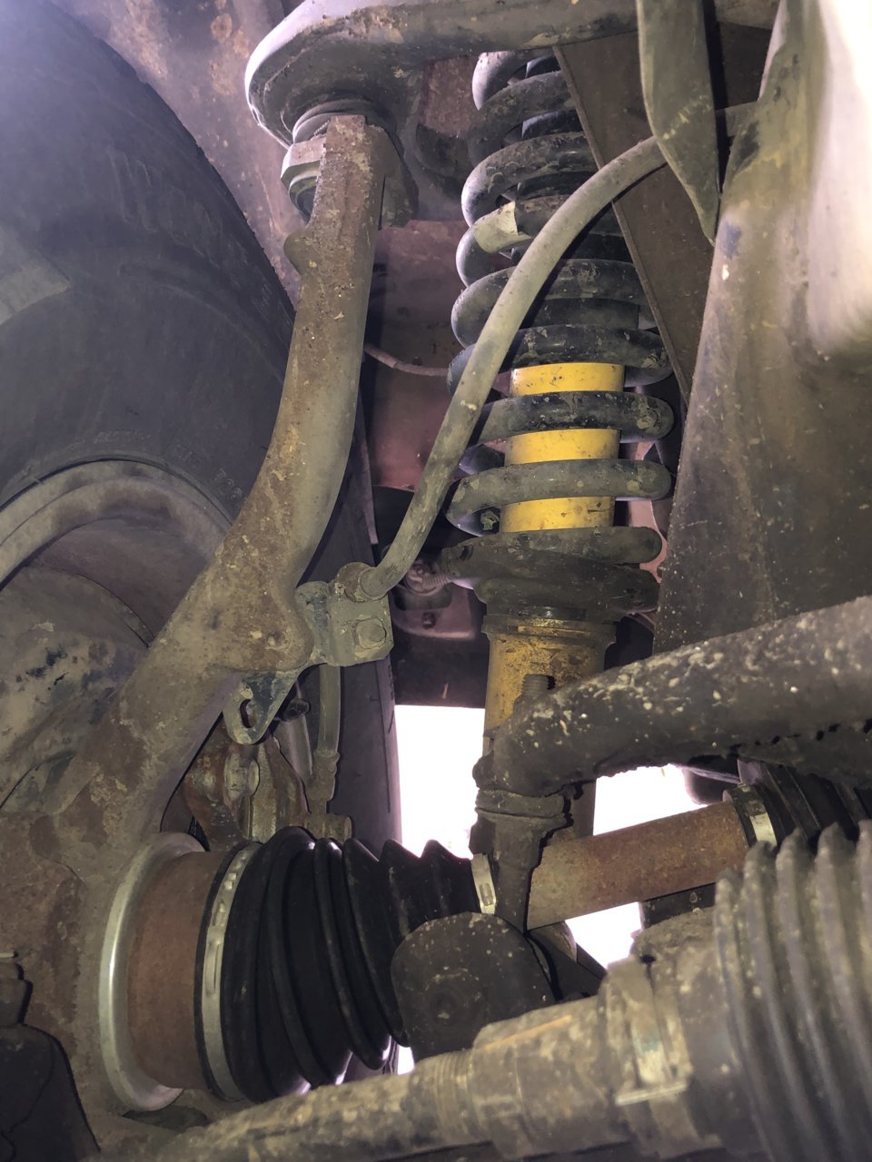

    When I purchased my 98 3.4l Taco back in April, I noticed one of the CV boots was torn. Went ahead and replaced both axels. Fast forward to last weekend, and one is torn again and now making some wild noises. I understand the 3” Lift that came with the truck can cause an extreme angle on the CV’s and will cause premature wear. My question…
    Would adding body armor (tube front bumper and winch) to the front of my vehicle make the wear and tear on the IFS less premature? Wondering if the weight would help or if it could cause more damage? Any help and advice is greatly appreciated. Cheers!

    Adding weight should lower the front, so it will help your CV angles...
    But the best solution would probably be less lift. You could also install a diff drop kit, which may or may not work with whatever skid you're using. High angle CV boots could help.

    Did you...completely skip the information I shared with you (and others as well) in your first thread?
    You have too much lift; your cv axles are maxed out, as well as your boots.
    You will tear boots even with OEM cv axles (which are far better).
    Identify your complete suspension, and look to replace/remove whatever needs to be done to lower your height.
    Yes adding weight will lower your vehicle, but how long until you actually do that?
    Why not look at the coils you're running now and utilize tbe appropriate coil? Lessen preload (if you're running adjustable coilovers), and/or remove spacers if you have one in play.
    You receive sound advice, ignore it and start another thread. We're only trying to help you.

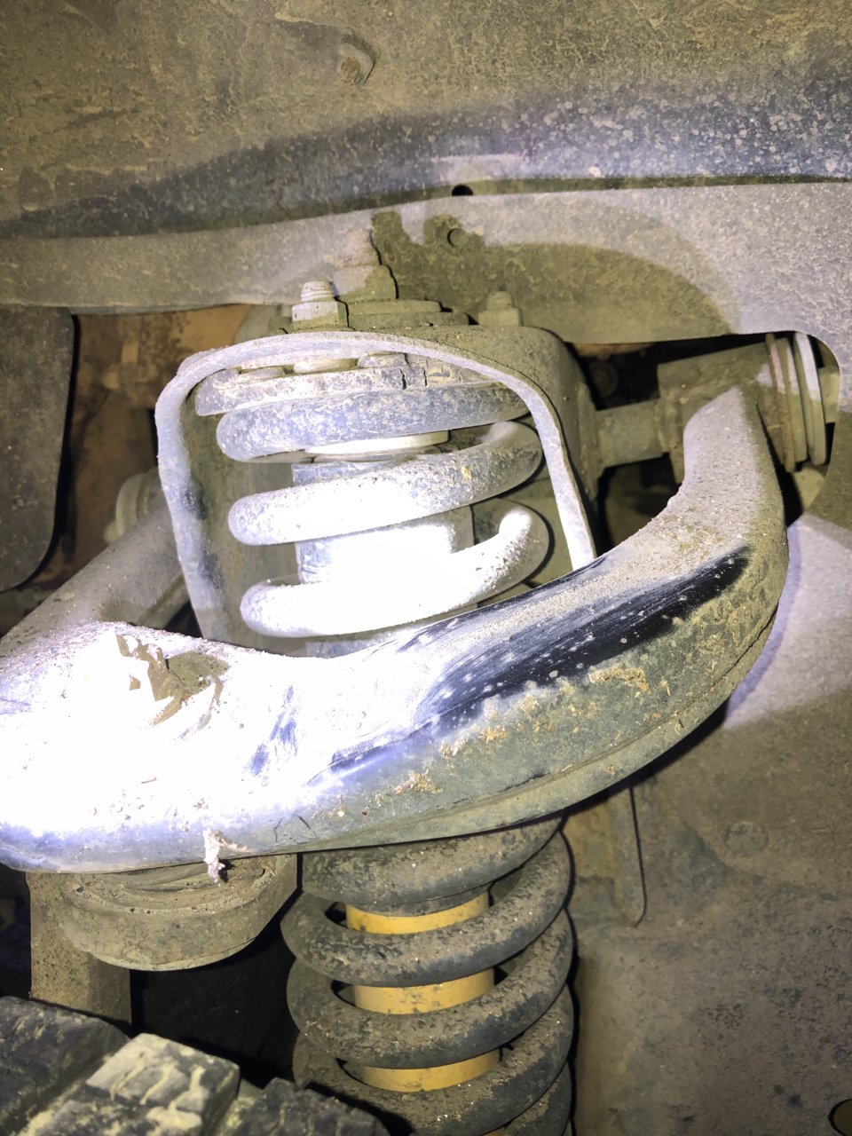

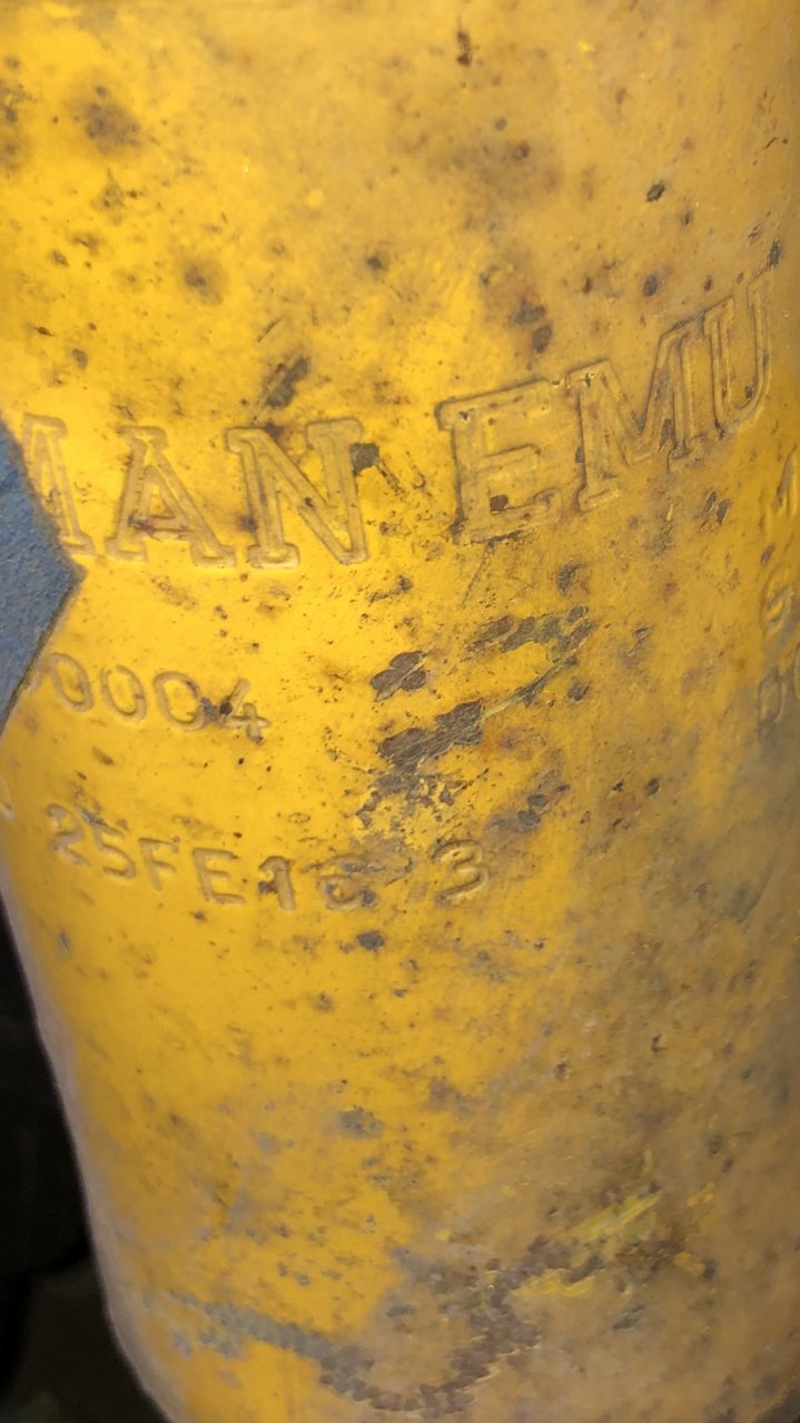

    I wasn’t able to find MUCH in the way of markings / specs on the coils that I personally could see…except the one I zoomed in on. Maybe someone can make sense of what is in these photos? Endless thanks to you all! Side photo of truck included just for visual reference..

    The white label on the coils; what's it say?
    880, 881, 883?
    That front end is as high as Snoop Dogg

    the shock won't reveal what the coil rating is, like Kwikvette said above it will be tagged on the coil...hopefully its still legible.
    Pretty clear in one of those photos that those boot fins are smushed together so it's just a matter of time before they rub apart, as a general rule you want to be able to slide a piece of paper between the fins. If you can't then the constant rotating of the CVs while driving will cause them to leak in no time
    The inner boots tend to rub as well
