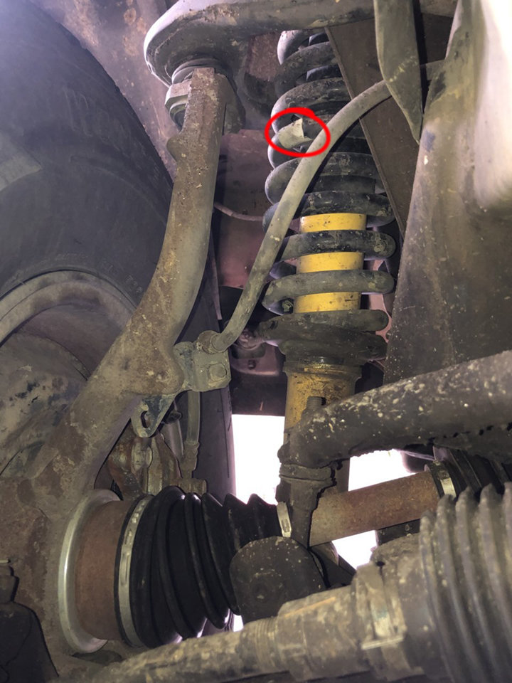

    Afraid there is no white label.. that’s from the flash of my camera + flash light. From what I could tell I couldn’t see any markings on the coil’s themselves. I’ll go look again.
    And Damn eon_blue….Good to know about the fins :/

    This white tag here, it gets folded up inside the spring and should say what kind of coil it is
    unless it ripped/broke off at the end
    Kwikvette likes this.

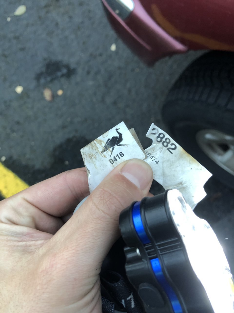

    Oh shit!! Dunno how I missed that white label. Good eyes!! It says..

    K. Thinking I may just reach out to OME myself and see if they can give me some advice / suggestions with the info I’ve acquired through you guys and from the numbers I pulled from the lift itself.
    So just to clarify… the white tag I sent a photo of. That implies I have 882 coils.. ya? I tried searching myself but couldn’t find much Maybe I’m not searching the right criteria.

    882s are 500# coils, 883s are the 600# ones. The 882s are tall though and meant to provide up to 3" lift on a stock front end. I think op would be better suited with 881s
    Chaospdx85[OP] likes this.
