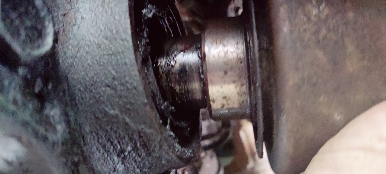

    Canadian with a 2013 here... I'd say that's not too bad. But you might want to get in the habit of spraying fluid film on everything under the truck once or twice a year to prevent it from getting worse.

    Diff should be puking out oil with the CV popped out like that. At some point you had to have had a huge oil stain under the truck. Differential is probably dry and damaged if I were to bet on it.

    The snap ring keeps it from popping out.
    But it doesn’t really “keep it in”
    It shouldn’t be under tension. As in, there shouldn’t be anything pulling it out.
    Looks like your truck might be lifted too.
    That coupled with the wrong axle isn’t helping you.

    Not trying to sound like a wet blanket but I'll bet that differential is toast. Look at silvery-ness of the oil stain that came out. It's been dry for a while and damage has probably already been done.
    But.. you won't know for sure until you get a proper axle and seal in it and see what's up

    I mean in all fairness, if the diff was 100% dry it probably would have grenaded by now. At the very least Id expect some awful noises. So hopefully OP isnt totally screwed yet, but it 100% needs to be fixed asap haha
    Could even cannibalize that CV and just put the housing itself back in, just in the interested of getting fresh gear oil in there asap

    Okay, I checked my diff oil and I still had about a quart and a half of fluid in there.
    PITA stupid 10mm Allen! I tried to shove axle back in diff...she won't go.am I missing something? Or do I gotta take wheel off and put it in that way?IMG_20220516_130857.jpg

    you need to take the wheel off and disconnect the axle from the spindle/hub (undo the axle nut and whatever else is involved with the 2nd gens). With 1st gens you have to disconnect the lower ball joint as well. I highly doubt you're going to get it to go back in while the axle is still attached to the hub.
    Once it's detached I usually thread the axle nut back onto the end of the axle and then persuade it with a hammer so that it goes back into the diff. Do not hammer the end of the axle without the axle nut on it or you'll mess up the threads and have to get a new axle.
