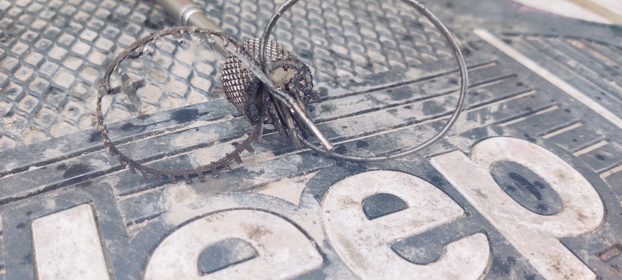

    Ok, I got the CV axle out. This crap was close to the seal...what is this crap???
    I know it's from my differential, but now what?

    You need to replace the cv axle, the needle bearing, and the seal at a minimum

    Those are needles from the needle bearing. You 1000% can't put it back together without a new bearing, axle and seal.

    Well.. theres your issue :D
    Looks like the needle bearing has come apart. And I think the thing on the right is spring from the seal?
