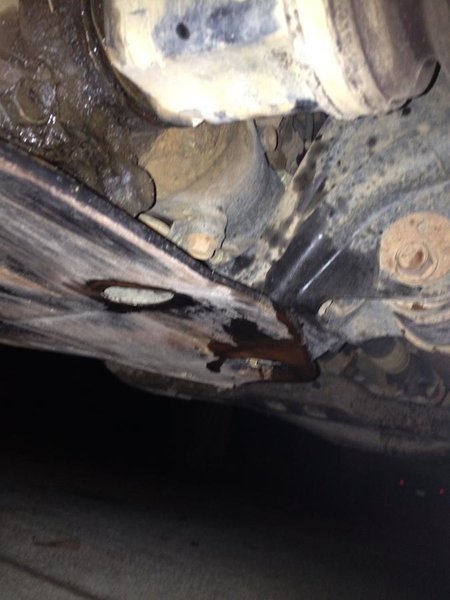

    Im have some leak on the driver side axle, its not tight and its leaking..
    is it just a quick seal replacement or what
    thanks.

    Took pic with phone
    I just bought this truck
    I def have all tools most likely to fix this. I have never done a IRS though.
    Thanks for your help

    Yeah the cv looks like it is seated properly so it has to be the seal leaking. Not sure how replacing the seal itself goes, but the cv's aren't too bad to pull.

    Humm. Well if I grad the axle it moves around a lot! Like its the bearing. I seem where some guys were saying there is a needle bearing on it? And is that pressed on? Is that the only bearing I would have to change or is there another one in there?

    It's a lot more play in it!

    A lot more play that other axle. Has Anyone ever had the deal fix this problem?

    I have never replaced anything on this truck yet. Just bought it. The cv axle is very loose and its leaking. It's loose where it goes into the diff. It doesn't look like anyone ever replaced anything yet. Truck has 117000 miles on it.
