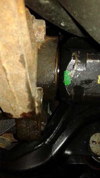

    So I'm putting in a rebuilt Toyota cv axle
    Not sure if its in all the way
    I'm having trouble getting it in its about a 1/4" out
    Can anyone suggest any way to get it in all the way.
    Giving up for tonight will try again tomorrow

    I can't tell from the pic if it's all the way in. But, if it's not, use a pry bar. Put the prying end into one of those notches in the CV shaft shown in your pic.
    Take a hammer and hit the other end of the pry bar. Obviously, you only need enough force to compress that retaining ring and get it into it's groove.
    This is also the best method I've found to remove the CV shafts.
    Good luck!

    Thanks but I should have explained better
    trying to get the shaft back in
    still have a small gap between the diff and the axle
    when do I know if the c clip is in all the way
    seems like its in but theirs an 1/8 gap not the same as the other side
    should they match?
    The pic is the new shaft in place
    Does it look in all the way?

    That looks like it's in to me.

    Yup it was in
    bolted ita all back together
    Good to go
