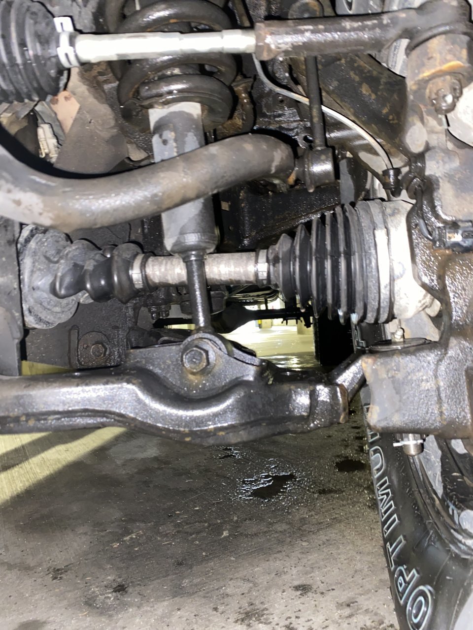

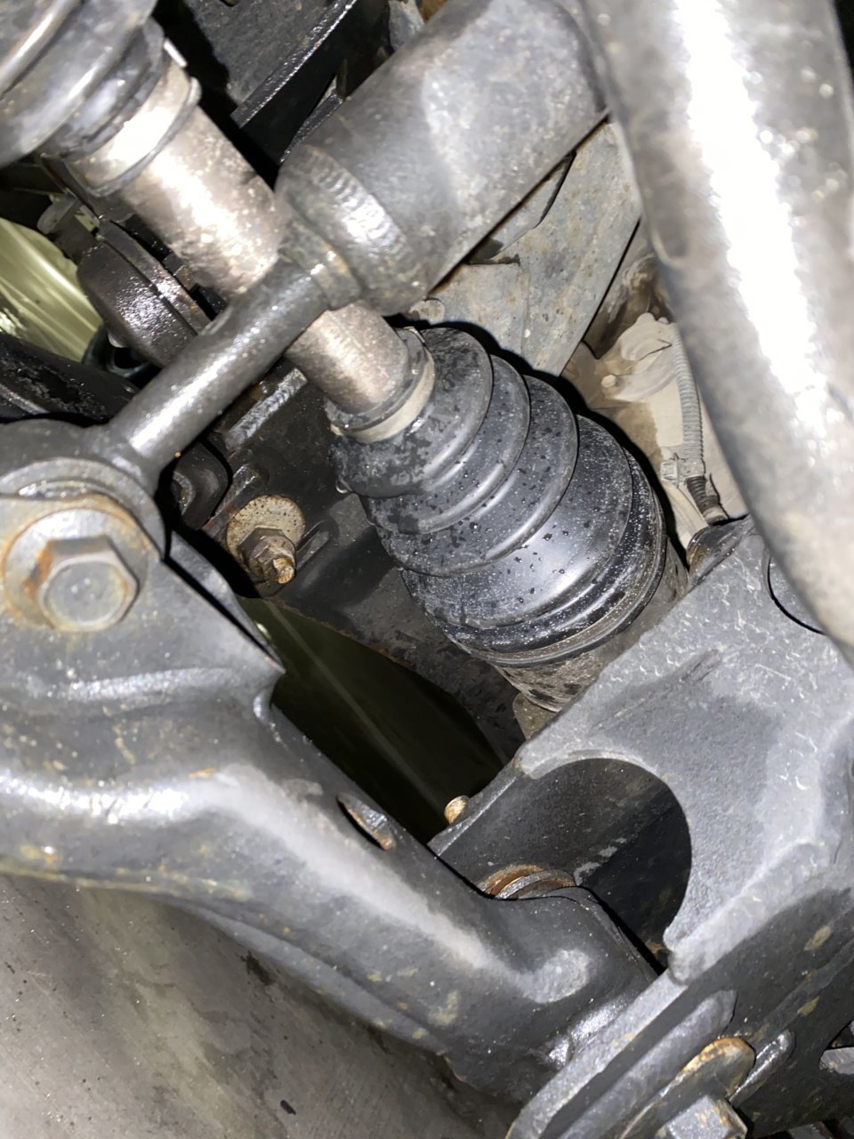

    G’day Everyone,
    My name is Kobe, and I'm new to this community. I'm having a situation with which I'm hoping for assistance. I have a manual 2006 Toyota Tacoma with a 4.0L V6 engine that I adore. However, I purchased it with a 6 inch Fab Tech lift kit that also included a diff drop, so the angles appear to be acceptable (but I could be wrong here). The problem is that when I (the mechanic) install the CV axles, they are about 1-1.5 inches too short in length, causing the boot to stretch and not sit properly. As a result, the CV axle wears out significantly faster, and I can't use 4x4. The next issue was that I recently bought a new set of CV axles that were designed for a 2" lift kit because this one is 2 inches longer than the stock CV axle and if I were to purchase the CV axle for 3.5"+ this definitely would have been to long to fit as I only need it to be 1-1.5 inches longer. However, I've discovered that this CV axle (the 2" one) is approximately 1 inch too long and will not fit.
    This is where I'm at a loss. Because I can't seem to locate a CV axle that's between a standard CV axle and the one, I found with the 2" lift package. I was hoping someone might be able to point out something I'm not aware of? Or am I missing something? Alternatively, a solution to the problem. There is a custom route, but it is an extremely costly and time-consuming process. I'm sure I'm not the only one that has this problem.
    Sorry for the long post. However, I have searched everywhere on the web and just can’t seem to find the answer. Instead, I decided to reach out to the experts!!!
    PS. I know a 6” lift is big may be too big but I like it and why would they make it, if it’s going to cause these issues right?
    Thanks Kobe

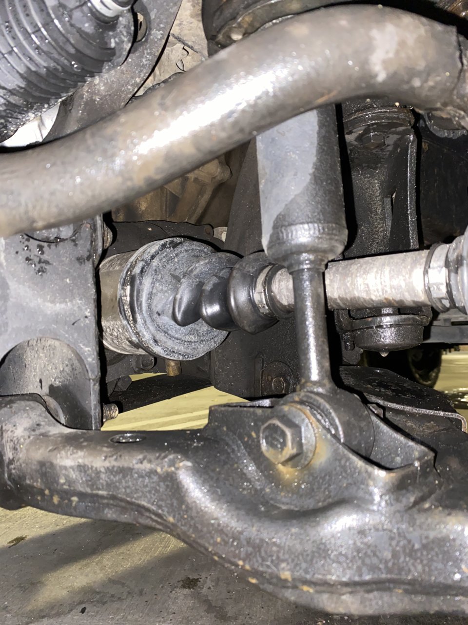

    Oh, right I understand what you are saying. The ones in the photo are the stock ones. I took the extended ones out and am sending them back because they didn't fit. So the ones in the photo are stock and too short. They are just there in the mean time until I can find a solution.
    Here is another view to help. Just in case

    Is this how the axle is installed and do you drive with it like that?

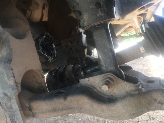

    I used to have a Fabtech 6" kit on my truck, and I had a similar experience. Mine actually ripped itself apart once while flexing.
    I don't have an answer to your question, though. I Pulled the 6" kit off and went back to a 3". I got tired of the issues a drop bracket kit causes
