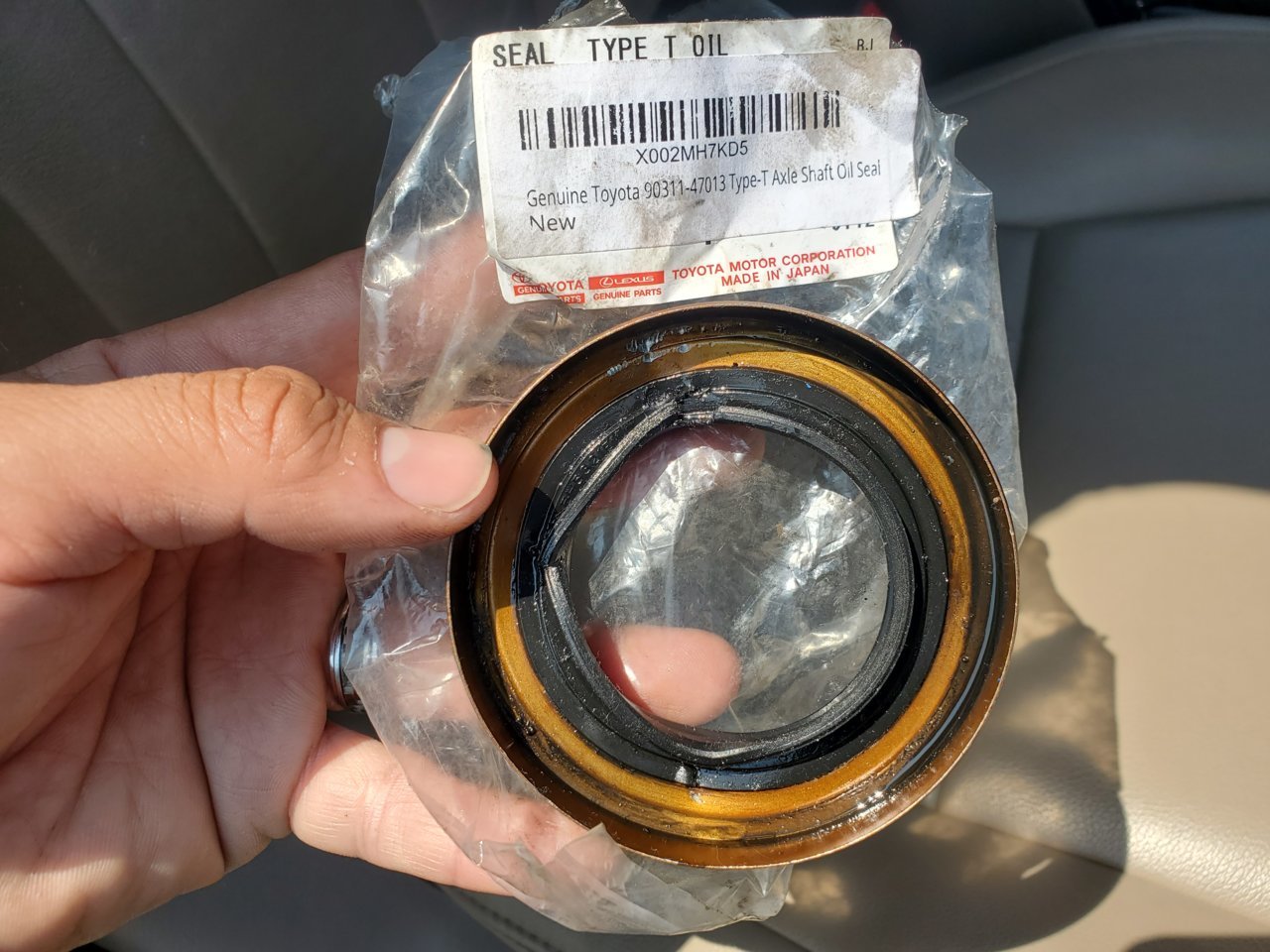

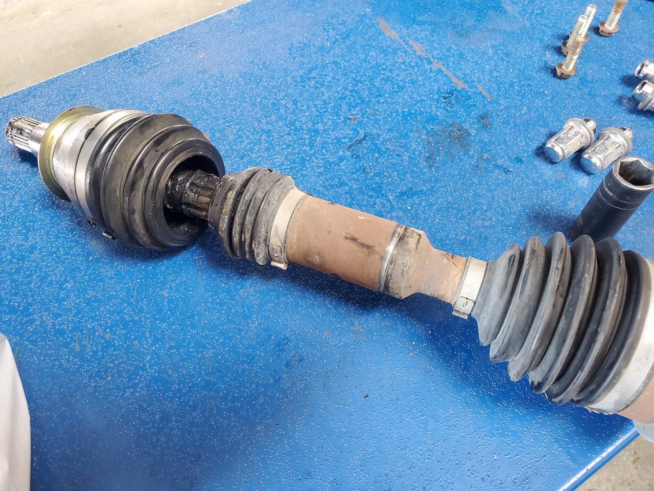

    Yup, that locking ring needs to be installed properly ;)

    Sorry brother; yeah dirty parts viewed on a phone screen made it look like the clip at the end of a cv axle shaft :rofl:
    Like you said, it's a good thing the old one came out with the old cv axle as this thread could've been a whole lot different

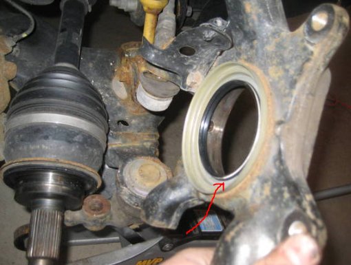

    I thought I had a spare seal so I could get OP a picture of “where the spring sits in the seal”. Just for reference.

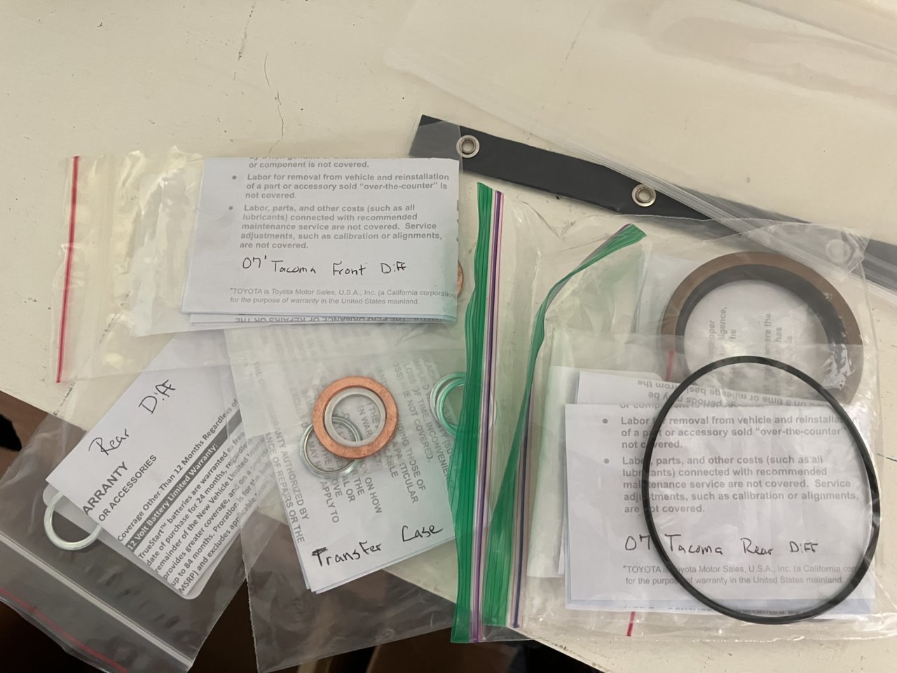

    Yep. Here’s my “Just in case” stash.

    Oh I have a shit ton of those parts, and don't even own the vehicles anymore.
    Same with an offset seal driver for an 80 series Land Cruiser, rear extended brake line for a Tacoma, rear coils for a 4Runner and other odds and ends :bananadead:
    Nice thing is the brand new OEM constant tension clamps can come in handy along with all the OEM vacuum lines that can be used in place of other vacuum lines.

    Here is where I'd look to see if the spring is missing.... wheel bearing seal, the spring keeps the lip seal tight. If it is missing I could see water getting in there and washing the grease out of your wheel bearing. They can easily pop out while wrestling with the knuckle and CV....
