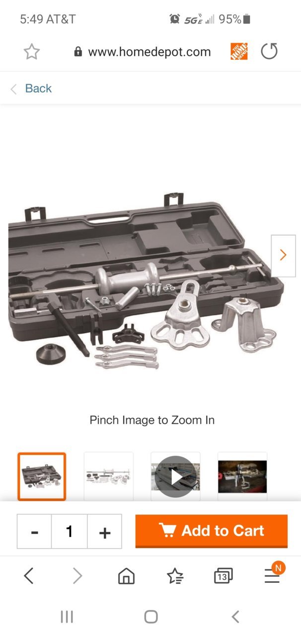

  11. Oct 21, 2020 at 3:51 AM
    #31
    acgreen01
    acgreen01 [OP] Well-Known Member
    May 31, 2020
    #329967
    157
    Andrew
    2012 silver 4wd regular cab
    This is the slide hammer kit I have except mine is Matco Screenshot_20201021-054955_Samsung Internet.jpg

    I used Toyotas updated bearing , no problems so far, have about 1 year on it, 15,000 miles , 2 road trips . I tried a blind bearing puller , then a 4 jaw type puller one that u tighten up a rod and it expands then attach a slide hammer but neither of those 2 removed it, might of loosened up. I ended up using a series of small files to noch the side of the bearing to weaken it then hammer and small cabinet tip screw driver to collapse it then was able to pull out. Looking back on it I didn't have the proper size 4 jaw puller , if I had could of been different results. Don't forget to put something in the open hole so debris doesn't get in the diff. Good luck keep us posted.

    I did the ECGS bushing using regular pullers (I have a couple of OTC kits like you show) and not their custom tool.
    Used a beam and legs to pull with some finesse rather caveman approach with a slide hammer. I used 2 jaws and the only hitch I remember was keeping everything aligned to just grab the bearing cage and not catch or score the diff housing.
    Getting the bushing in was kind of tough, not much space and you need to make sure it stays square.
    From what I remember I don't think their tools are absolutely needed if you have pullers and drivers. If you have money burning a hole they'd probably make it easier, especially driving the new bushing in.
    The only thing that comes to mind is that my cheap Harbor Freight seal driver kit didn't have an adapter that fit the seal so that was a PITA. I had to cobble one together from PVC and junk I had in the garage.

    The slide hammer was useless in this application. The bridge on the other hand, made it easy.
    Doooooon't set the outer seal deeper than just past flush..... Unless you want to do it again. Drive the seal to deep and it's gonna leak bad.
