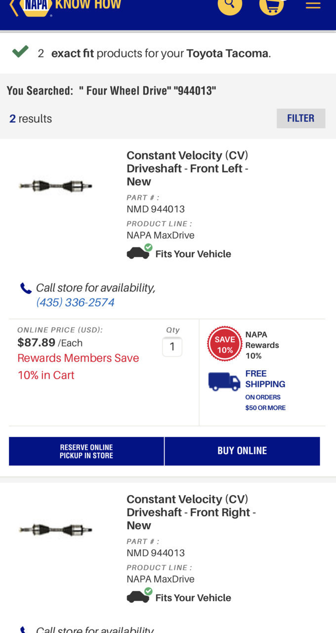

    I have a 2004. I just replaced my CV axles less than a week ago and my passenger side has already popped out. I used NAPA axles. I believe it popped out when the suspension dropped far enough. I have a 3 inch OME lift. Anyone else with a 3 inch having this issue? Maybe the Napa ones are shorter than OEM? I’m not really wanting to do a diff dropped and I’ve seen people do limit straps which is an option. Let me know what you guys think.

    Yeah I suspect it wasn't all the way in to begin with, a lot of people run Napa axles with lifts since Napa is generally considered to be the best parts store axle you can buy.

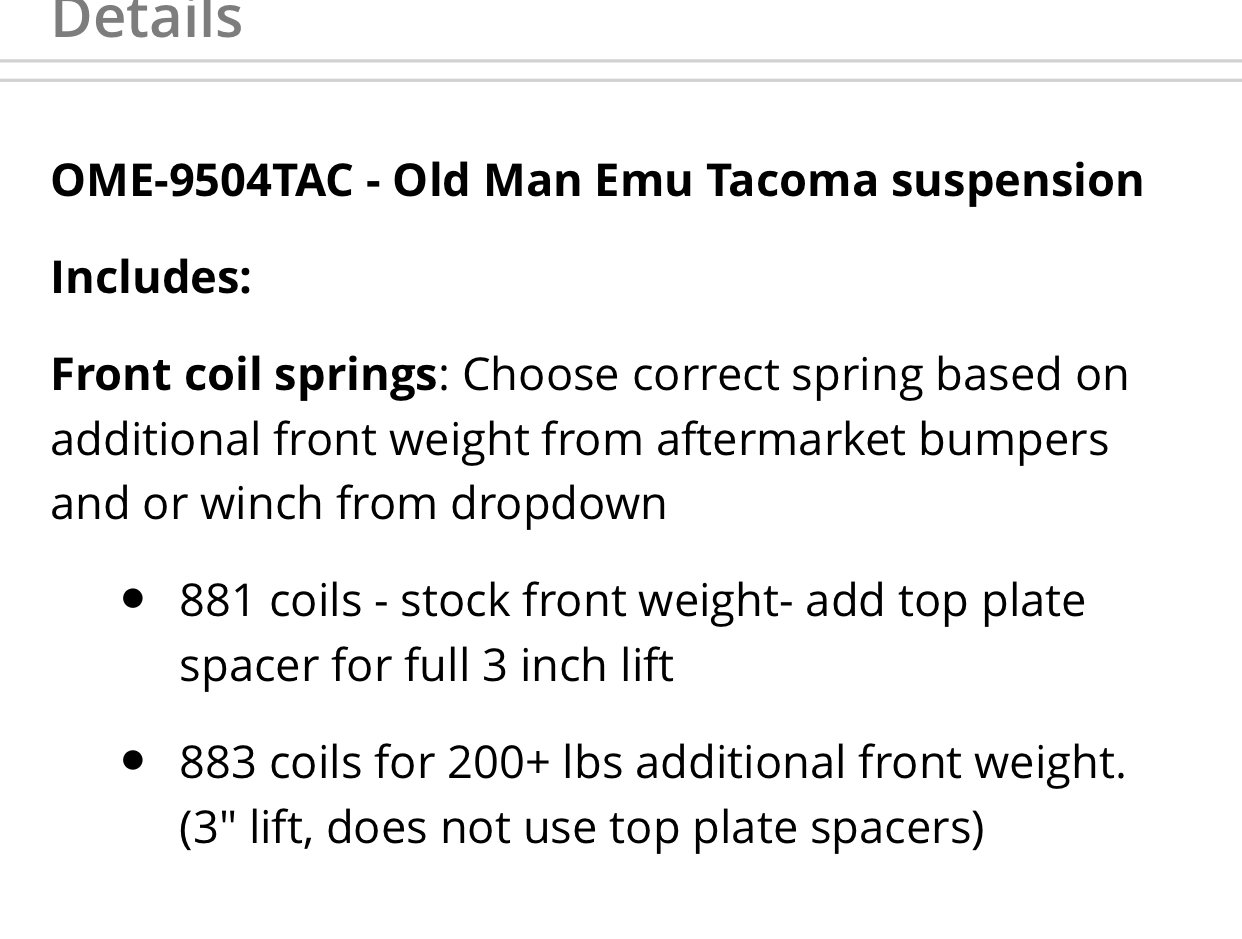

    I missed the part about the 1" spacer on top of the 3" lift, yeah that's crazy for a 4x4...way too much for the CVs. That's probably what caused it to pop out, and it would've broken the CV eventually anyway if it didn't pop out.
    OP if you want more than ~2.5" lift on a 4x4 then you need to look at a drop bracket lift, stacking lifts on a 4wd with IFS like Tacomas have is going to break things.

    Just looked up my lift and saw this. The spacer makes it a 3in. So disregard what I said. Sorry.

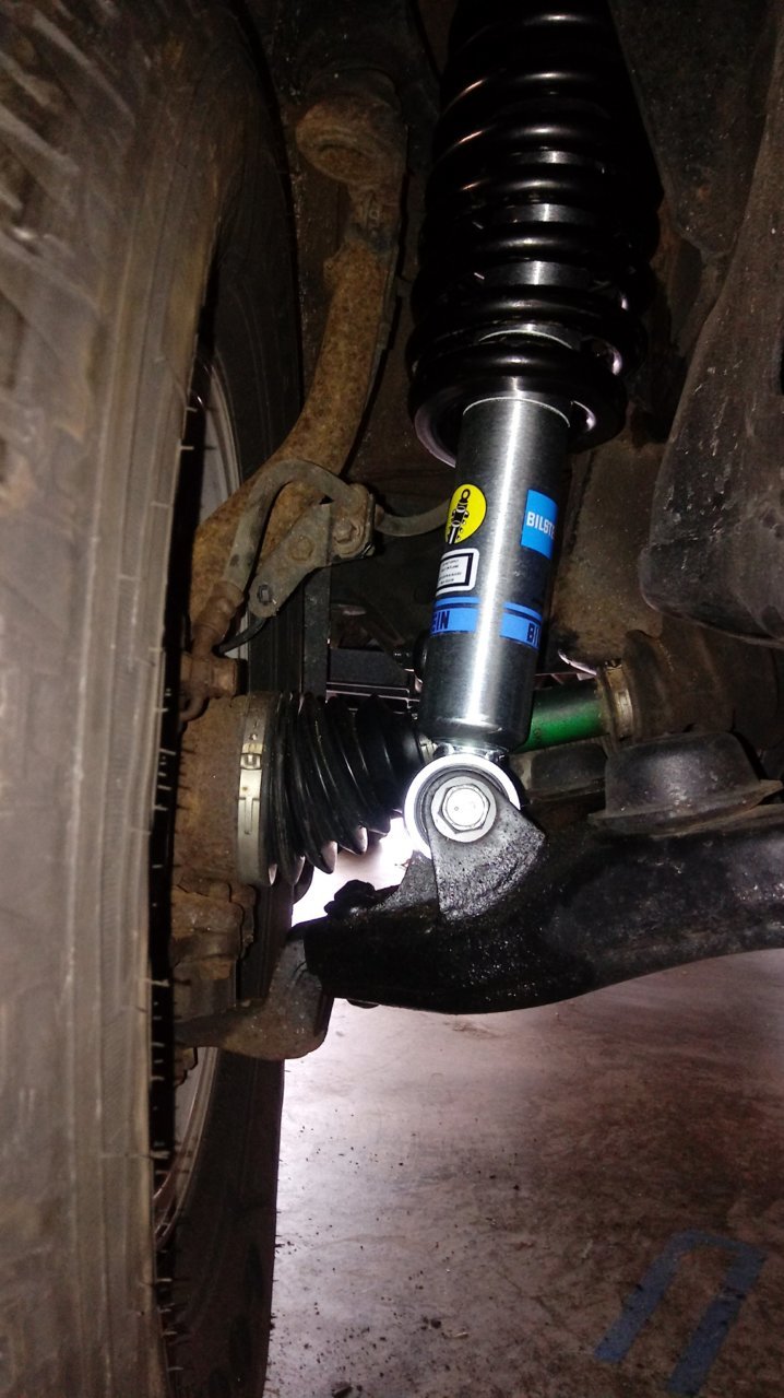

    When I first installed my lift, I put the 5100 on the wrong notch with new coils. Net me about 4". UBJ's would not have lasted long either. 0324181507.jpg
