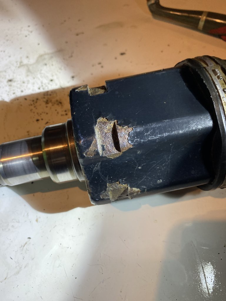

    Also, some of the powder coat is coming off the tulip, revealing some rust underneath, is that paintable? Same with the center shaft. I’ll include pictures in a minute.

    Grease should be fine. Wire brush the rust and paint it.

    Here is the rust. image.jpg I am thinking wirewheel and paint before taking it apart so I can have markings in the correct spot for reassembly.

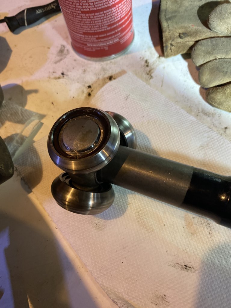

    I can’t seem to get this triple bearing off the shaft. The snap ring is removed. I have been using a 4LB hammer and a chisel but I am worried I am going to damage it.
    Is it fine it I don’t remove this section? Just clean out all the bearings well.

    ^How do you replace the boots if you don't get the tripod off?

    ^Wrap a rag around the bearings so they don't fall off the spider. Then use a bigger hammer with the chisel. A mechanic in a shop would use an air hammer.

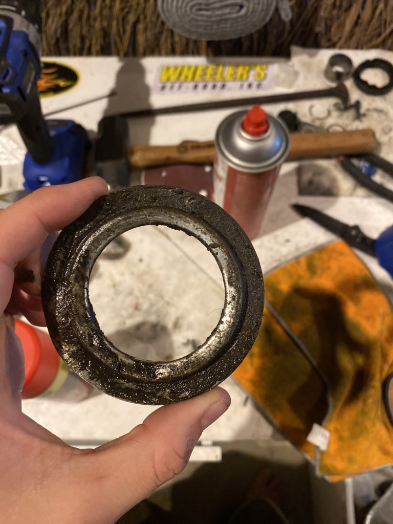

    While removing the axle I damaged a dust seal. It sits between the tulip and the rubber seal. I swear I searched for a part number but I’m kinda lost.
    Anyone know the PN? Also does it press into the rubber seal? Or is it supposed to fit on the CV?

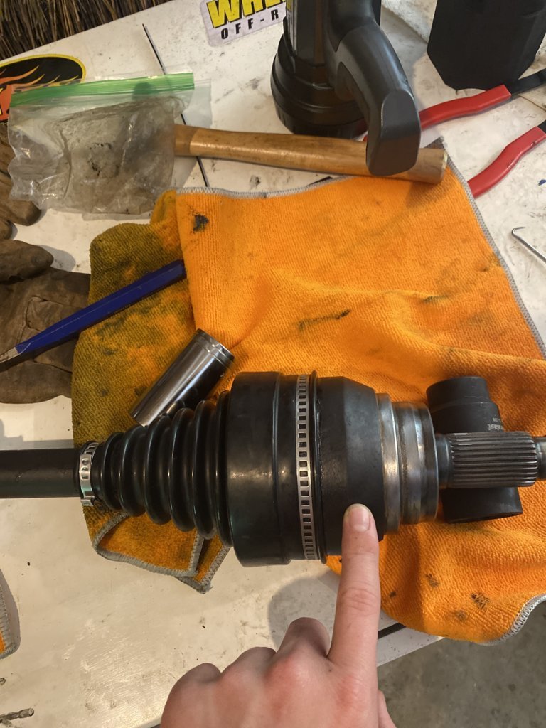

    I got the outer boot on and it looks to me like the first fin will contact the seat super easily.
    this extra space is added from OEM, I guess that’s what gives it the “long travel”
    I’m a real LT guy now :jerkoff:
    I currently have the clamp in the original location on the outer clamp. The inner clamp is slid further than stock down the shaft. Should I be sliding it further from the outer clamp to make more space between fins?
    These are the only 2 making contact.

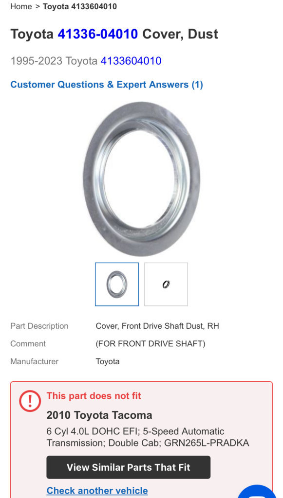

    This fits on the CV tulip. It's a dust/debris deflector for the diff seal. It's close to the diff seal but doesn't rub against it.
    I suspect the extended outer boot will foul on something in the suspension, maybe the lower shock stem. I suggest an OE-style boot. Unlike the OE inner boot, the OE outer boot typically doesn't have angle limitations when lifted.

    Tripod is off. Toyota doesn’t sell new dust seals, so I would have to run without one.
    Dealership told me I could order it, paid 50 bucks. Go to pick it up and it’s not anything like what I showed/ explained to them. Of course they printed “no returns on special orders” at the top of the paper. Regardless I fought for the refund on the grounds I let him identify it and order it. Then someone else tried to identify it and told me they don’t sell them.

    I wouldn't use the same grease for both inner/outer CVs. Might not cause an issue in the short term, but the difference in appearance and viscosity seems significant enough that it could shorten the inner bearing life in the long run. I also bought some All-Pro boots, but decided to go with OEM grease for the inners. In regards to the boot fins contacting each other, would they articulate that far when installed in the knuckle?

    ^The dust/debris shield is all-metal. You can reuse it. Just give it a squeeze with channel lock pliers so it stays on the tulip.

    41336-04010
    still in production
    Same metal shield since 1995. Inner CV debris shield

    Did you use their grease for the outers? I already have their grease in the outers, I haven’t touched the inners yet. I supposed not it wouldn’t articulate enough to rub like that. Although the point about rubbing on the lowe shock mount has weight. I could always slide the outer boot more towards the hub.
    like so.

    If you are right thank you sir, but the sites kept telling me it wouldn’t fit mine. I guess screw it for 7$ looks dead accurate.
