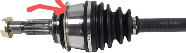

    There should be a seal on the outer CV joint, P/N 90304-A0001. It interfaces with the seal on the back of the knuckle.
    You'll want to weigh the cost of that seal. It's OEM-only with no cheaper aftermarket alternatives.

    Yes, I have those and the Knuckle seal.
