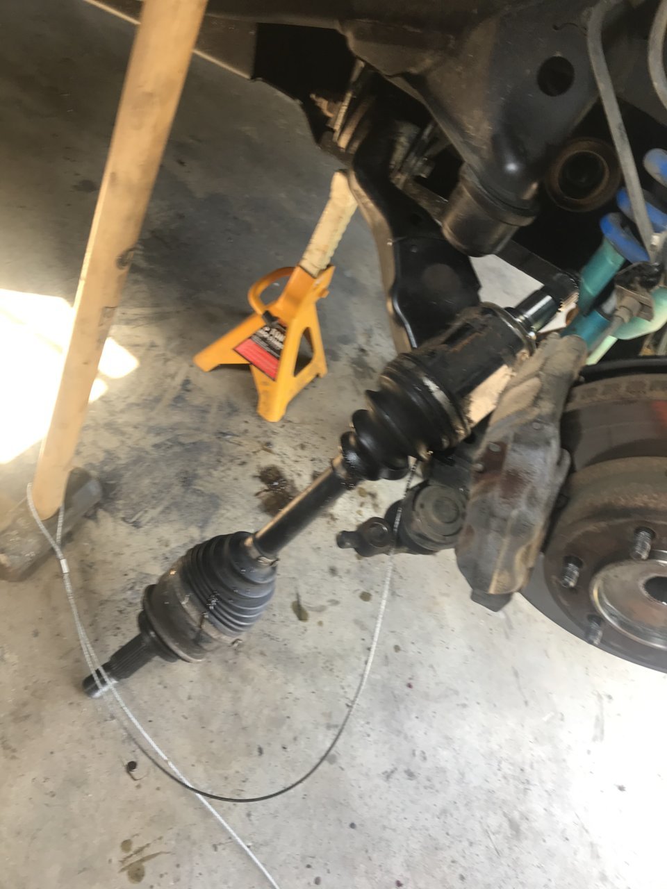

    I'm changing the left front axle in my 2012 Tacoma, The axle will not come out! What is the secret? Is there a special tool? Thanks for any help!

    Some chain and a sledge hammer. one end of the chain around the axle, the other around the handle of the sledge. Swing the sledge and pop out the axle.

    Sounds crazy enough to work I will try it tonight Thanks!

    Rotate the CV. Sometimes the circlip gets hung up and won't allow the CV to pop out. Rotate the CV a 1/8 turn at a time, and try popping it out on every turn until it comes right out.

    The c clip needs to be in the right position (6 o clock? I always forget) for the axle to go in and out. Just rotate it and keep trying

    Open end of the c-clip facing down

    pry bar between the CV and differential, pops out in about 5 seconds

    I BENT A PRY BAR! TURNED SEVERAL TIMES! STILL HOLDING ON

    :eek::eek::eek: Are you sure you are trying to remove from the correct area?

    Hello all . Sorry about leaving the thread hanging. I got the axle removed and replaced, but with a few problems. When trying to pry it out, the bar slipped and I took a hard fall, long story short I had a subdural hematoma (brain bleed). I had to have surgery to relieve the pressure. I was off work for 3 months and thank God, fully recovered. I was very Blessed. This accident showed me how fragile life truly is! Be Careful in all you do!

    Make a loop on both ends wrap one up next behind the cv loop the other on a sledge and swing it.

    Sometimes they pop out with pry bars using leverage.
    The last 2016 I did I had to use a striker bar and hammer them out, but it needs to be a straight angle where the energy moves outwards.

    I cut a piece of angle iron and tapped several holes, placed against the case and tightened the bolts until it popped out. I still do not know why it was so much trouble.
