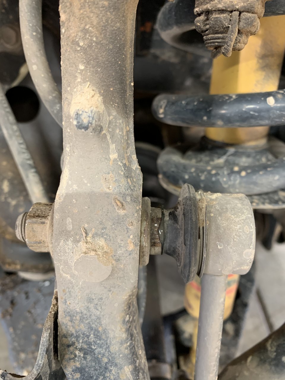

    Alright I’m doing my passenger cv and when I went to loosen the sway bar link from the spindle this happened. How bad is this? Does this mean I need to replace this also?

    No need to replace it ,its fine if that's all that came out
