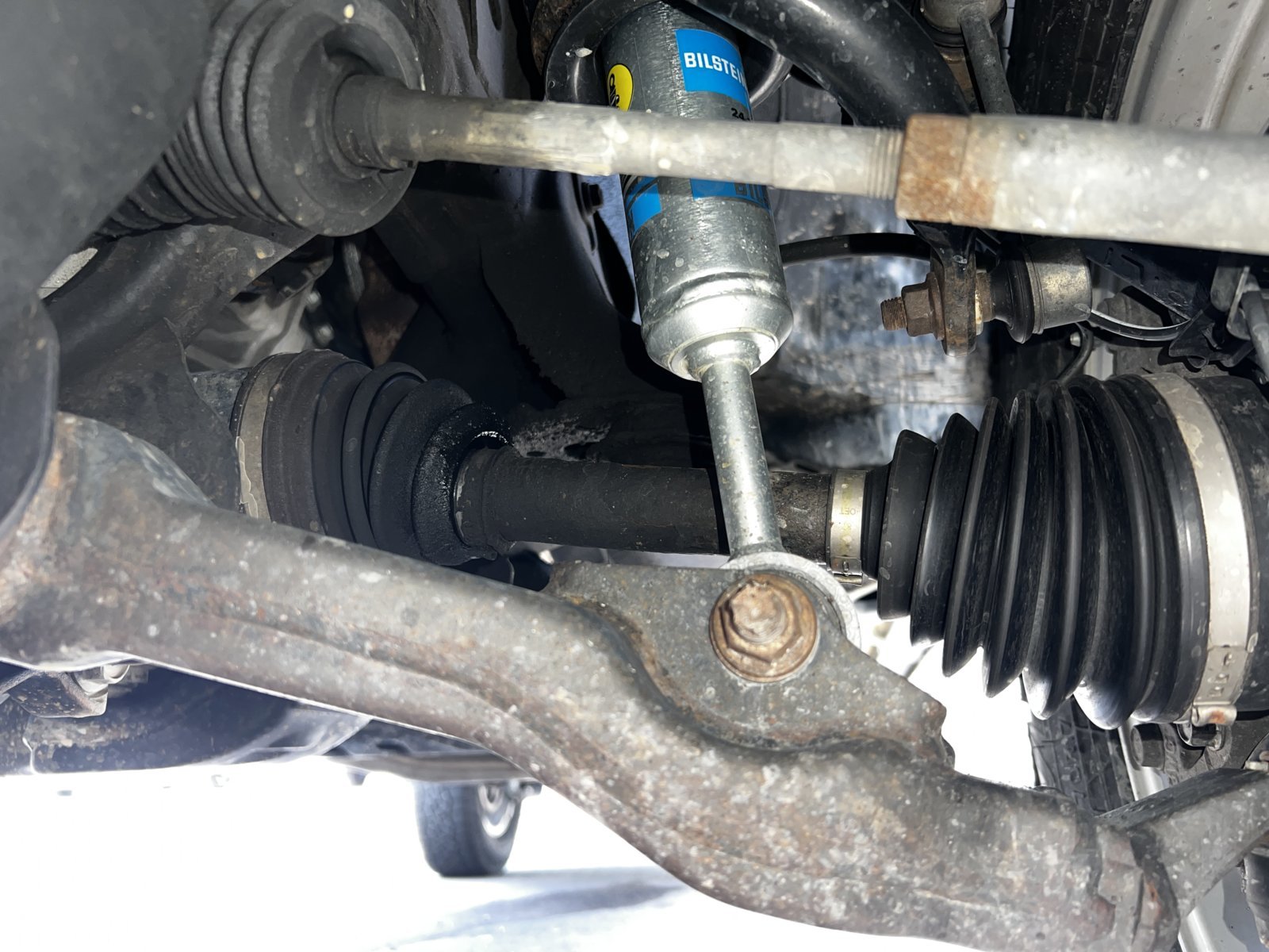

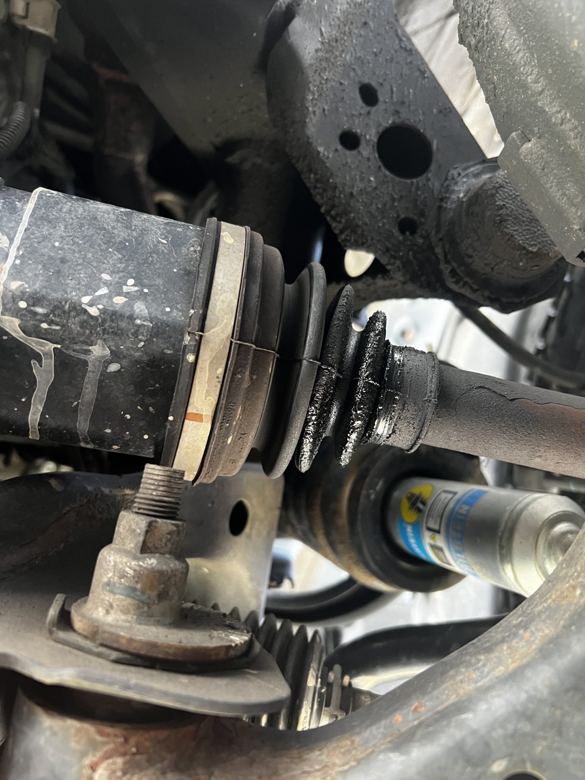

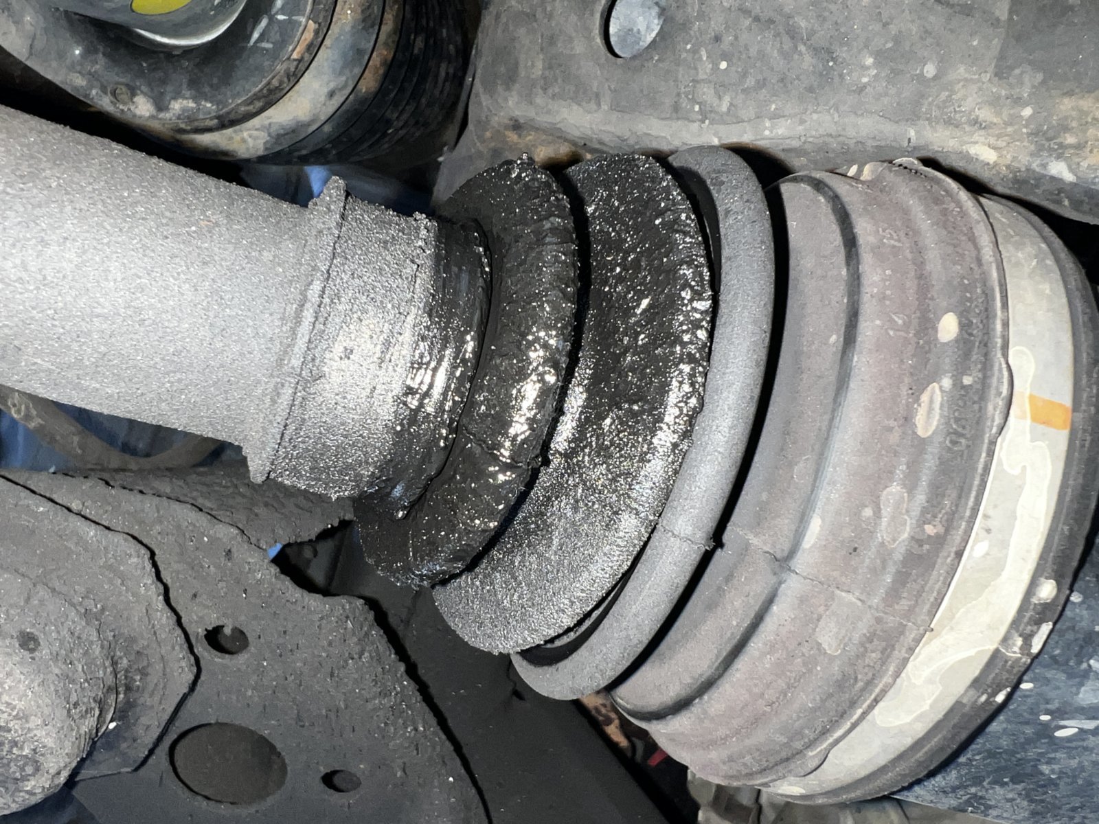

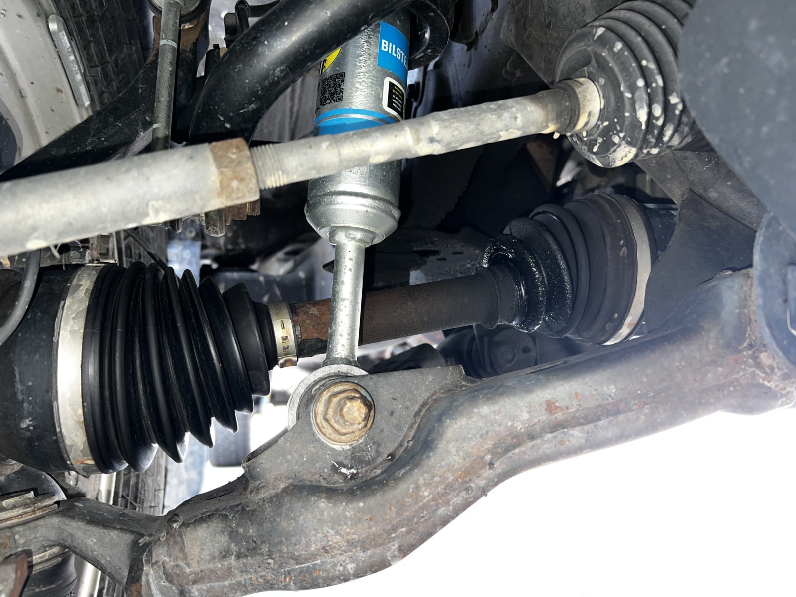

    Hi, I'm new here and I recently purchased a 2014 Tacoma Sport.
    I took it to a Toyota Dealer Shop for a Pre-purchase inspection and they found the CV Axles leaking on both sides need to be re-booted(outside) and quoted me $1000 for labor + $895 x2 for parts. So about $2800, no thanks. See pics below:
    The truck still drives fine and no clicking yet, but I want to be proactive and get it fixed.
    I want to buy the parts myself and have a local shop install them but I'm not sure if I need a new CV Axle assembly or just boots for both of them. I've heard that you should keep axles if they are OEM and just re-boot them(Not sure if I have OEM). Truck also came with a 2.5in Bilstein Level kit so I'm wondering if it is necessary to upgrade to a extended travel CV Axle from RockAuto, link below.
    https://www.rockauto.com/en/moreinfo.php?pk=15778889&cc=3307209&pt=2288&jsn=508
    So my main question is:
    Should I upgrade to an extended travel CV Axle assembly or just get a new boot for the current Axle.

    Thank you for the quick response. I did knock $500 off the price to do the repair myself.
    I'm leaning towards DIY with a reboot kit.
    I don't think the whole CV axle needs to be replaced unless the new boot is going to rub and tear again from the lift angle.
