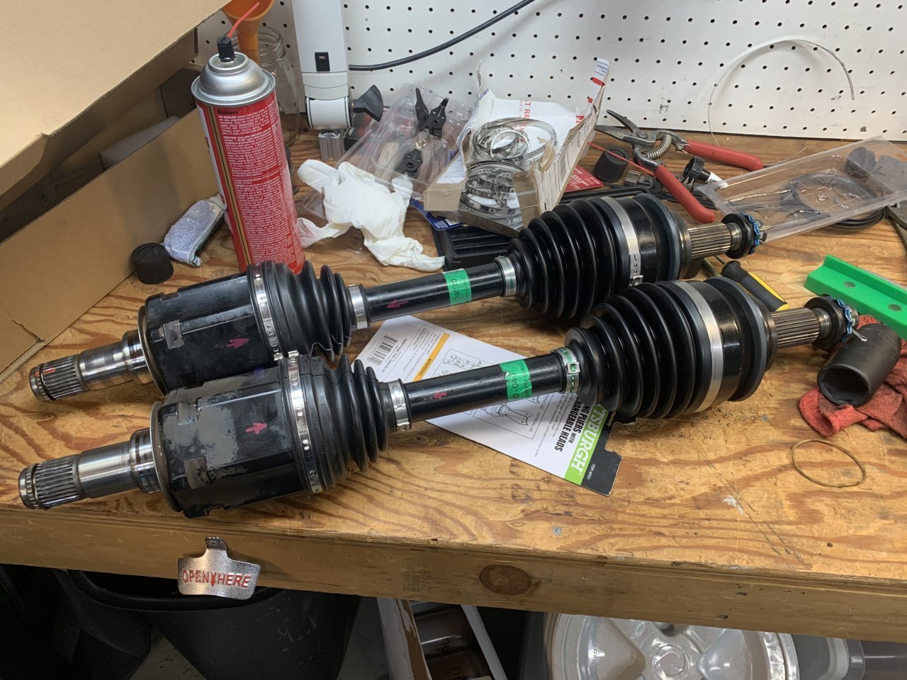

    Anyone else have trouble with their CV boots tearing?
    I replaced my passenger side 2000-3000 miles ago and now my driver side ripped.

    i appreciate the advice. Just got done replacing them, looks a lot better now.
