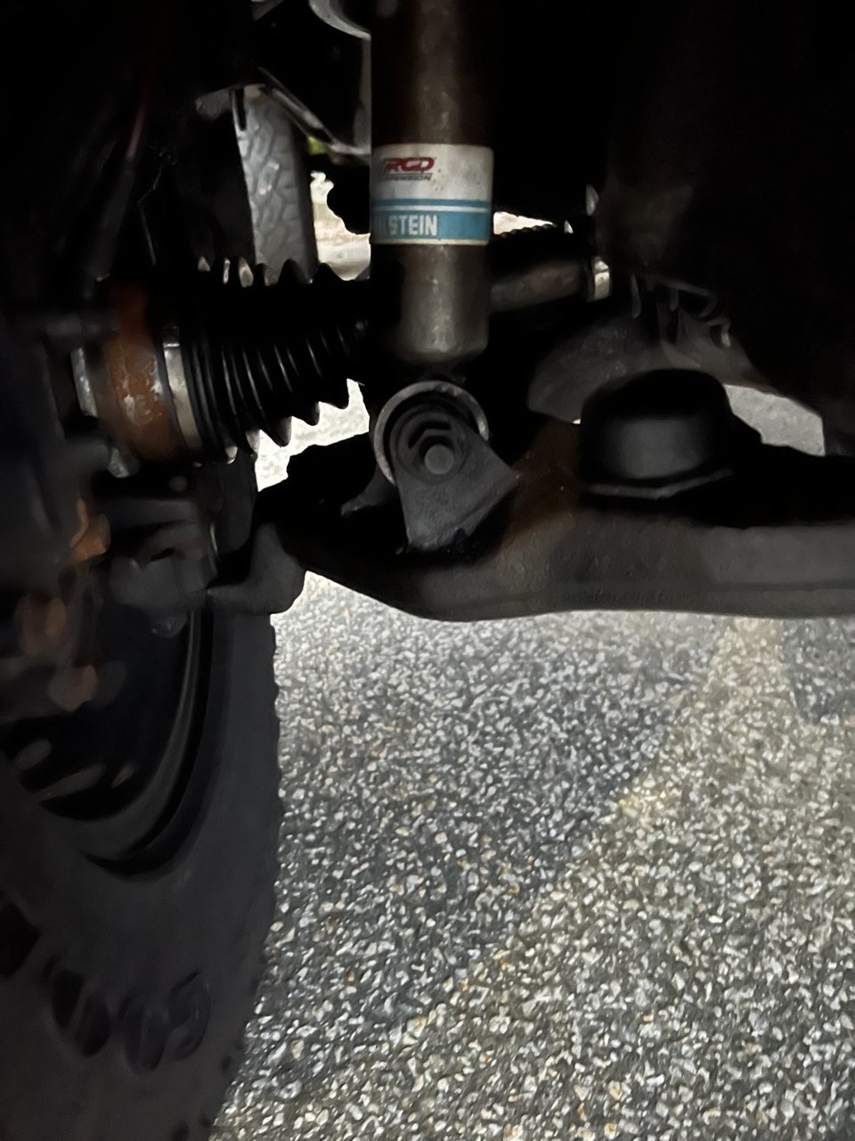

    Here’s a photo of the CV axle as it sits in driveway. Sorry for dark picture.

    You got rid of some lift?
    That's a much better angle.
  4. Jan 17, 2023 at 2:37 PM
    #24
    Area51Runner
    Area51Runner Well-Known Member
    Jun 26, 2014
    #132748
    11,988
    Northern California, Bay Area
    02 3.4 DC TRD PreRunner 4WD SWAP
    Off the shop lift makes a world of difference ;). Looks fine.

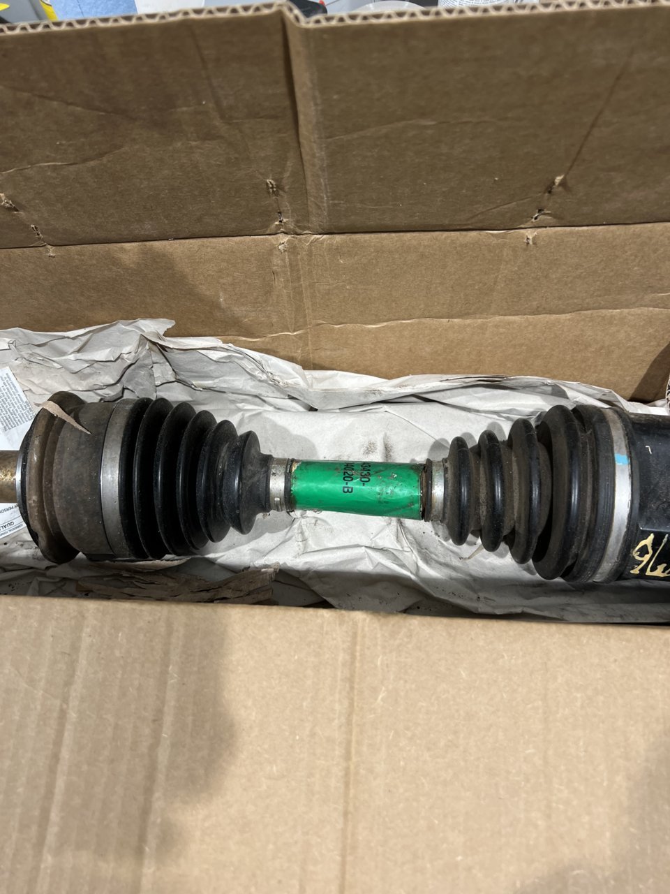

    This showed up today. I haven’t ordered the reboot kit, but I did reach out to the member that worked on Area51’s axles.
    The shop that did the work said they would install this one for free and give me a credit on the aftermarket ‘clunker’. Is it really that hard to do it myself? I think I’d rather do the work and just give them back the aftermarket one in a box. would you recommend I do LBJs at the same time? Sounds like replacing the UCAs is not necessary for me.

    It's a super easy job. No special tools. Just take your time with it, there are a lot of write ups and videos out there to guide you step by step. The trickiest part your first few times is getting the old axle out/new one to pop in but it will.
    My first time, I rushed it ended up cross threading the axle nut when I installed the new one. Foolishly figured it was fine until next time I had to deal with it....300ish miles later my wheel bearing failed lol.
    If you take a hammer to the axle to help push it in, make sure to leave the axle nut on the end so you don't damage the threads. That was the mistake I made that lead to the cross threading the first time.
    Do the LBJs at the same time, you have to unbolt them anyway to do the CV axle and it's just another few easy steps to put new ones on. Again, tons of good write ups on here for LBJs too.
