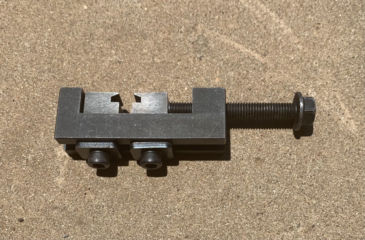

    I just got mine done last month, and I found out about the crimper needed for the rings on the outside. It’s not expensive and works good! I used hose clamps for a week waiting on the tool to arrive! It crimps those SS clamps with ease!

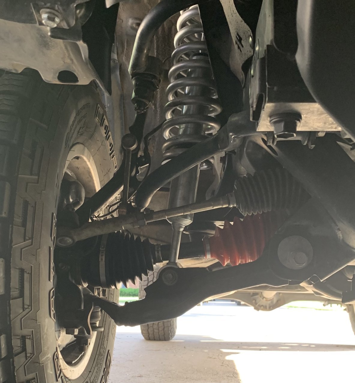

    I replaced my torn boots with ones from Dobinson about 7 months ago. Can't really speak to the quality yet because they have only been on a short time, but I do wheel a fair bit in the Sierras and the California desert and haven't noticed anything yet.
    I think I paid $40 per set, but looks like they are $50 per set now.
    https://exitoffroad.com/product/dobinsons-high-clearance-outer-cv-boot-kit-for-toyota-lexus/

    Those crimpers aren’t any good if you use the stainless steel bands, I broke 2 of the tools, before getting the good tool that Toyota, and Lexus made for it, and I’ll never use anything else, the SS clamp are the best the light ones won’t last as long, or clamp as tight.
