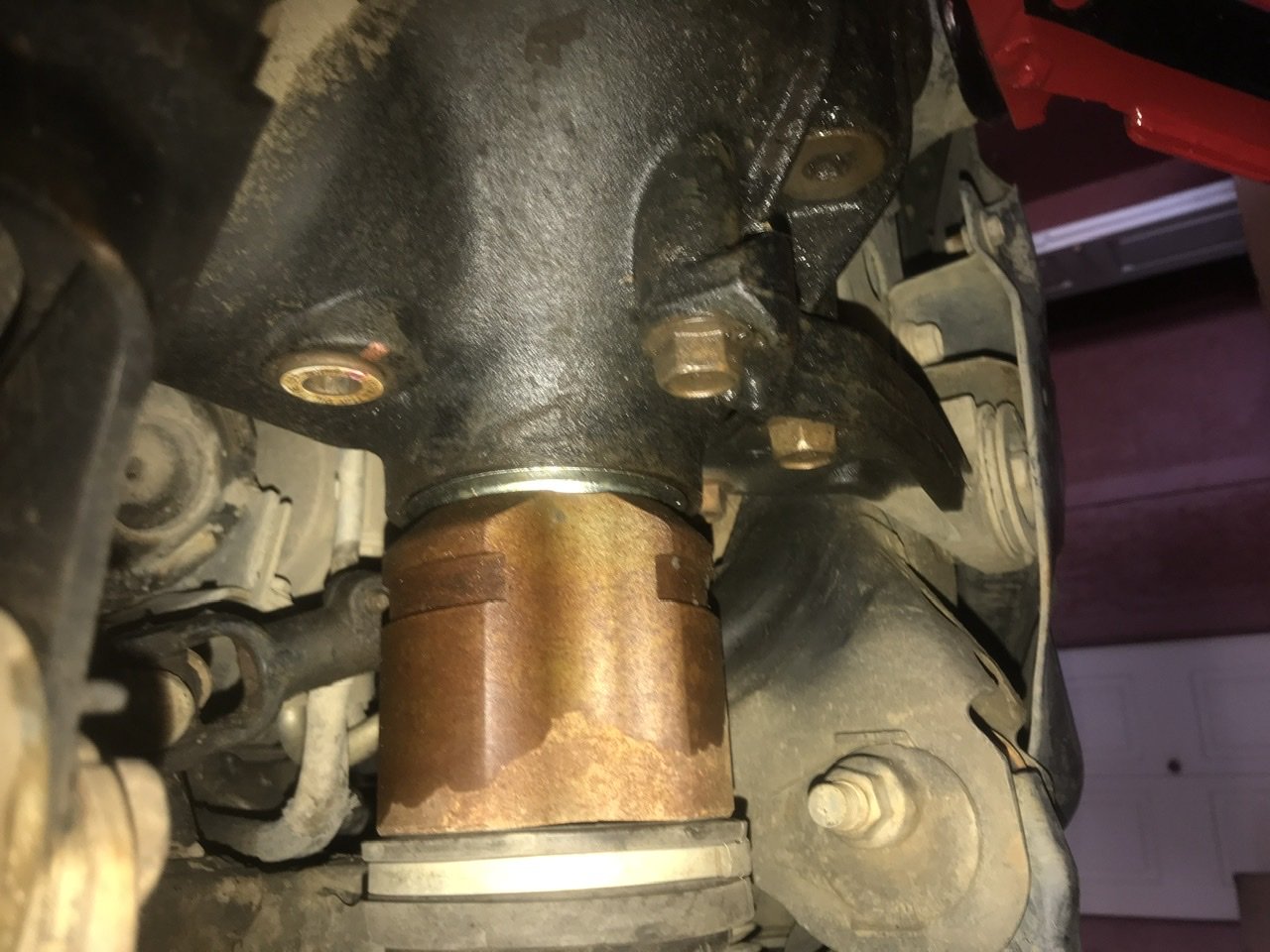

    Am I having this same issue? Sure seems like it. No idea why it rotated when it uploaded. Sorry about that.
