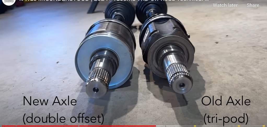

    My assumption was based on simulated off-road driving characteristics using ramps and measuring maximum articulation. This did not including jumping the vehicle where both front tires would be airborne (drooped) simulanteously.
    This was based on Tinkerer's youtube video comparing 3G to 4G suspension attributes. When using the sway bar disconnect the 4G improved front wheel articulation (increased droop) over having the sway bar connected.
    Start at 9:30 seconds (and 18:29) into this video:
    https://www.youtube.com/watch?v=FE3lbi89DNI

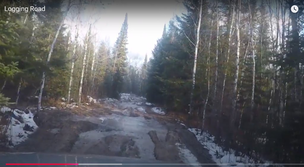

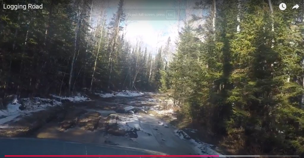

    Think any of that advise would work in my local terrain when going solo?
    I could only get my silver hood in the gopro footage.. How would you handle a high center here on a log under the water or ruts so deep that the entire frame is on the ground? My go to would be a front winch taking all the stress off the driveline when the $hit hits the fan and avoiding walking miles out. Know what muskeg is?

    Going off-topic here. You posted two screenshots that doesn't really show anything, but based on your description, you just supported my point that getting high-centered off-road is frequent, and doesn't require jumping the truck to unload the front suspension.
    Yes we have swamps here too, some enough to sink a Sherpa. If you're wheeling alone then a winch is strongly recommended.

    distortion at its best..We are in the 4G thread. I was just quoting Tinkerer in his video providing the details about updated front 4G CV axles (double offset) that offer improved performance/strength at max articulation with the sway bar disconnect. That option on the 4G that provides more front articulation than your 3G. With those increased driveline angles, wider lower a-rms and the revised CV axles that can accomidate improved articulation. I guess I should have been a bit more specific just for you.
