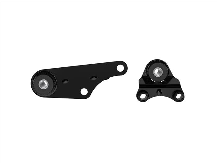

    Update, (Faulty installation)
    Many posts had mentioned the differential drop, which was installed, but it was not installed properly. FML
    I went into the Toyota service center to get additional pictures knowing the truck was being worked on. The service technician informed me differential drop only had one of the two bolts installed and showed there were no indications of any hardware installed; which was the primary of the incident. As of now, the truck is being repaired, under the insurance claim.
    I have spoken with the install shop and informed them I will be looking for a resolution on their end. They have requested the Toyota repair and findings report and intend to inform management.
    I intend to reach out to ICON and request to have the suspension installation inspected by an alternate shop, or ICON directly I live less than a hundred miles away from ICON HQ.

    For those who haven't been following along closely, these are the brackets in question:

    So if the diff drop wasn't bolted up correctly does that mean the diff was just free floating, and that allowed the separation? Just trying to picture it and might need to crawl under my truck.

    There was only one of the two bolts installed, my turning while backing released the diff drop from its intended position; and is the cause of the failure. (to the best of my knowledge at this point)
