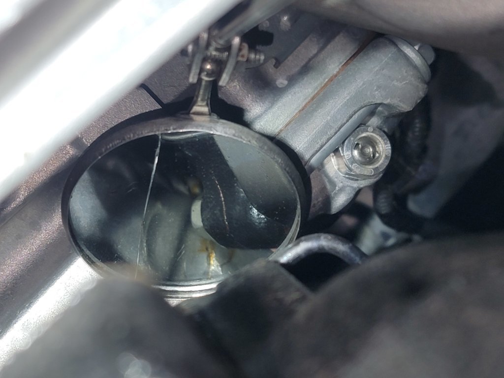

    Cracked on top, not the easiest to see. only knew because of the oil drained out.

    Toyota warrantees their vehicles for what comes from their factories. When major modifications are done, how much can you expect Toyota to cover when things break? The threads on this and other forums are filled with suspension modifications. I guess it would be wise before going down that road (no pun intended) to see if your plans would violate the vehicle's warranty. Or, would your after market parts supplier and installer cover damages such as this? In this case, looks like the aftermarket modification damaged a Toyota part (crankcase). Could have been a lot worse if the damage wasn't immediately discovered. All the oil leaks out and now you need a new engine. Would have been more than $5000, and who would pay?
