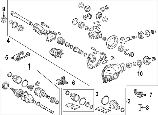

  12. Dec 4, 2024 at 7:43 AM
    #72
    Squeaky Penguin
    Squeaky Penguin Nothing Ventured, Nothing Gained
    Apr 5, 2012
    #76340
    10,082
    Brett
    Steamboat Springs, Colorado
    '01 4WD, SR5, TRD & '13 TRDOR AC
    Lots of dust and custom dents, Check Build
    That joint does just slide apart, and this would be a half hour fix with one new boot for the OP had it not caused other damage.
    The axle still spinning and flopping all around being rotated by the tire is what caused the damage.
    Had OP stopped when he heard that first clunk, it likely would have been fine.
    What would be really interesting is if someone with an Icon coilover put their truck on jackstands, turned it to full lock, and rotated the tire by hand to see how close the tulip joint is to popping out.
    It would be nice if Icon gave you extended length of their coilover so you could compare to other brands.
