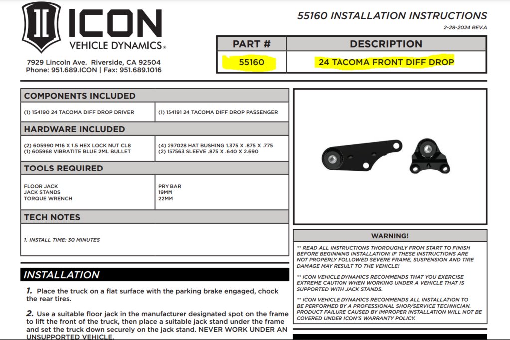

    Wheres OP did he actually install the drop bracket?

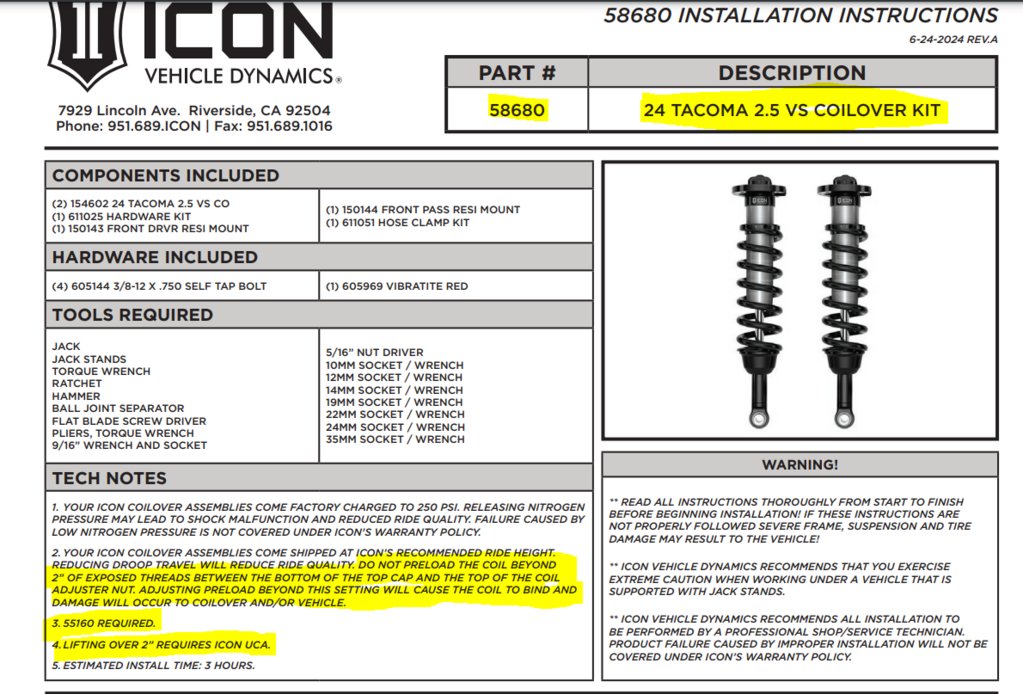

    Who installed your Icon lift kit?
    Is this the Icon kit that was installed on your 24 Taco?

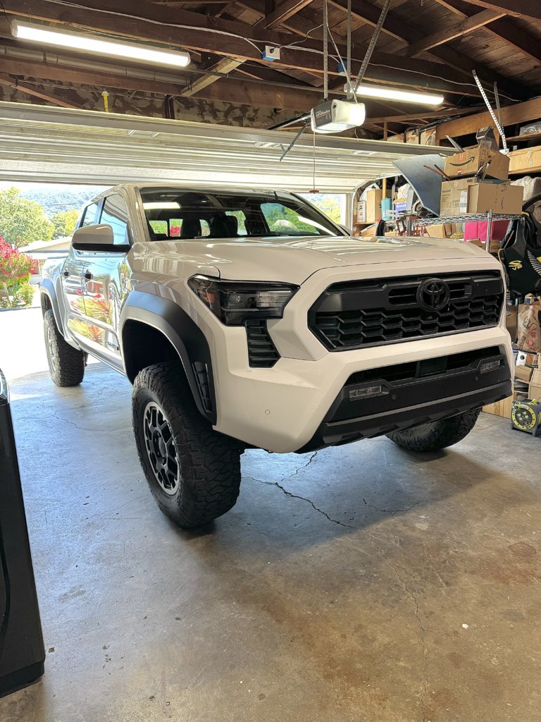

    Icon coilovers for the 4G Tacoma are shipped with way too much lift. I lowered mine considerably. There’s probably less than an inch of threads now to achieve around 2” of lift. Maybe OP has about 3.5+” of lift and didn't even know. Here’s how mine looked after I installed them, before lowering the coilovers

    But did you install the diff drops? That seems to be the missing question that OP has failed to answer.
