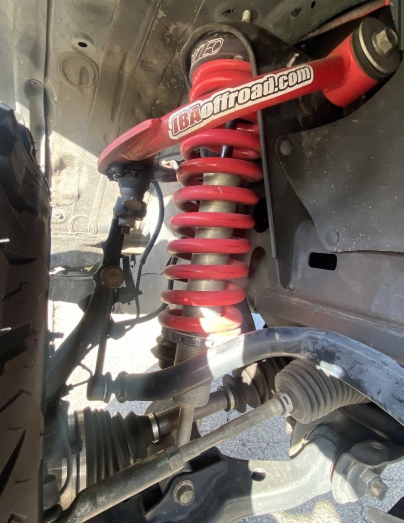

    Are these coils adjustable? I know nothing about suspension. I had it in the shop last week and they told me they couldn’t adjust them. But isn’t that black block at the top a spacer? Is that possible to have removed to drop the ride? Thanks.

    Looks like the bottom collar is where the adjustment Is made on those. Is there a piece on top of that hockey puck, I can't tell from the picture.

    They are adjustable. The collar on the bottom rotates to add or remove spring tension. Youll want to rotate it counter clockwise to remove spring tension/lift. I had that lift when i first started. It sucks in my opinion. Id take a spring compressor to the coil though to make it easier to adjust.

    OP post a picture from the front of your cv angles. Plenty of people on here have 3 inch lifts.

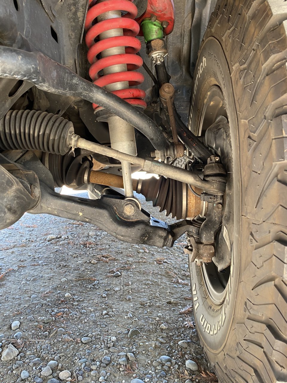

    Found one

    Those boots look terrible. You could cut off the metal clips that hold the small end of the boot in place. Stretch the boot lengthwise so that it is onto the shaft part of the CV and use a big zap or hose clamp to hold it in place. Then the fins won't rub and wear out as quickly.

    Those are adjustable. Threading the collar at the bottom of the spring down will reduce the lift. The black portion at the top of the spring looks to be part of the top hat and not a coil spacer, but I could be wrong, it's a little difficult to tell from the angle of the picture.

    That CV angle is not good, those boots are not going to last long rubbing like that.

    I’ve gone through two sets in about a year. Only put around 5,000 on the truck. It sucks that why I’m trying to find the best solution so the boots last.

    That's pretty high. It looks like you have a spacer lift on top of those coilovers but it's hard to tell. If you do have an extra spacer up top I'd start by removing it.
