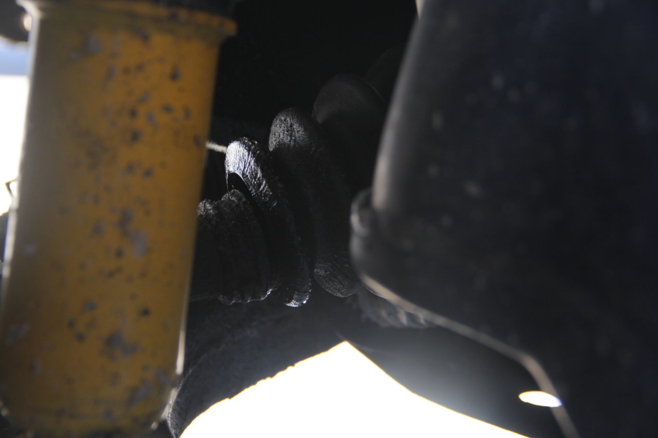

    Need a little help here. I noticed that my inner cv boot was torn and slinged grease everywhere. I wanted to know if i should rebuild these or replace them, Ive heard that the aftermarket CV's are no where near as good as the OEMs so i was leaning towards rebuilding them. Any advice?

    If your OEM cv joints are still good in the axles and only issue is the torn boot, then definitely yes rebuild them. Keep OEM quality and cheaper. Yes, it will take a little bit more time but well worth it IMWO

    Hardcore Rock crashing Yea Go with Toyota .
    I got New Napa ones the kits from Toyota to rebuild my old ones about 3 years ago .
    The Kits sit on the refrigerator still .
    I know myself the truck would still sit on jack stands and I would buy another one

    Replace, less mess, little bit of warranty and move on.
    The joints have been exposed to water for a long time, thats not a new leak.

    Look up CVJ axles, they have rebuilt toyota axles.

    Yeah I came across this during a trip so I dont know how long it has been like that.

    It doesn't help that they SPIN ALL DAY LONG the way these things are designed now...

    I guess ill leave them until next year if i replace them. They're not clicking yet anyway.
