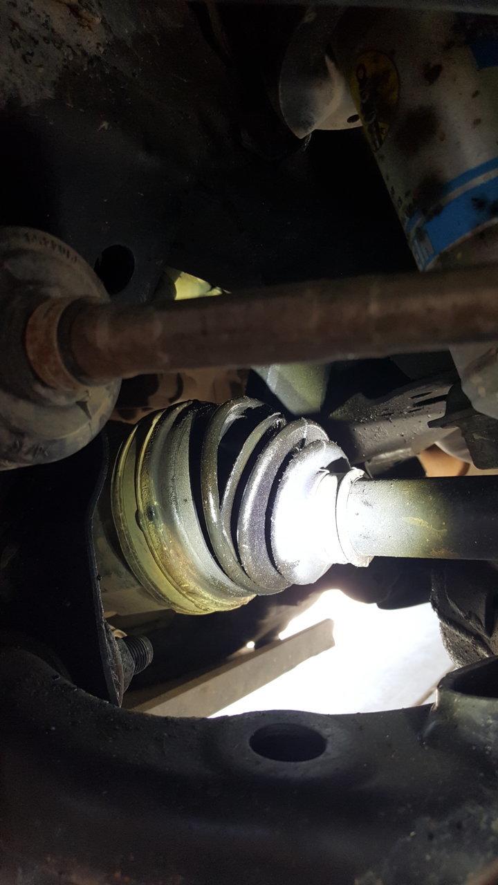

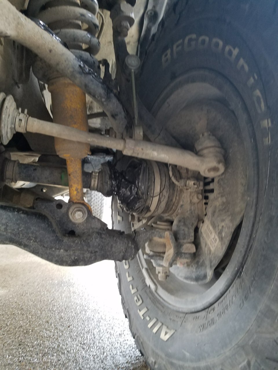

    I've got a 2017 OR and just noticed that my drivers CV has a nice tear in it and has been shooting grease all over. I just got to my families ranch after driving about 1000 miles. My current set up is a little under 3" of lift with TC UCAs, stock lowers and sitting on 285/70/17 with 17x9 wheels.
    I honestly don't know how it tore like that. A month ago it was fine but in that time I did light offroading (fireroads) but did hit some debris that blew onto the road from who knows where. But as a once over things looked okay.
    I was thinking maybe they are at too much of an angle from the suspension and just tore? Or more than likely something caught hold of it?
    But now I ain't going anywhere until I replace it. Where can I get a replacement that isn't going to break the bank and is there a good "how to" for these 3rd gen? Hopefully these pics load. The other side is completely fine.

    Replace the boot. Will cost less than $50. Do not go get a parts store axle.

    A shop installed the lift. I'm also worried what damage may have been caused by driving with that torn open.

    This is true, but all of the part store replacement / reman axles are significantly inferior to the Toyota OEM axles. As much as it will suck, its best for him to pull it apart and put a new boot on.

    It’s extremely easy, just very messy.

    Worth asking, worst they can do is say no. SDHQ sells CV boots that are a bit tougher and cost less than the OEM ones.

    I'm freaking myself out over the angles now..picturing flexing and having them rip all over again. Are those SDHQ boots tough enough to keep my worries at bay?
