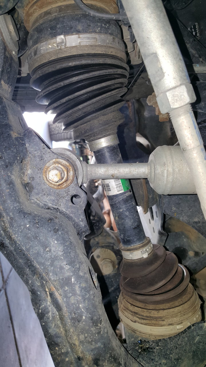

    Here's my other side. Angles bad? I know..I'm a noob

    Its a little steep, I would say 2" is about the max lift height before you start seeing more torn boots. As long as you aren't getting any vibes you can just keep fighting the boot issue.

    it looks like the boot is constantly rubbing on itself, this will cause it to fail. see where the boot is having the dirt removed from where it is making contact?

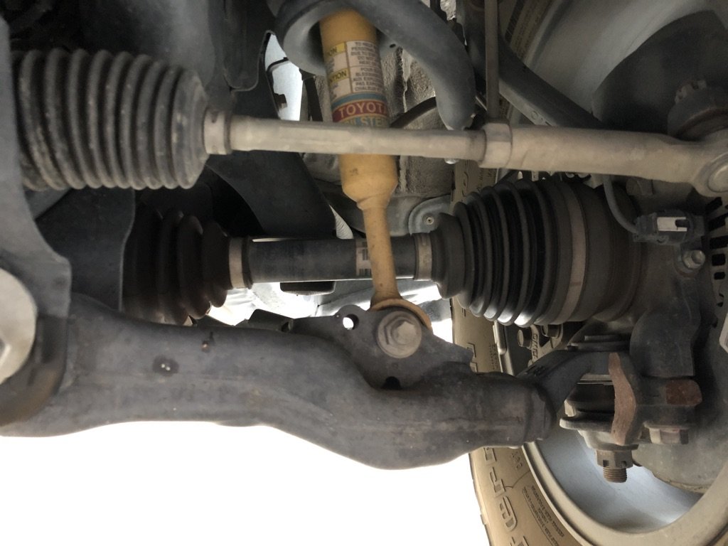

    @Bullrider - here is a shot of the DS CV axle in stock form, for comparative purposes. Notice how the fins are nice a spread out. Anytime they start rubbing on each other, you will chew through boots quickly.
