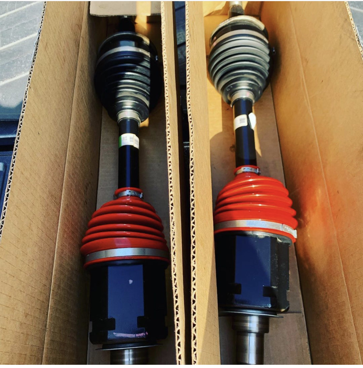

    CVJ axle boots here. No issues yet

    I see an issue. The top right seal, not sure if it’s called that, is bent. Just like how mine came. Had to pull the one off my old axle to replace it.

    these are my oem axles. The only thing I replaced were the boots.
