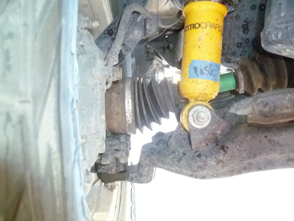

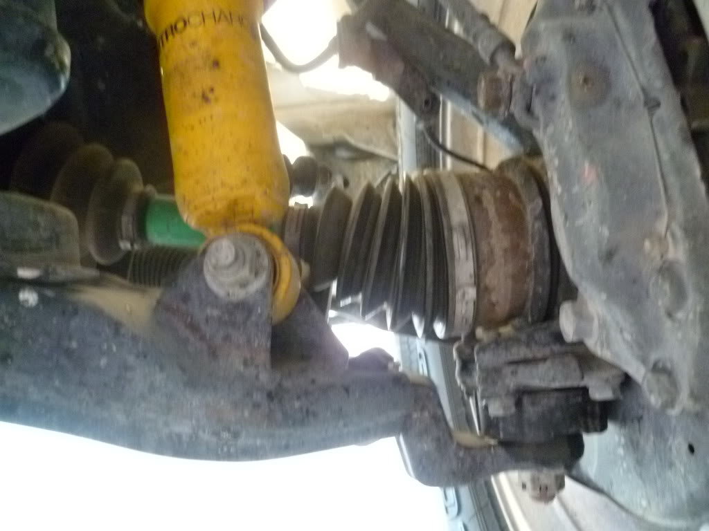

    Something on my passanger side looks wrong. Don't remember it looking like that. I don't know if it was like this when we had the truck up in the air or not. As far as my suspension goes, I have 881's up front which I think give 1.75 - 2" of lift plus I have a diff drop. I installed everything probably like 6 months ago. I don't wheel unless you count the horrible dirt road that I take to work.
  5. Mar 6, 2012 at 7:24 AM
    cmf21
    cmf21 [OP] Well-Known Member
    Sep 4, 2009
    #22288
    233
    Arizona
    04 4x4 dbl cab trd
    Both sides wobble. When we had it up in the air, we had both sides going and they were wobbling pretty bad and the diff was shaking up and down. We had to retighten the bolts as it looked like it caused one to loosen up.

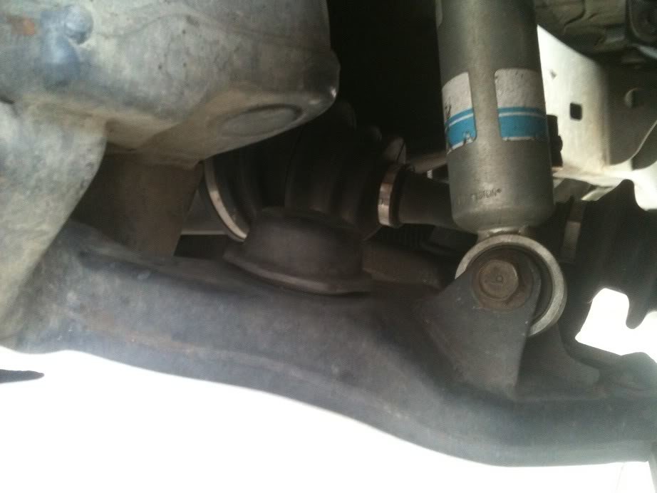

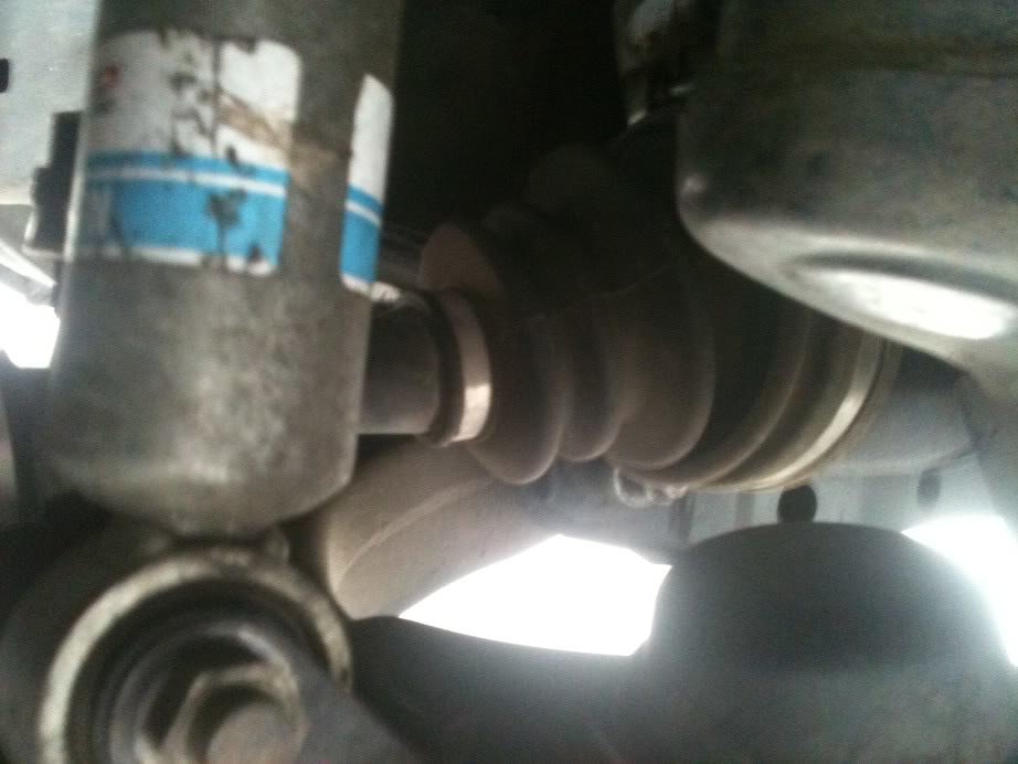

    doesnt look that bad compare to mine. sorry, not the best angle picture i took.
    driver side
    passenger side
