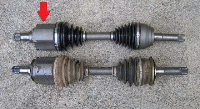

    Hello, I was under my new to me truck today changing the diff and t-case oils and just checking over everything. I grabbed my front axles and shook them and they moved a good amount which makes me wonder. How much play should there be in the front axle? Specifically the inner joint where it goes into the front diff. I had a good amount, roughly a 1/4" up and down. Thanks for the help

    The axles themselves will have play in them. It's the cups that should not move up or down.

    Thanks for the reply. Your talking about where the ends of the half shafts slide into on the front diff correct? Where it goes into the front diff there is the most play. The axles are fine as long as the boots aren't ripped I assume?

    Yes, where the red arrow is. That is what moves up and down?

    I think mines been like that since day 1, you can jiggle it up and down. I was worried at first, but theres no noises when turning or 4wd, and no leaking.

    I also have a growling noise when I turn so wheel bearings need replaced too. I can move the inner cup up and down but no fluid is leaking out

    Play in the CV is normal, it freaked me out and even brought my 13 to the dealer over it for them to document that it's normal. I checked every tacoma they had on the lot while I was there and they all do it aswell. I try not to worry about it.
