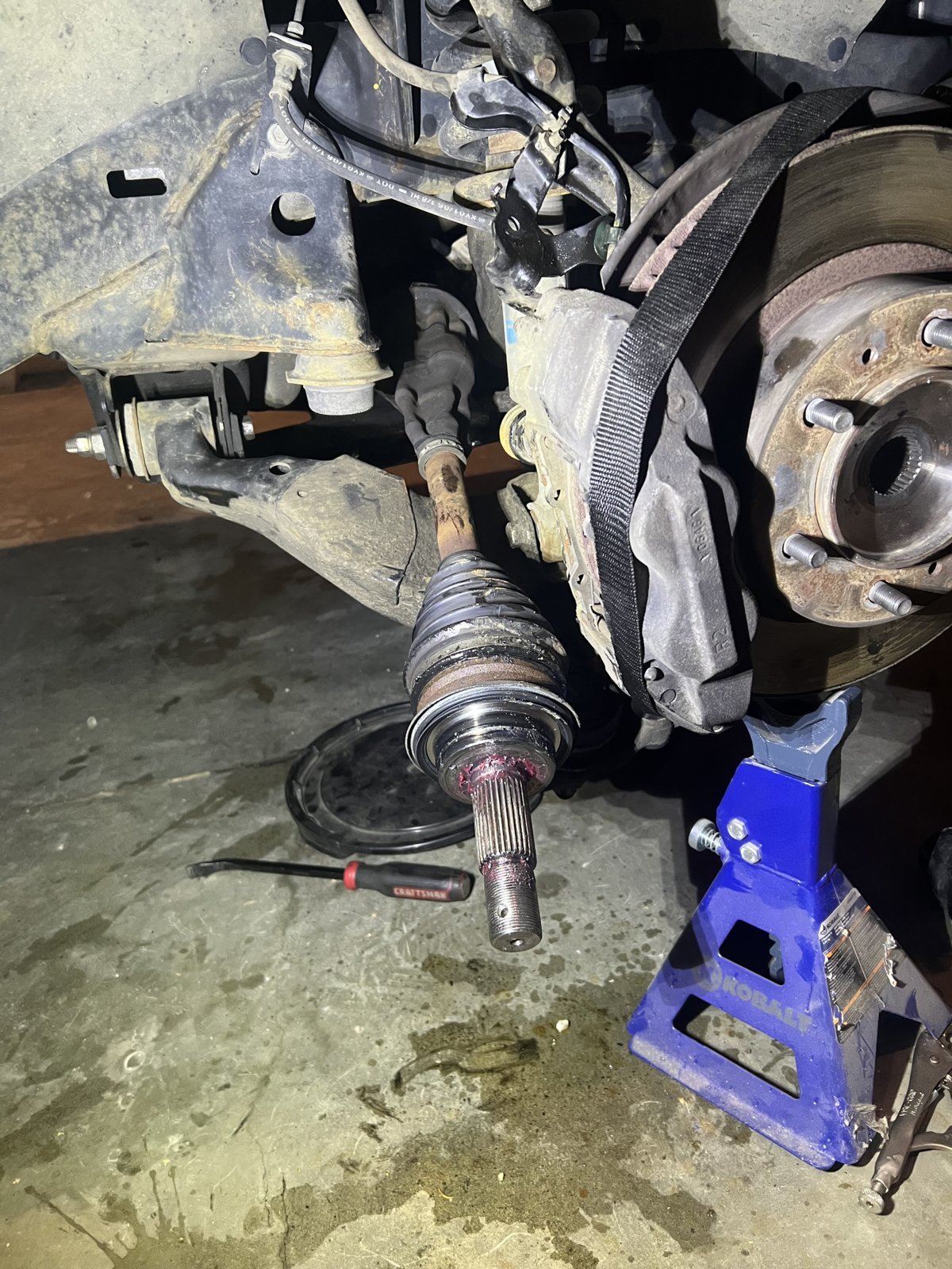

    I put these on both sides after my original boot tore on drivers side around 50K miles. I was doing a overhaul to my front end and figured I'd just replace them both at the same time even though passenger side was in good shape. I had to replace drivers side after 2 years when the boot tore. At the time I blamed it on spilling oil from changing the oil filter. Rock Auto warranties them and I got a replacement. The passenger side just tore at 3.5 years of service. I still had the OEM one I took off that was in decent condition and put that back in. When you look at the axles side by side, OEM is a thicker diameter.
    Any how, long story short is I'm sticking with OEM stuff from here on out. Rock auto used to offer a rebuild service for OEM but I don't see it anymore. CV axles aren't a horrible job but they are always a pain in the butt to get out of the diff. It also gets real expensive if you are paying for labor. I just sent the most recent one back for a refund.

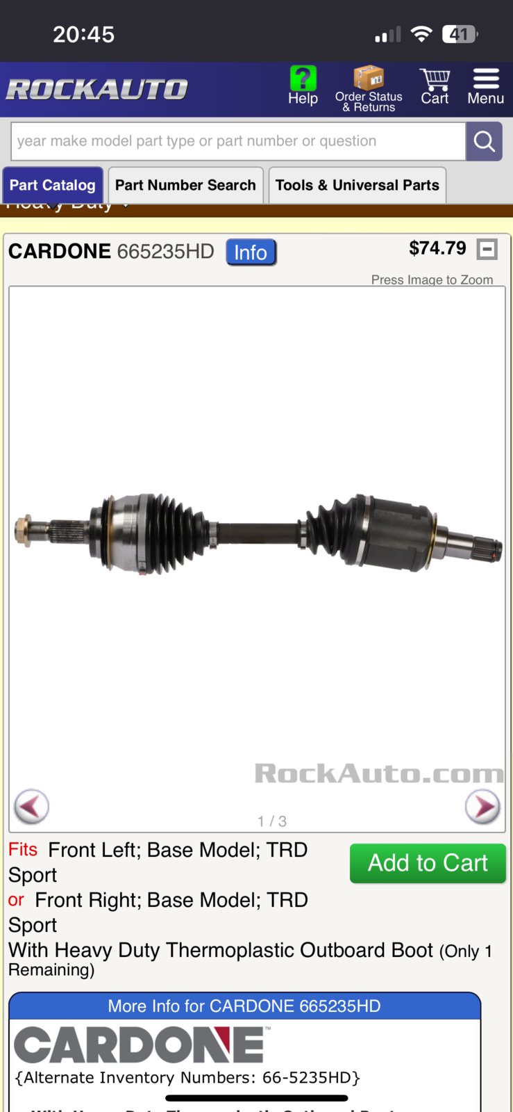

    I will say rockauto does a good job with the warranty on these. No issues with them. The thermoplastic heavy boots on these cardone axles don't seem to be as good. I wish I hadn't gotten rid of my old one that needed a rebuild.
    I've got no experience with the NAPA version, but it sounds like others have had success.

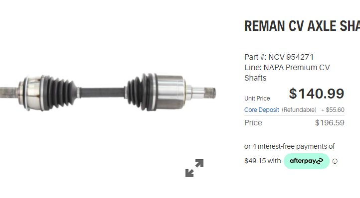

    I do not recommend the NAPA axles. In November 2021 I purchased Part #: NCV 954271. It lasted less than 2 years (likely closer to 1.5) before the boot tore. Meanwhile the Toyota axle on the other side (factory original from what I can tell) tore this month, close to 200k miles on it.
    NAPA did swap the axle out under warranty. The replacement axle was a bit different and didn't have the axle seal guard like the Toyota axles. The warranty is also crappy as it says "the warranty is void if the boot is damaged in any way." The store didn't enforce this, but who knows if they would in the future.
    I saved money by buying a used Toyota axle. Tacoma from 2005 to 2023 use the same cv axles. On eBay junkyards sell Toyota axles (identifiable by the green and white sticker) from wrecked vehicles. I got one from a 2019 tacoma.

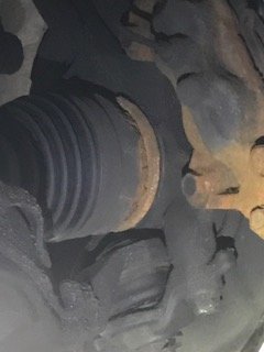

    Was under the truck today and noticed this difference between the the two CV axles. There were no torn or ripped boot. Is this any concern?
