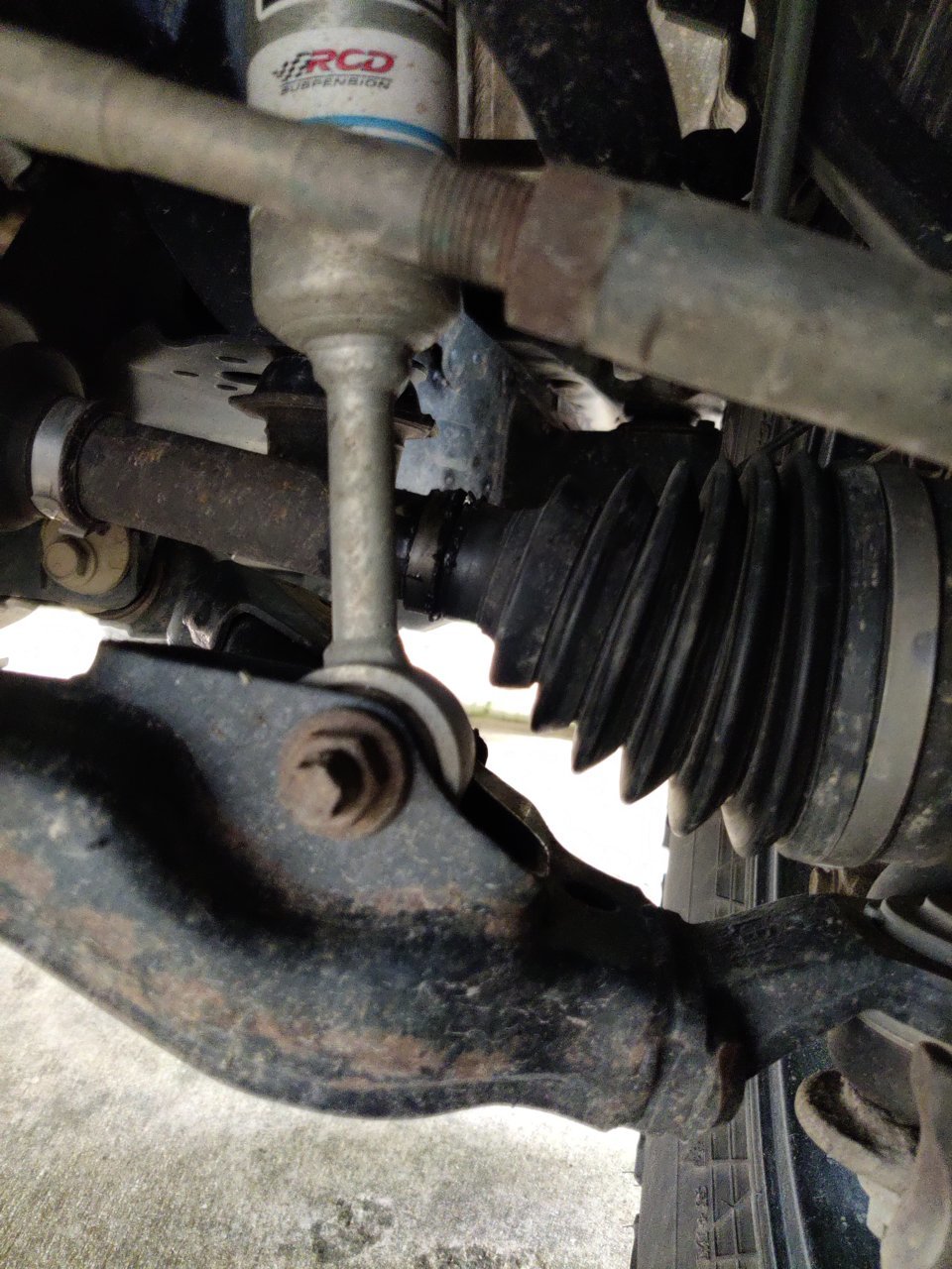

    My driver side outer CV boot clamp keeps coming off after a few short weeks of driving.
    Had my CV boots replaced early April. After a couple weeks the clamp slipped off. Got it replaced, this time made it almost 5 weeks.
    My mechanic was surprised the first time I took it in. He had never seen it happen before and he is an avid offroader. He's a certified Toyota mechanic and only uses Toyota parts.
    Does anyone know what would be causing this or had it happen to them? I don't want to have to reclamp my boot every month.IMG_20210527_145904.jpg

    mine was doing this, make sure that the boot is not overfilled and that its burped, too much air in the boot will push off the band. Also it needs to be clean and grease free where the boot contacts the shaft.

    If I were to “burp” the boot.
    I’d gently pry a small pick or screw driver between the boot and axle.
    Then squeeze some of the air out of the boot.
    I’d also focus on trying to get the axle dry and clean of grease where the clamp is located.
    This might be a bit difficult with the axle in place and together. But I’d still see if I can get it clean.

    @TnShooter thanks for the tip. So I would have to squeeze the air out of the boot then clamp it as I'm squeezing out the air?

    Pretty much. Yes. Just keep you hand squeezing on the boot.
    I’m not totally convinced that’s the problem.
    Have a look at the boot with the wheels fully locked to the stops - Left and Right.
    See if your boot is pulling on the clamp?

    I will try and test that tomorrow. Of course the clamp is currently popped off the boot right now but I could probably devise a way to see if its pulling on it.
    What might that indicate? Is it not normal for a boot to stretch a little, say on a tight turn like you're describing for that test?

    Yes, it’s normal for it to pull.
    But that’s also why the boot is built with the ridges in it too.
    It should pull the ridges out on one side and collapse them on the other.
    It should not pull at the clamp.

    Or push the boot back and give it some more room to stretch.
    Back- as in toward the joint.
    But not too far and cause the boot ridges to rub on themselves and wear out prematurely.
    (This is common on lifted trucks)

    TBH, I personally wouldn’t fool with too much.
    If it keeps popping off and you have plenty of room and it’s not pulling when turning the wheels.
    Then I would go get a stainless steel hose clamp. The screw type. And put it on.
    No, this isn’t the right way to fix the problem. But it’s the easiest way.
    (This is what I’d do. I’m not telling you to do this)
    More than likely someone will say that’s bad advice and wrong.
    Maybe it is, but we’ve done it before. Not on a Tacoma, but it’s definitely been done before.
    And that was the end of that problem.
    Or you can try your best to get it really clean under the boot, and make sure the clamp is set tight.
    To do it right those type clamps on there now, need a special tool to crimp them. And you need to be sure it’s tight.
    I personally don’t have the tool, so I went with what I posted above.
