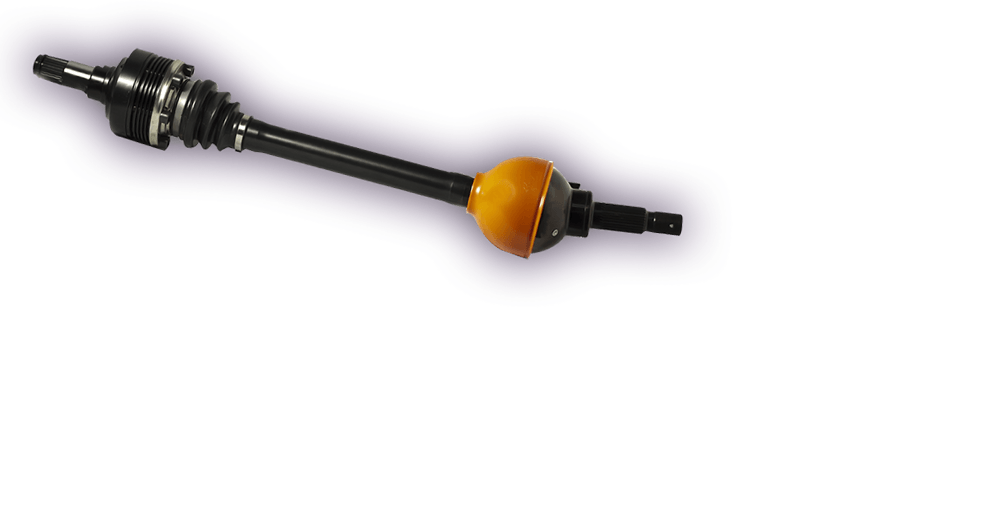

    I realize these shafts are the extreme, But it might be the correct choicefor some.
    Can you do the boot slide "trick" on inner and outer boots?

    To do this for the boot only it would not be worth it. If your popping CV's left and right and keep buying the stock ones Id say yes RCV's are strong as hell and if you were locked in the front it would be a good investment. They would pay for themselves in a few wheeling trips.

    Will they allow for a higher cv angle without issue?

    That's not what they are designed for but they might. They still do have an upper boot and that one rips more then the outer at least on the 1st Gens.

    The inner boot appears to have far less ribs and spaced further apart, That's what makes me think it would handle a greater angle without rubbing. 2nd gen is what I was looking at. I realize that's not it's intended design, but very likely a bonus.

    Yeah i guess if that's what you want to do. You would have solid CV's that's for sure. But $2000.00 bucks to just have more boot clearance I don't know man it seams like a lot of money. Also lifting more then 3" you might get vibes and you would have less down travel.

    First off, I am against the boot slide mod... I know of several guys (including myself) that have done the boot slide mod and it has resulted in the boots tearing prematurely, for various reasons, typically involving the hose clamp used for the mod tearing into the boot after so long. My take on this is that even with the boots rubbing they will last quite a while and it is only $30 for the new cv boot at the dealership and if you have some basic tools, it's not too hard to swap them yourselves.
    2nd, on a 1st gen, I think RCV's are a waste of money... It appears that the stub shaft in the ADD is just as weak as the CV axles. If you go to RCV's you will start breaking that stub shaft all the time instead of CV axles and it is a more expensive part than CV's and a lot harder to swap out than a CV axle. Now like Jerry said, if you aren't popping CV axles left and right then you wouldn't have much to worry about, but that also doesn't really justify buying RCV axles. I know of 3 1st gens now that have broke the stub shaft before a cv axle broke. On 2nd gens I have yet to see someone break a stub shaft though, but you also don't see as many CV failures either.
    Basically Jerry nailed everything on the head though. The more you lift your Tacoma (without a DB) the less downtravel you have. DB's help fix that a little by lowering the suspension components.

    Sorry to be so hateful on this... but if you are just driving on the street or mild offroading and have nothing better to spend $2k on, then go for it. They should do pretty good at not wearing out boots, at least I hope, they do still have one boot on them.
    If you are doing more hardcore offroading break CV's often, then installing these will help you not break CV's anymore, but it now puts all that stress on the next weak link, like I mentioned above on 1st gens that seems to be the ADD stub shaft, on 2nd gens it could be that as well or it could be the ring and pinion. Neither of which are exactly easy trail fixes... At least not as easy as a CV axle is.
    For me, if I had the $2K to spend on them, I would try them out. I have broke 1 CV so far and it was due to binding at full droop while crawling so these might be a good setup for me since they are a lot harder to bind up. From there I would just hope that if I were in that situation again, that my stub shaft and R&P would hold up (I'm on 33's, so I think they would).
