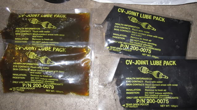

    I have pics. I'll upload what it came with. The kit came with two different grease types. I didnt buy seperate grease

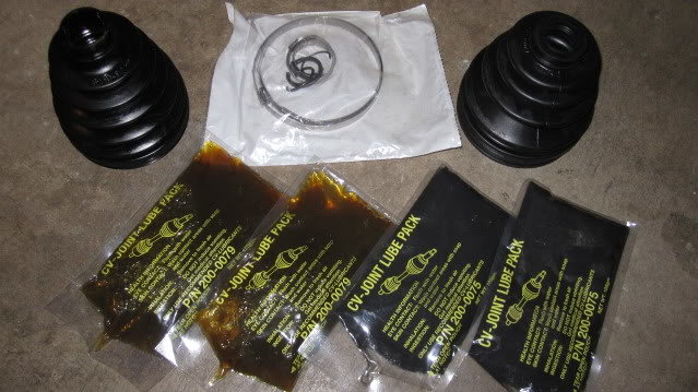

    Here's the kit.
    Here are the two different grease packs. Hmm...
    So is one meant for the inner and one for the outer?

    Ok I found it on TTORA. Black for the outer and brown for the inner.
