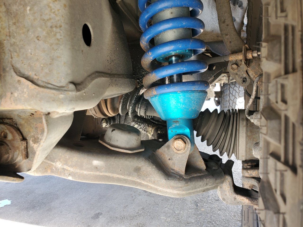

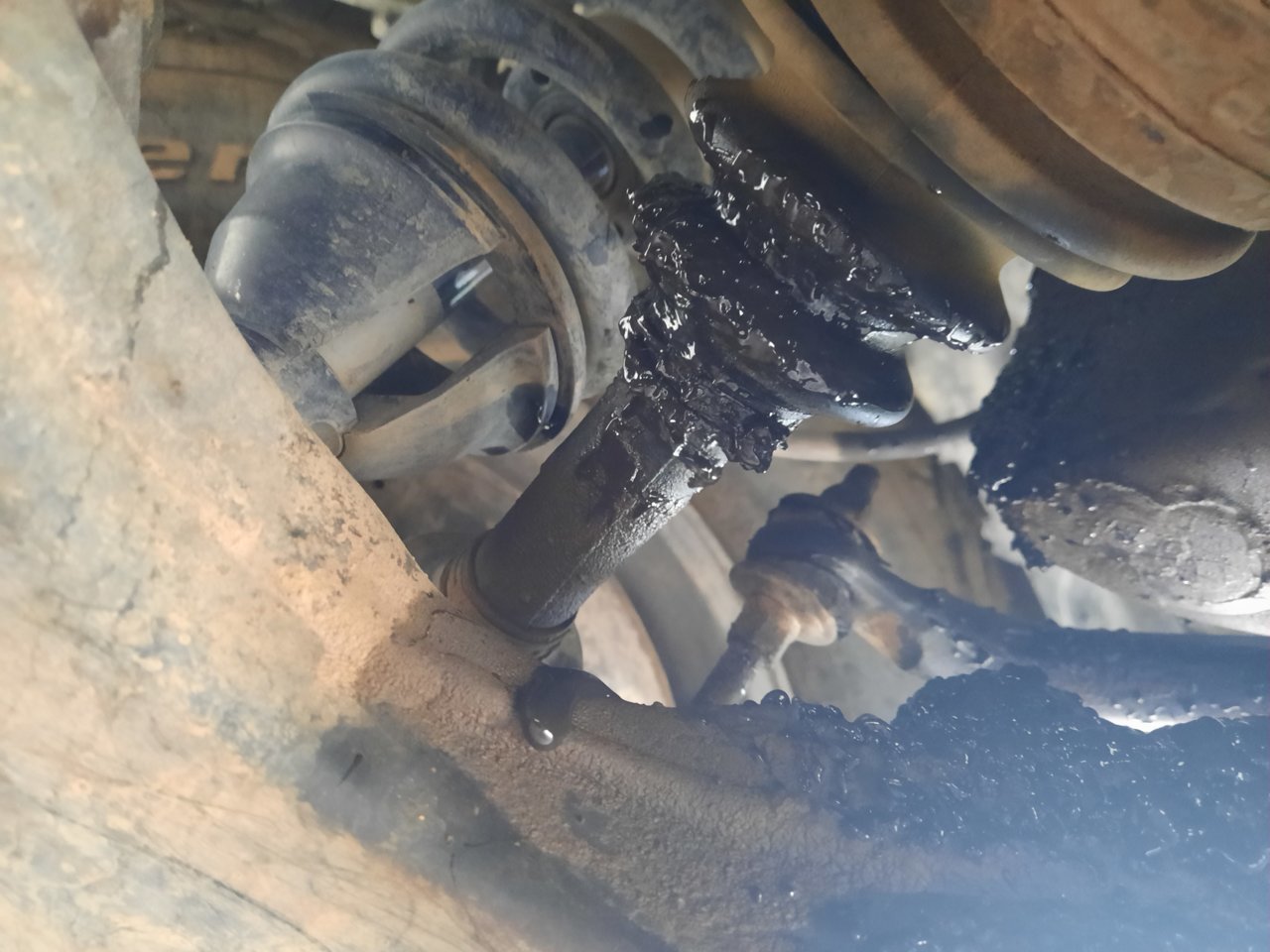

    My front CV boots are slipping and throwing grease. Is there anyway to combat this without messing around with the axle? First 2 pictures are from the passenger side and the 3rd is the driver side20220813_083533.jpg 20220813_083544.jpg 20220813_083553.jpg

    New boot/grease if they're OEM cv axles.
    If you're lifted (which it looks like you are) there are tons of threads on this.
    Some people do a boot slide mod, others use the extended boots (orange colored, google) but generally speaking, the OEM boots are plenty durable.

    What happens is, the boots get old and become brittle over time.
    Keeping them parallel to the ground, means the fins don't find themselves rubbing against one another so they typically last a long time.
    Once you lift it, you've introduced a new variable as now the boot fins do rub, and they quickly tear.
    Several hundreds of threads covering this very scenario.
    New boots are the solution here, but also making sure your lift isn't as high (read severe angles).

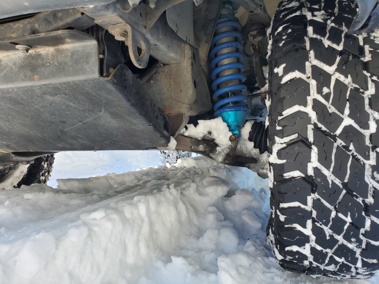

    Here was my rig, and you'll see it looks just like your setup with grease at the ends -
    But really, they were torn boots.
    Though mine's pretty obvious based on my angles.
    I did get rid of some preload (lowered it slightly) to help the rubbing issue. Could also do the cold mod, where you just snow wheel it and get it packed with snow and it freezes over thus sealing it -
