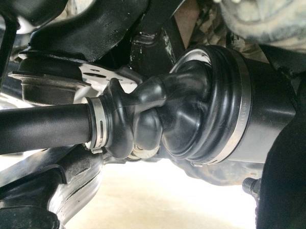

    Just put in a new CV axle yesterday and the boot is killing me. It looks sucked in. How do I fix that? Im thinking of opening the top plug for the transfer case to see if that lets any air in the cv boot and then start pinching the boot to make it form back to normal.

    Loosen the small clamp and allow it to relax .The boot shown it the picture is clamped in the extended position

    ok. I finally found something on the internet right after I posted this. someone said to use a greased basketball needle and push inside to add some air.

    how do I unloosen?

    OK , removing the fill plug on the transfer case will not help .
    Removing the fill plug on the front diff wont help either .The inner plunging joint is solid
    Your best bet is removing the small clamp and allowing the CV boot to relax .As soon as you remove the small clamp , the cv boot will contract back to where you need to re-tighten the clamp .
    If you are carefull ,two standard screwdrivers work to loosen the small clamp

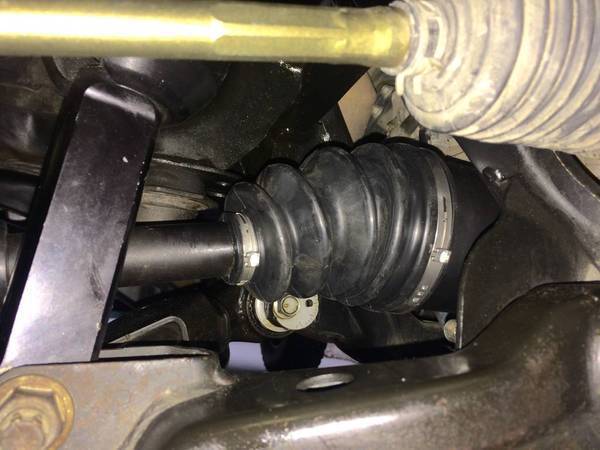

    Well that was easy.

    thanks yea it was fast and easy. was googling earlier and all people were saying is replace, damaged etc. that wasn't the problem.

    Curious, did you loosen the clamp or slide the needle in under the clamp? Was the boot clamped down too far down the shaft?

    Basketball needle. Idk what happened. It was brand new. I just tossed in the axle and it sucked in.
