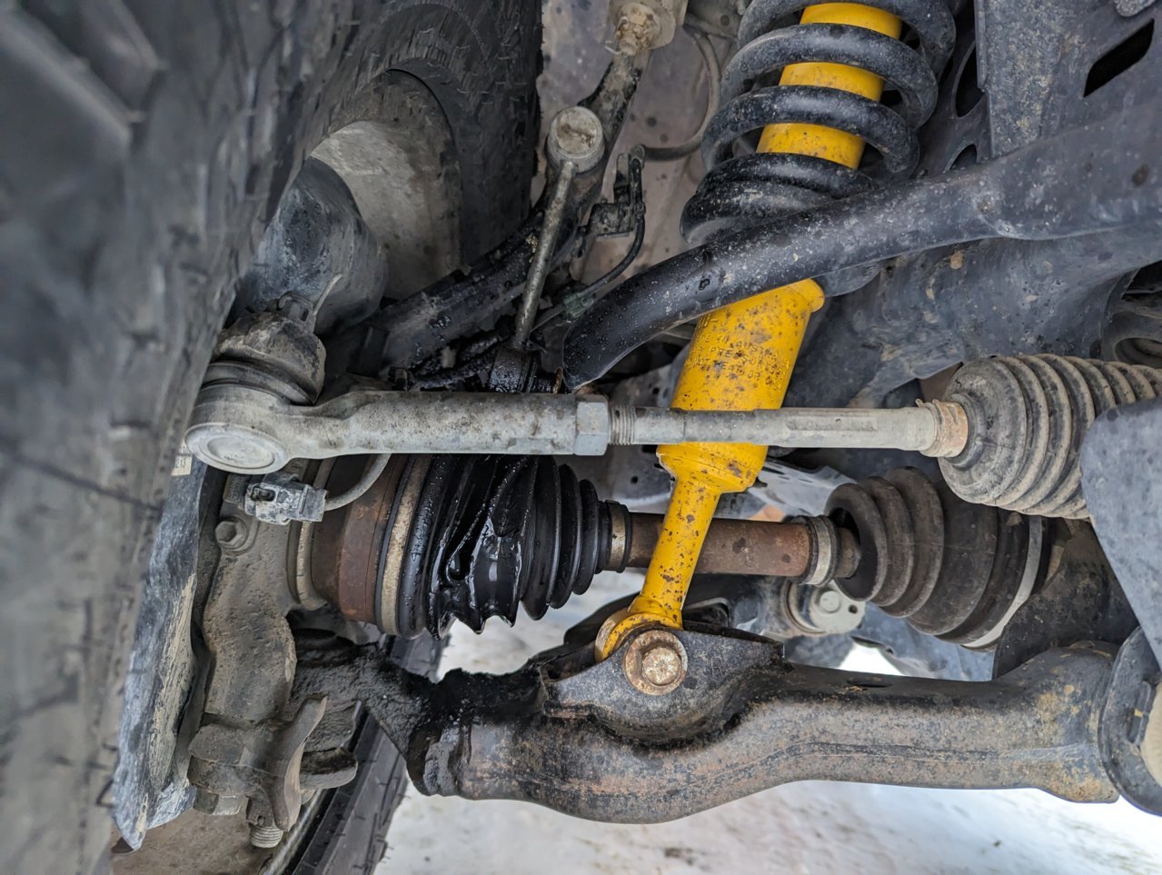

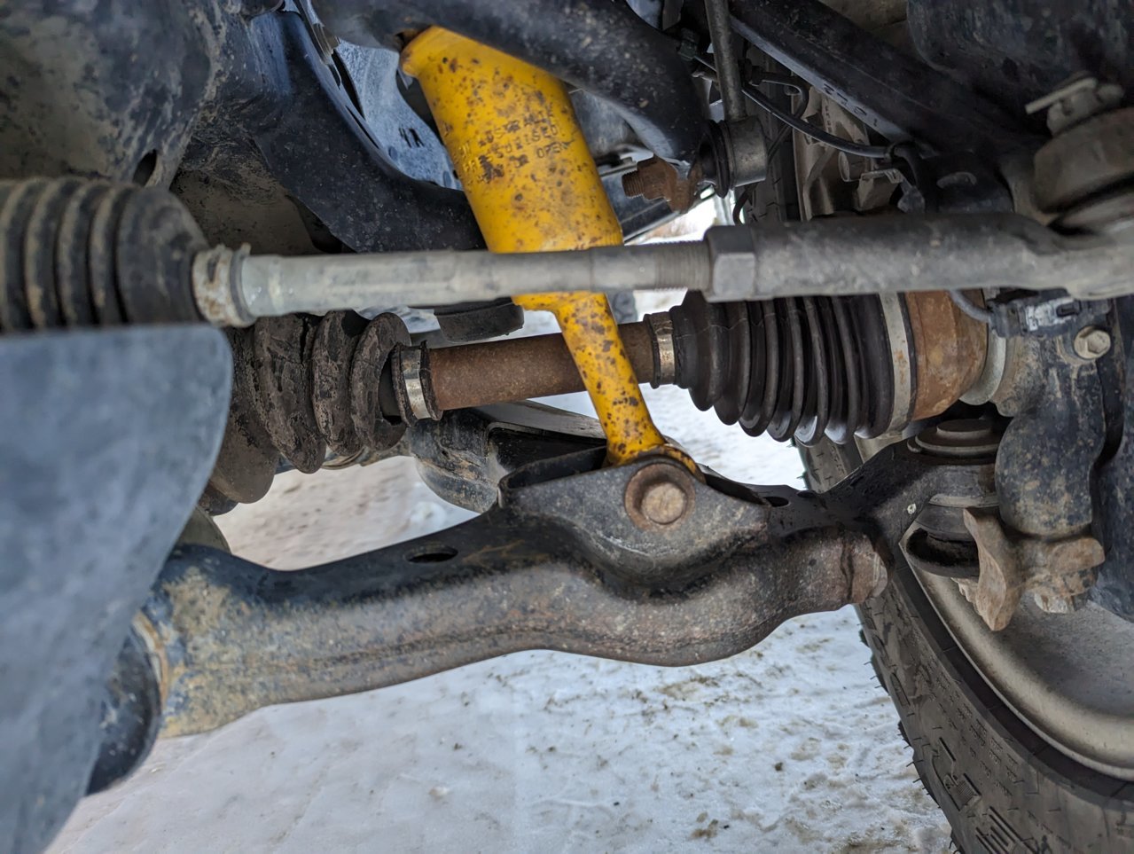

  5. Dec 20, 2022 at 3:15 PM
    Rabby
    Rabby [OP] Well-Known Member
    Jul 18, 2012
    #82937
    104
    2010 Tacoma 4x4
    OME Hvy Kit, ARB Bumper
    Here ar
    Passenger and driver side pics. See anything that jumps out?
  6. Dec 20, 2022 at 4:34 PM
    azzwethinkweiz
    azzwethinkweiz Well-Known Member
    Sep 6, 2016
    #196623
    974
    Tucson, AZ
    2013 4x4 DCSB V6 6-Spd, TRD OR, Tow Package
    I will say that your inner and outer boots are closer together than mine are. However a lot of people on here will make theirs like this to help prevent the "folds"(?) of the boot rubbing together and tearing this way. I keep my boots a little further apart than yours and both my inner boots lasted about 5 years before they wore through with contact on themselves and tore... my cv angles I would say are worse than yours as well... if your boots are OEM I'm not sure why they would be going to shit so fast.

  7. Dec 20, 2022 at 6:53 PM
    6 gearT444E
    6 gearT444E Certified Electron Pusher
    Feb 3, 2018
    #243372
    7,798
    Deep South
    Herculiner Hootus
    Your shock bolts are backwards, now that isn’t what’s causing the tearing just something I noticed. Looks to me like the one is really dry rubber and the axle shafts are rusty. Maybe tread the rubber with some 303 or equivalent; your undercarriage looks like it’s seen some harsh conditions.

  11. Dec 20, 2022 at 9:20 PM
    agent4573
    agent4573 Well-Known Member
    May 5, 2022
    #396561
    122
    2015 Xtra cab, TRD O/R
    None yet
    On the long travel buggies we used to run, we got rid of the metal band clamps on the axle and used zip ties that were just barely tight enough to keep the grease in. This allowed the axle side of the boot to slide on the axle and find it's own happy spot where the folds weren't too tight or being pulled apart. It might be worth a try sanding the rust off the axles and going looser on those clamps.

  19. Dec 21, 2022 at 9:41 AM
    #19
    wilcam47
    wilcam47 Keep on keeping on!
    Jan 27, 2016
    #176243
    54,938
    Will
    Bourbon state
    @Rabby
    Are they replacing the CV or just the boot? The boots look too far extended. Cv angle looks normal. Something isnt right if its blowing boots
