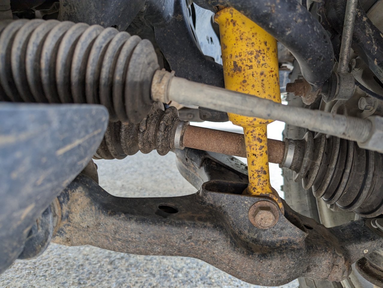

  17. Jun 12, 2023 at 10:29 AM
    #37
    Rabby
    Rabby [OP] Well-Known Member
    Jul 18, 2012
    #82937
    104
    2010 Tacoma 4x4
    OME Hvy Kit, ARB Bumper
    CV_Pass.jpg CV_Drive.jpg Continued....
    I had a pow wow with my mechanics and we settled on full warranty for the CV's from the beginning of this thread, so no out of pocket for me on this test. They used Napa's and after 4k miles. They are already cracking in the same spots.
    So once again, I would ask if any one can see an issue with angles or anything jump out at them. Again I am running a OME Hvy for my ARB bumper and nothing else.
    Thanks for any input

    I’ve been through this. Got CVJ remanned axles with the red silicon inner boots…they ripped after a couple years and they are not inexpensive. I would honestly just get a couple of these https://parts.frontiertoyota.com/oe...axle-2005-2015-tacoma-4wd-434300407084?c=az0x put them in and as Ricardo said “call it a day”. Stay away from that NAPA & Auto Zone Crap. Cheap parts that fail soon after you install them. Waste of time, money, & labor.

    My boots both tore on the inner, the passenger side first and a few weeks later my driver side both on mild fire roads to dispersed camping. I have e rated wildpeaks in 265 70 17 with a 2.75 bilstein lift. Used the oem rebuild kit on both sides and my mileage is 85k miles will report back

    Holy shit you’ve been replacing the entire axle when boots tear??? :eek: I know it’s a pain in the ass, but just reboot them when they tear. As for why the keep tearing? I’m not entirely sure. But I am sure you could be saving loads of money just replacing the boots. Try the CVJ long travel boots, I think they’re orange in color, I’ve heard good things about those.
