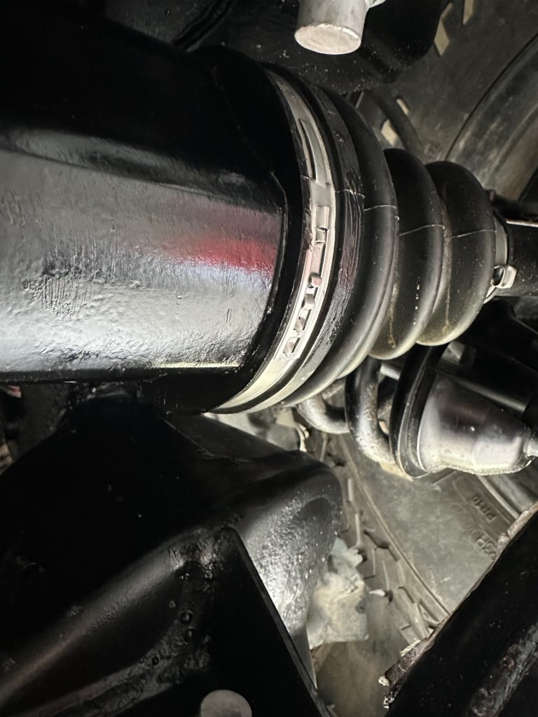

    Hey everyone.
    I just finished up doing some cv boots and everything went well.
    However, the oem Toyota boot kit comes with 2 completely different cv boot clamps.
    The outer boot was not an issue, but the clamp on the inner boot... I'm embarrassed to say I have no idea what tool clamps that.
    I had another clamp laying around I used, but I'd really like the use the oem one since it's a bit wider.
    Anyone know what crimp tool I'm looking at for that one?
    Crazy Toyota used different style clamps on the same kit.
    Thanks!
    Edit: looks like the clamps im talking about are the "earless" style ones.
    All is good I think I've got it covered now :)

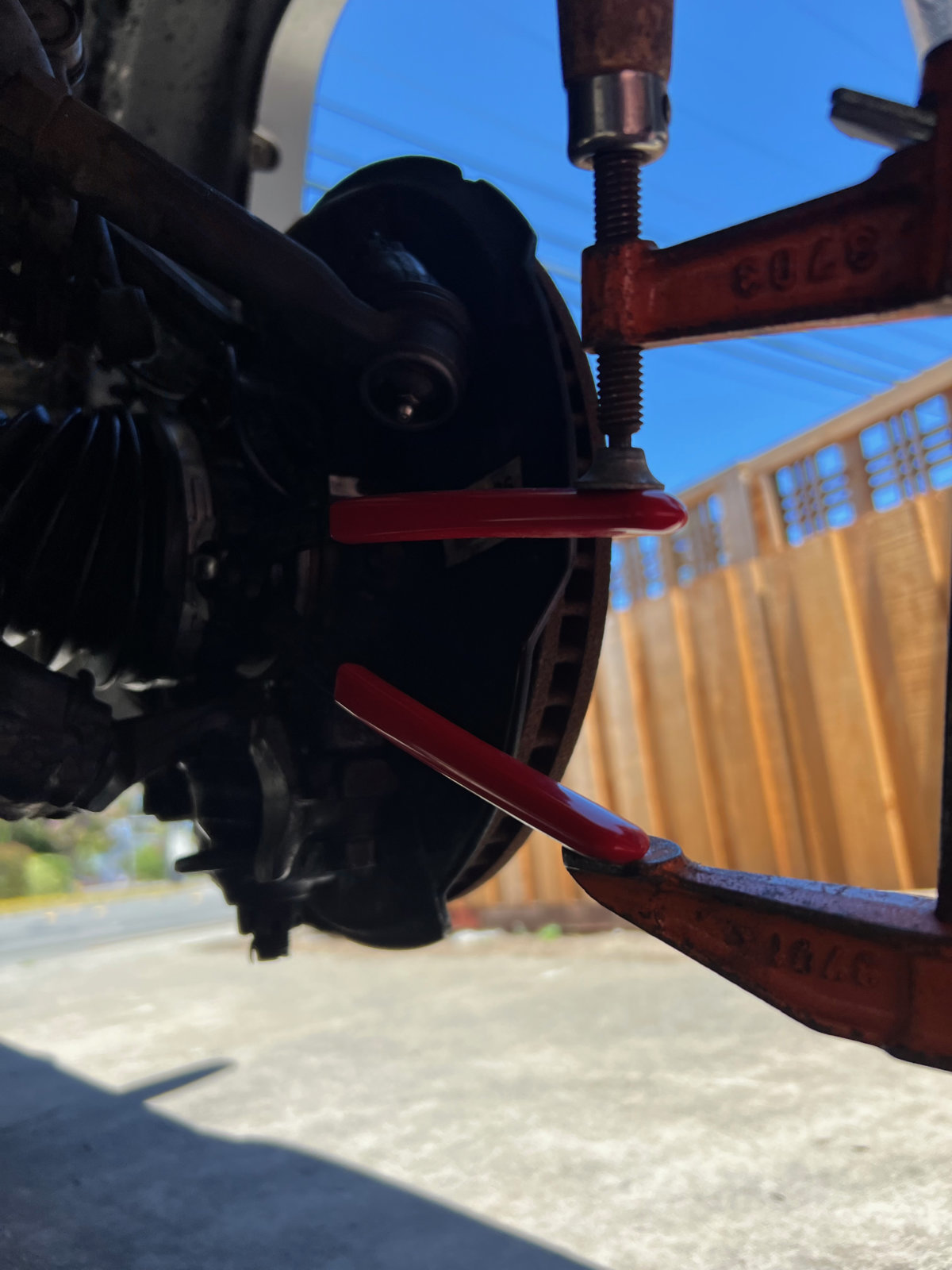

    I highly recommend using this instead of the one that requires 2 breaker bars. Mechanical advantage > my physical strength
    Naveronski, pp2small, jdg and 4 others like this.

    I agree! I have the same one :)
    What I didn't have yesterday when I was doing the job is that other style for the "earless" ones

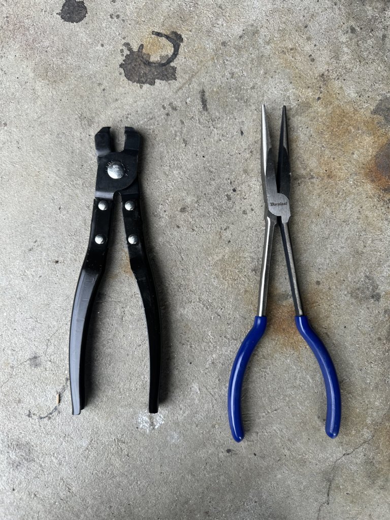

    Oh yea, I have had to do this:
    Bobzilla2020 and Rob MacRuger like this.

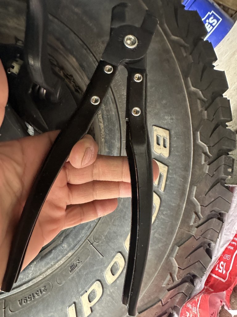

    All the time!!!
    Don’t use anything but the Lexus and Toyota crimping tool! The other one is a joke I broke 2 of them and couldn’t even start to crimp the stainless steel boot clamp. The real crimper does it easy, regardless of the clamp!IMG_3093.jpg IMG_2998.jpg

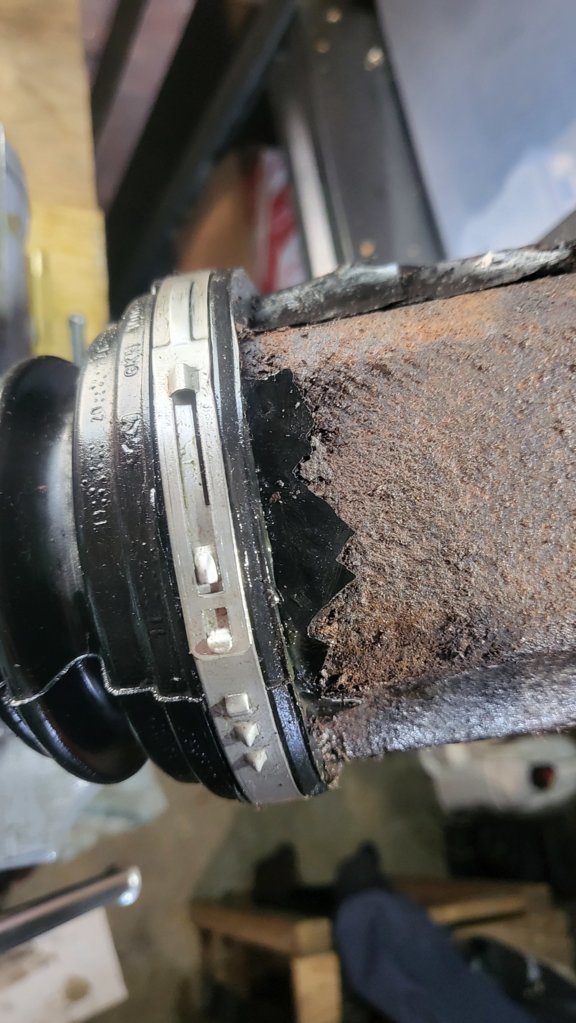

    Is this what you used for the large band on the inner boot? I've got zip ties on mine now and need to get the bands on, it's definitely letting some grease past the boot.

    To answer myself for anyone who may come through this thread for answers to this question…needle nose pliers DO NOT work on the large inner boot band clamp provided by Toyota. They flex too much and the handles will touch before you are able to catch the last barb. There’s no in-between…the way the barbs and corresponding ‘holes’ mate, you can’t use the first barb by itself.
    What I got were ‘Lisle 30500 Boot Clamp Pliers’. After struggling with long needle nose and seriously wondering if the bands were the wrong size from Toyota, I took a leap and got the right tool. You don’t need the OTC. Why it’s 35 bucks is beyond me…maybe the vinyl coated grips? The Lisle is made in the USA and made closing these clamps an absolute cake walk. You should buy the Lisle over the OTC on principle alone.
    Don’t fart around with other ‘tools’, and you don’t need to buy other bands to substitute what Toyota provides in the boot kit already. Just get the right tool. It’s 23 bucks. Barely more than the needle nose crappers I bought at Autozone. https://www.amazon.com/Lisle-30500-...52d10ea59a93fd95c87b5b4&qid=1747495345&sr=8-1
