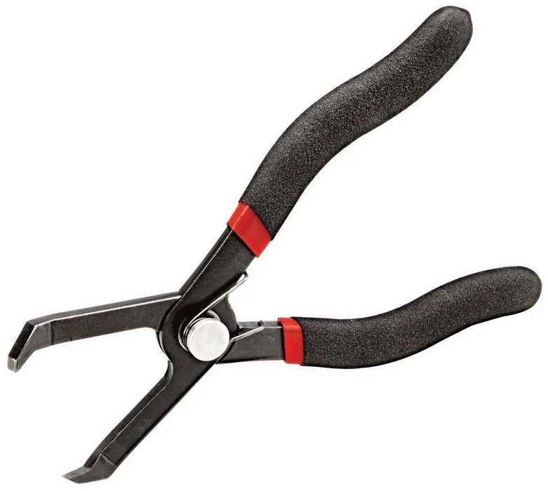

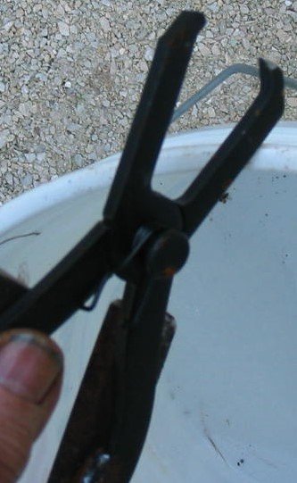

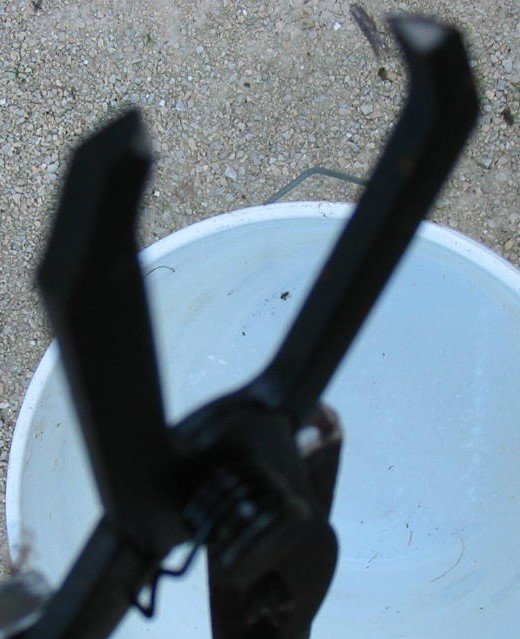

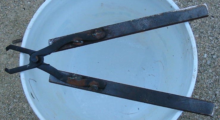

    tacoma303 found this tool, when modified it works perfect. I tack welded 1/4"x1"x11" long steel bars on the handles. the points need to be ground to almost a point. The bars need to be spaced 6" apart and only tack weld as shown and where shown or you will mess up the temper of the steel in the HF tool. No struggling and it works perfect! 1.jpg 2.jpg 3.jpg HF push pin pliers 63700, 67400.png
