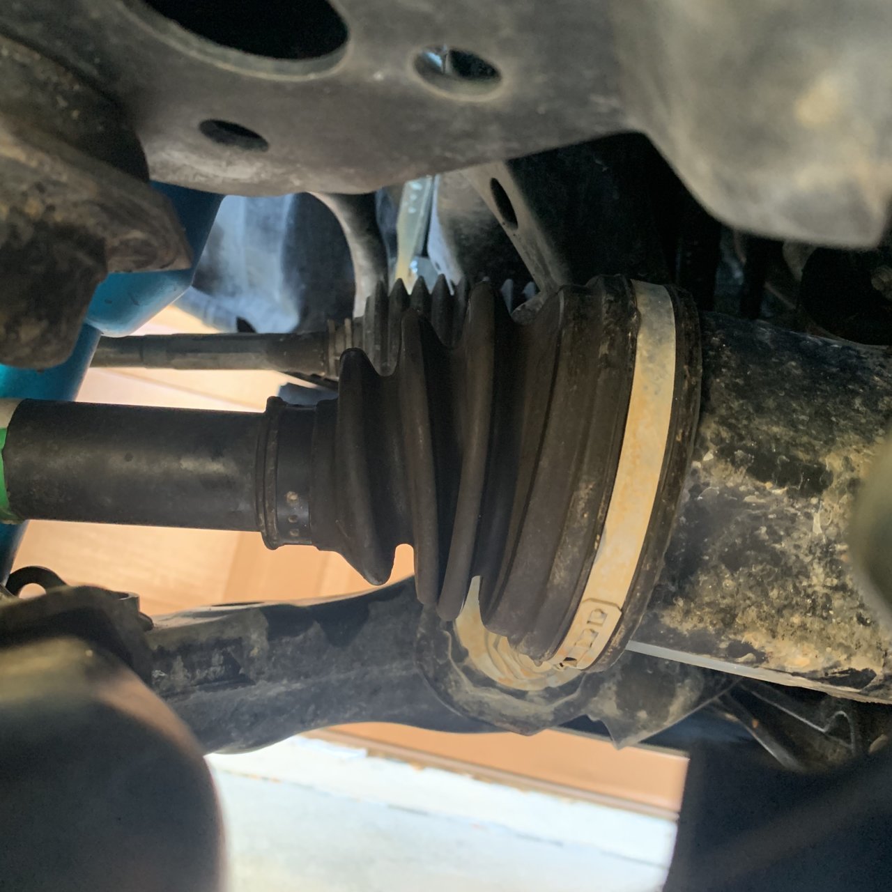

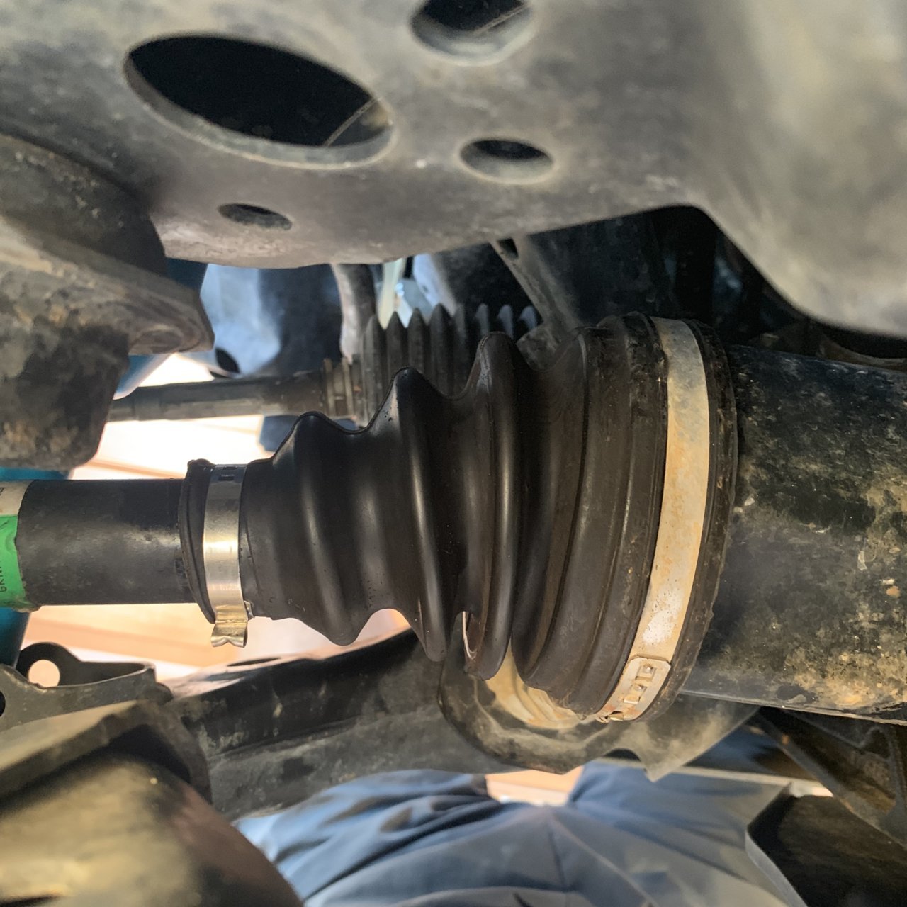

    Before and after, slid them about 3/4 inch and it’s no longer rubbing on 2-3/4”ish lift
    ejewels[OP] and 13txtaco like this.

    Cut clamp, slide boot, new clamp

    I wouldn’t stretch those boots out too much, when the suspension extends so do those shafts and that’s how they tear
