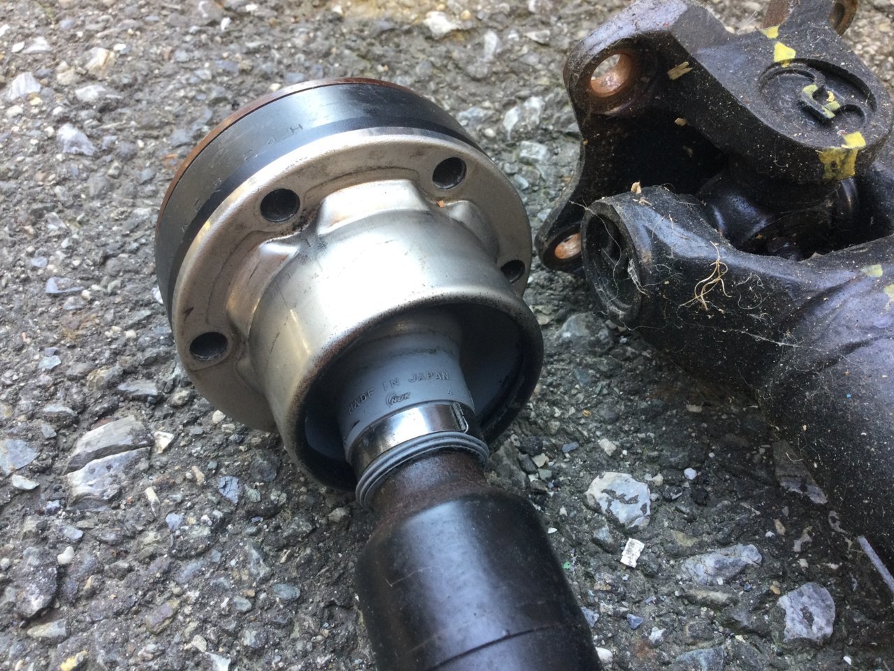

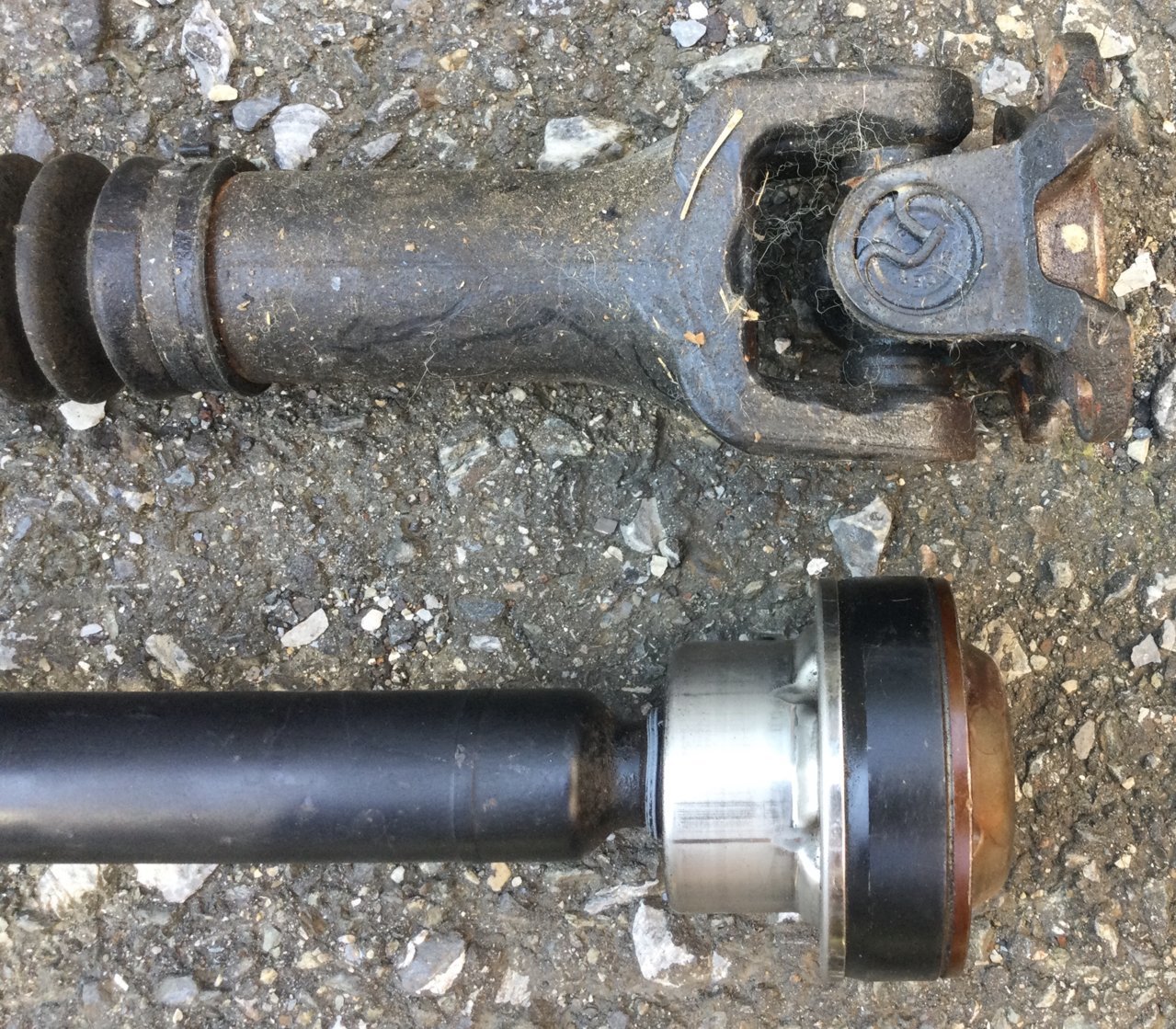

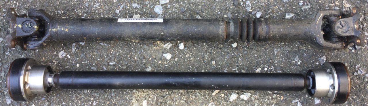

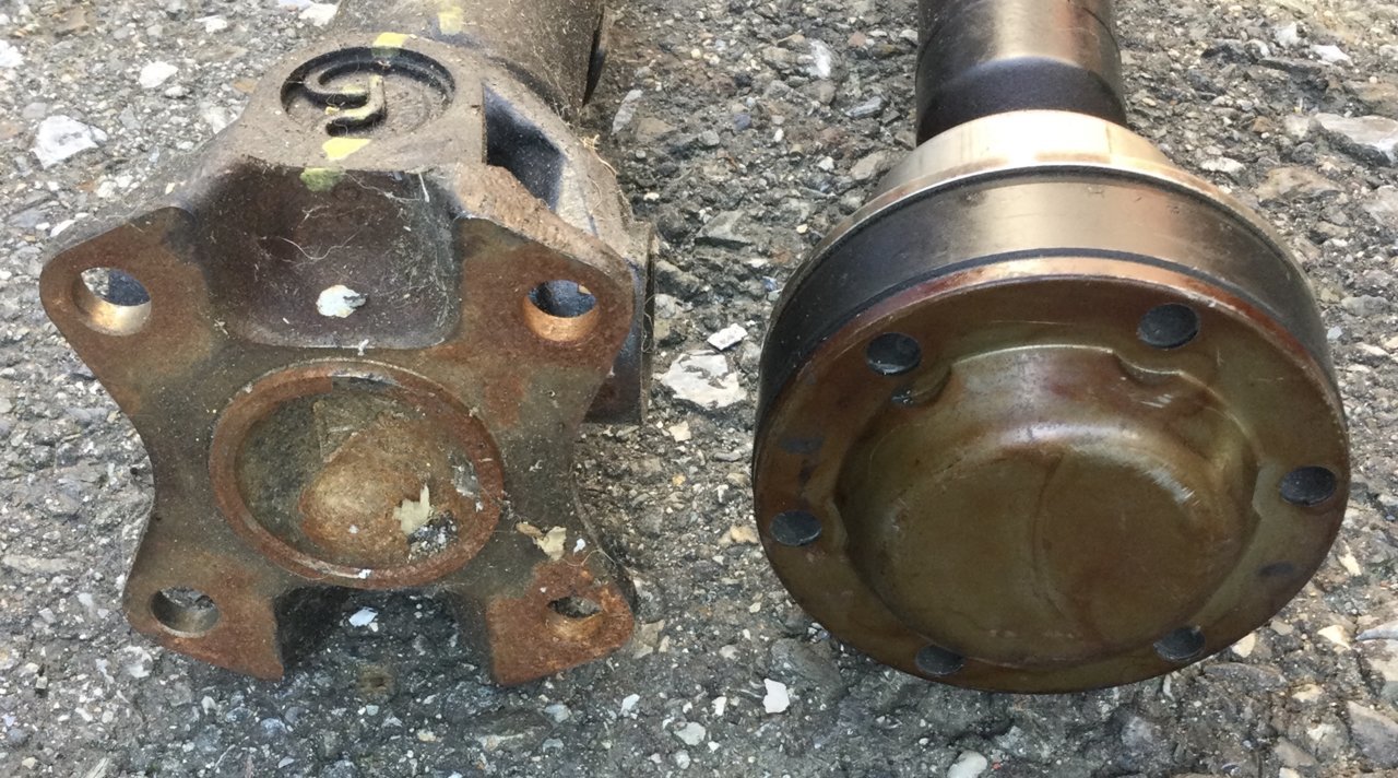

    A couple of years back, curiosity led me to purchase the front CV Joint drive shaft from an AWD Lexus LS 460. It uses NTN Japan HLJ95 Series CV Joints. Interestingly, the shaft is very close in length to the Taco front, and thoughts of adapting it to my truck have occurred…. But just the front at this point. I’m game to look at the rear and start spit balling. I can snap some pics of the shafts tomorrow if there’s interest.

    Pics please

    sicki[OP] likes this.
  12. Aug 6, 2023 at 7:50 AM

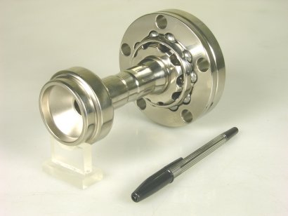

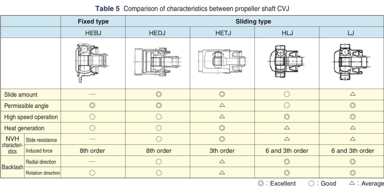

    If you really want to go down the rabbit hole, NTN supplies some great info in the tech papers. Their industrial division has engineering data in the catalogs. It’s fairly easy to suss out why the manufacturers use what they do… and apply it to our trucks.
    0648AB50-BE4E-4D0A-B834-B38CC63A2B7C.jpgNow we just need a good aftermarket source. I’ll take some of these ultra efficient 10 ball NTN units.

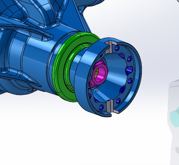

    1,993
    so all we need are a couple 4 bolt adaptors and change the shaft length right?

    Potentially. I almost feel it'd be easier to make a new pinion flange with splines to accept the driveshaft than adapt the driveshaft to fit the pinion but, I'm not an engineer or machinist

    To use the LS460 shaft? Yes, most likely. Definitely want to make sure the joints have enough movement on the slip plane.
    Adapters will cost less.
