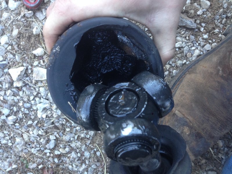

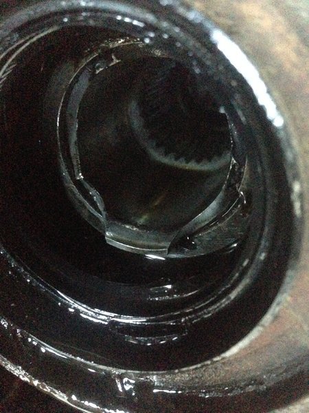

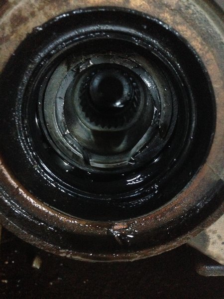

    Okay, got it all apart and the cv shaft fell in 2 pieces and the diff has chunks taken out of that bushing. Is that a serviceable part?
