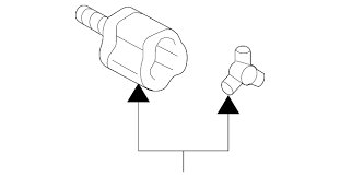

    Toyota part number 43040-04010, looks like they do sell just the cv joint end of the shaft. Weird. I've never noticed the individual ends for sale.

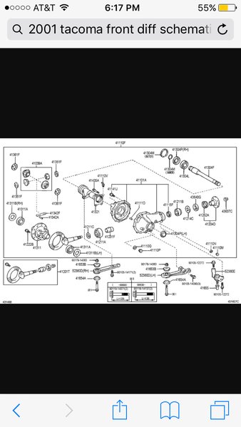

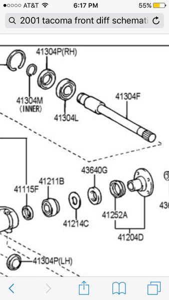

    Ok. It's on the passenger side and in the schematic I looked up it appears the axle stub that goes between the carrier and cv shaft would have that part in it. 41304f

    Passenger side? Why didn't you say that before? changes everything! Just joking and yes that looks like the part.

    Sorry I should've said that before! And sweet. Replacement diff was ~$550 and if I can get out of this with just the stub it's ~$100. Still no idea why it blew out of the diff. Might try putting some limiting straps on it. Never thought I'd be cool enough for those :oldglory:
